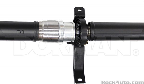

Ok, please be gentle guys. Im well aware it's a dodge journey but I really would like to replace the whole driveshaft/propeller shaft everything. Dodge uses these funky connectors instead of regular u joints right? Can I change out that whole thing and use universal joints? What kind of hook up does the original use that goes into the ptu and coupler? And could i slide any universal shafts into ptu and coupler? Sorry if I'm sounding stupid I got plans for this car and want to do everything right
Why. It’s a simple  maint free part time system.  You cant  add any performance modifying it. It’s a balanced high speed turning driveshaft  assembly with sealed connections and a single hangar bearing. My wife’s  is still functioning at 225k kilometres or 140k miles and hasn’t been touched.  Very pricy to replace if it does go, oem is around $600 I believe.
My Jeep’s with double cardigan and ujoints, multiple grease fittings needed way more maint,  but they were designed for continuous use and had a lot more torque on them.
The Journey system is simple and fairly reliable if you keep a close eye on the oil level in the ptu and rear diff systems. Run them out of oil from a lip seal leak and you have a very expensive repair.

I think it’s either Borg Warner or Getrag designed system; decent oem suppliers for years.
Sometimes there are weak links for reliability on a vehicle that deserve updating. But even F150:trucks are using one piece unserviceable driveshafts units on some models. It’s the direction automotive has been moving for a while; throwaway not rebuildable.
If you were going to go off road a bit and wanted a switchable a system that stayed in awd for a period of time. It would necessitate large changes to the factory system. A custom 4x4 builder could for a ton of money probably do something.
But the driveshaft shaft and transfer cases  are really tucked in underneath, a major lift and would also be needed.
Switching vehicles a better option imo.
Thanks for the replies guys. I guess I had it in my head that the system was weak, but that makes me feel a little better as I do go a little off roading, nothing serious. I'm big on custom and different out of the box vehicles. Like if you want to go fast should bought a mustang, but in the year 2022 is there any way that a mustang can be custom? Like no body i feel like can have a unique one and that's what I'm trying to go for. Im lucky, no kids and fairly high paying job so little money to burn. I did pretty much all bolt on stuff for engine and wanted to lose a little weight and some other stuff before engine internals. I keep up on the maintenance, but do want to get better suspension, mine has a lot of the creaks and squeaks that plague a lot of journeys. So final conclusion is leave it alone until something breaks and I'm ok with that. Thanks again for the replies I really do appreciate it.
