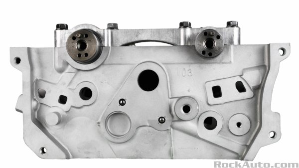

KJ4JOA Posted July 24, 2022 Report Share Posted July 24, 2022 Hi all, 2012 Journey, 2.4L DOHC Took the head in for some machine shop work. I hadn't removed the VVTs from the head. The head was returned to me with a box of small parts; the cam sensors and both VVTs. 1. How do I identify which VVT is intake and exhaust? 2 At the front of the head is an aluminum piece that goes across both cams. What is the technical name for this part and is it a dealer-only item? Quote Link to comment Share on other sites More sharing options...
John/Horace Posted July 25, 2022 Report Share Posted July 25, 2022 Is this the piece. Quote Link to comment Share on other sites More sharing options...
John/Horace Posted July 25, 2022 Report Share Posted July 25, 2022 This is pic of exhaust, plug is at 90 degree angle. Intake comes straight from top. Quote Link to comment Share on other sites More sharing options...
KJ4JOA Posted July 25, 2022 Author Report Share Posted July 25, 2022 Yes to the "is this the part" question. Top piece with the 4 bolts in it. Got the VVTs installed correctly, thanks. Just had to make sure. Quote Link to comment Share on other sites More sharing options...
John/Horace Posted August 2, 2022 Report Share Posted August 2, 2022 (edited) On 2022-07-24 at 11:15 PM, John/Horace said: Is this the piece. Camshaft thrust retainer bracket, I think. Edited August 2, 2022 by John/Horace Fat fingers Quote Link to comment Share on other sites More sharing options...
