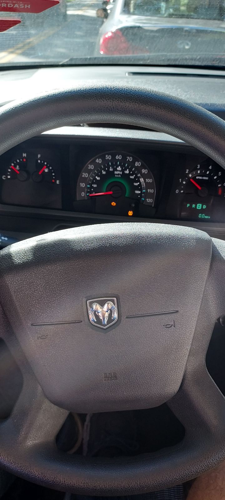

Yogitech1 Posted October 6, 2022 Report Share Posted October 6, 2022 My 2010 Journey SE gages all pass key on test but, my speedometer doesn't work and the odometer doesn't advance. Any suggestions? Quote Link to comment Share on other sites More sharing options...

Yogitech1 Posted January 31, 2023 Author Report Share Posted January 31, 2023 On 10/15/2022 at 10:12 AM, 5rebel9 said: With the age of the vehicle, driver door wiring is a known common problem on almost all makes of vehicles. The drivers door gets used the most and the wiring between the door and body in the rubber boot break. Easy enough to visually check it out. ALSO if CEL is on and computer IS STORING codes, the remote start IS DISABLED by design. I found the ABS module was bad, I replaced it and it didn't work, then a day or two later I was driving around and suddenly noticed that the speedometer and odometer started working and has since. Quote Link to comment Share on other sites More sharing options...
