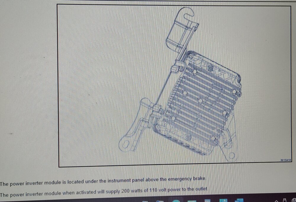

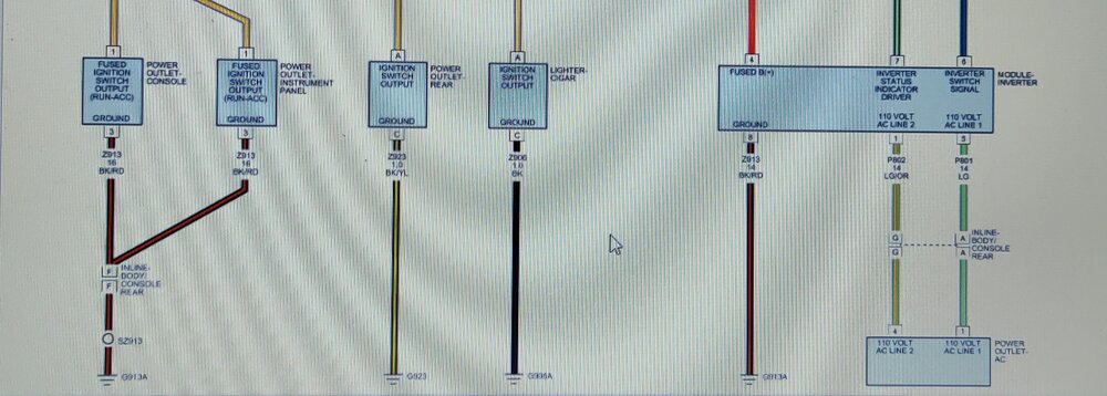

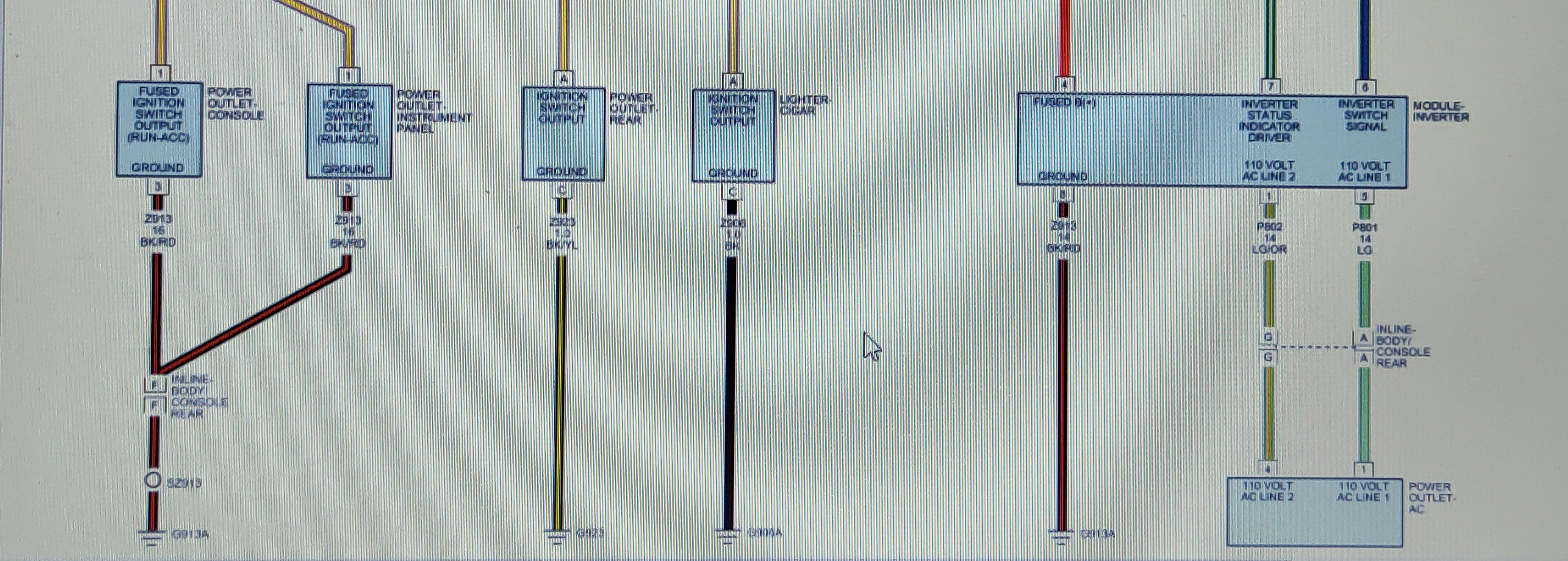

Dean H Posted January 10 Report Share Posted January 10 2016 DJ power inverter information. Quote Link to comment Share on other sites More sharing options...
