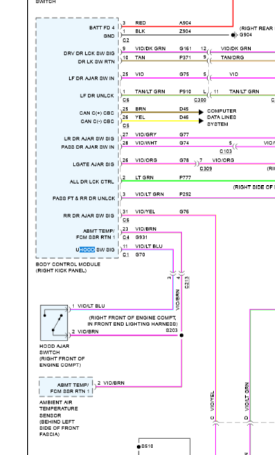

tsteves5 Posted February 24, 2023 Report Share Posted February 24, 2023 According to the online service manual for my 2011, the connector for the hood switch is a 2-pin oval connector located on the lighting wiring harness by the passenger-side headlamp. I don't know if it's the same on a 2013. It looks like it connects to the Body Control Module, so you might be able to run wires from that module if your current harness does not have them. I would suggest getting a AllDataDIY subscription so you can check to make sure the wiring is the same on your 2013. Quote Link to comment Share on other sites More sharing options...

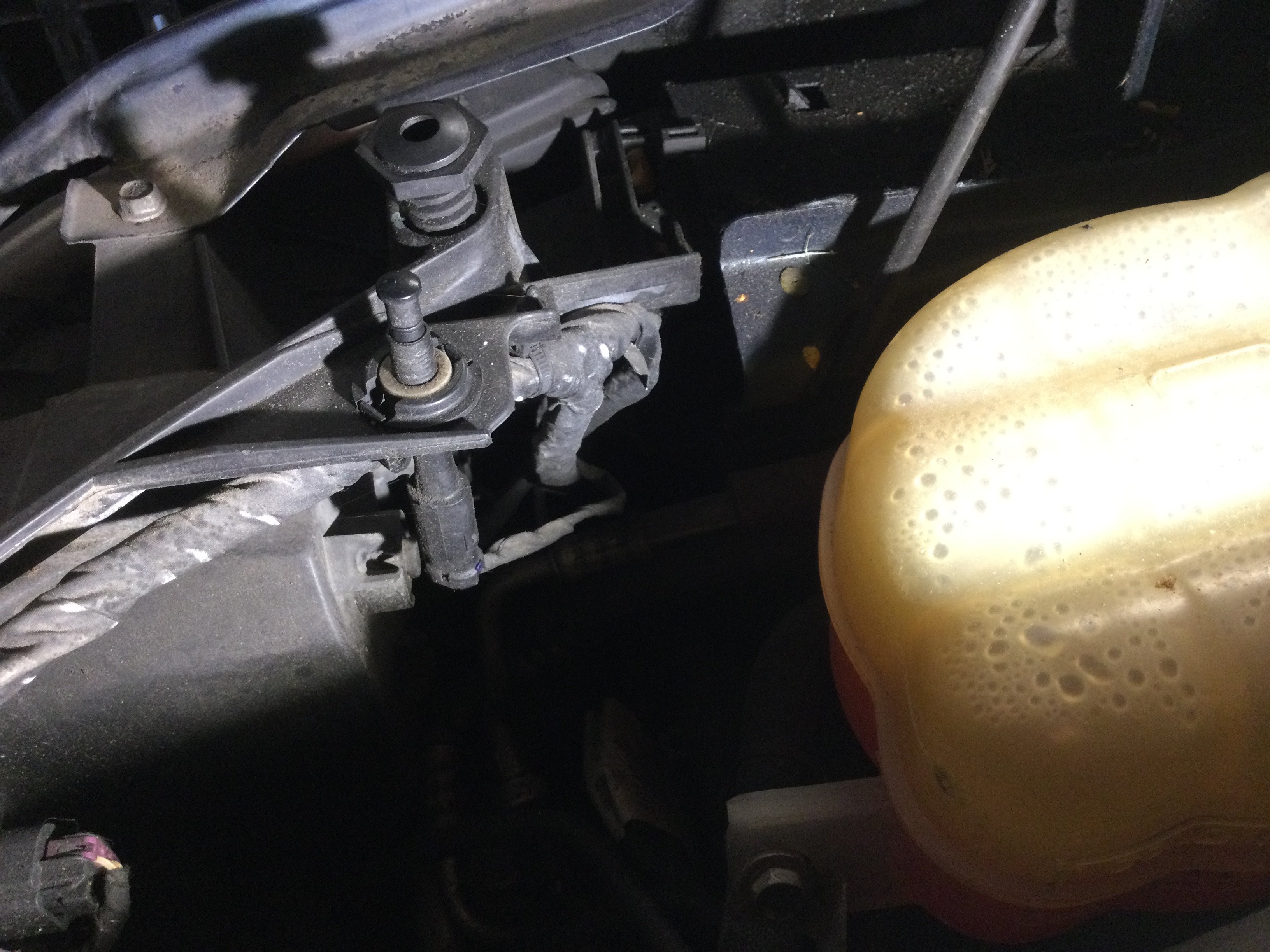

edvoyager695 Posted February 28, 2023 Author Report Share Posted February 28, 2023 My switch came in today and I popped it in and now have remote start! The connector on mine was already exposed but the switch was absent, so hardware wise it really was just slide the switch in it's spot and plug it in with the existing plug. Quote Link to comment Share on other sites More sharing options...
edvoyager695 Posted February 28, 2023 Author Report Share Posted February 28, 2023 On 2/28/2023 at 3:03 PM, AOXOMOXOA said: I know where to get the switch from, But where are you finding the harness that plugs into the switch? I know where the connector is behind the passenger light. But I need the harness that connects from the switch to the wire harness, Please. Expand For me the plug to the switch was already there and no additional harnesses/adapters were needed. I forgot to snap a 'before' picture, but did add a couple here of where the connector comes out in relation to the other grouped wires and the switch, as well as a picture of what the connector looks like (it's not very big but the one picture is just from a shopping website). From what I have read elsewhere if you don't have or need a new connector you can get them on several sites with the search term "20xx dodge journey hood ajar switch connector" or something similar. If you do end up needing to wire one in check out tsteves5's reply above for the wiring diagram. Quote Link to comment Share on other sites More sharing options...
AOXOMOXOA Posted February 28, 2023 Report Share Posted February 28, 2023 On 2/28/2023 at 5:55 PM, edvoyager695 said: For me the plug to the switch was already there and no additional harnesses/adapters were needed. I forgot to snap a 'before' picture, but did add a couple here of where the connector comes out in relation to the other grouped wires and the switch, as well as a picture of what the connector looks like (it's not very big but the one picture is just from a shopping website). From what I have read elsewhere if you don't have or need a new connector you can get them on several sites with the search term "20xx dodge journey hood ajar switch connector" or something similar. If you do end up needing to wire one in check out tsteves5's reply above for the wiring diagram. Expand oh alright, well my car already has that part in the trunk, cool thank you. so i already have the cable. Quote Link to comment Share on other sites More sharing options...
