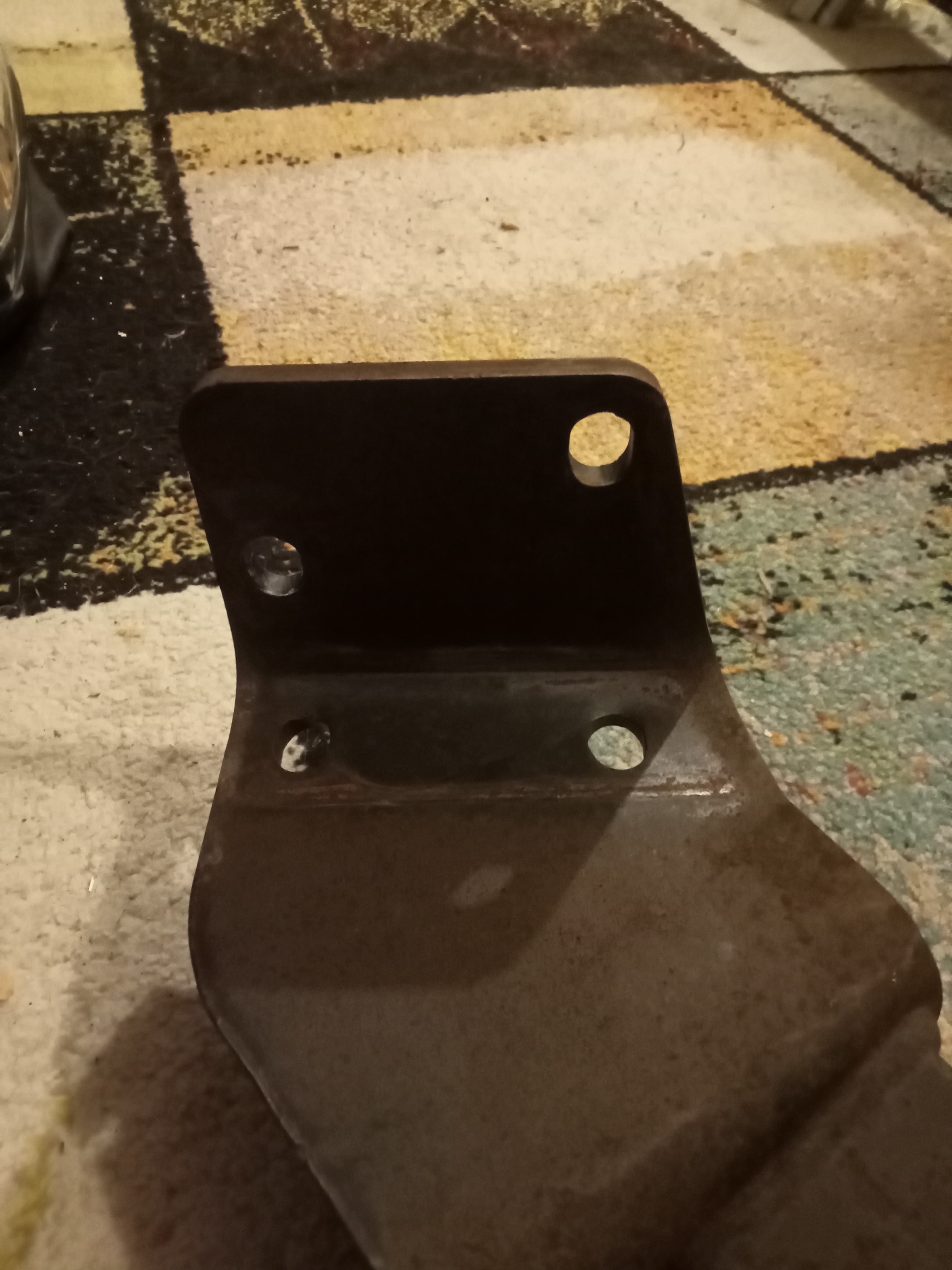

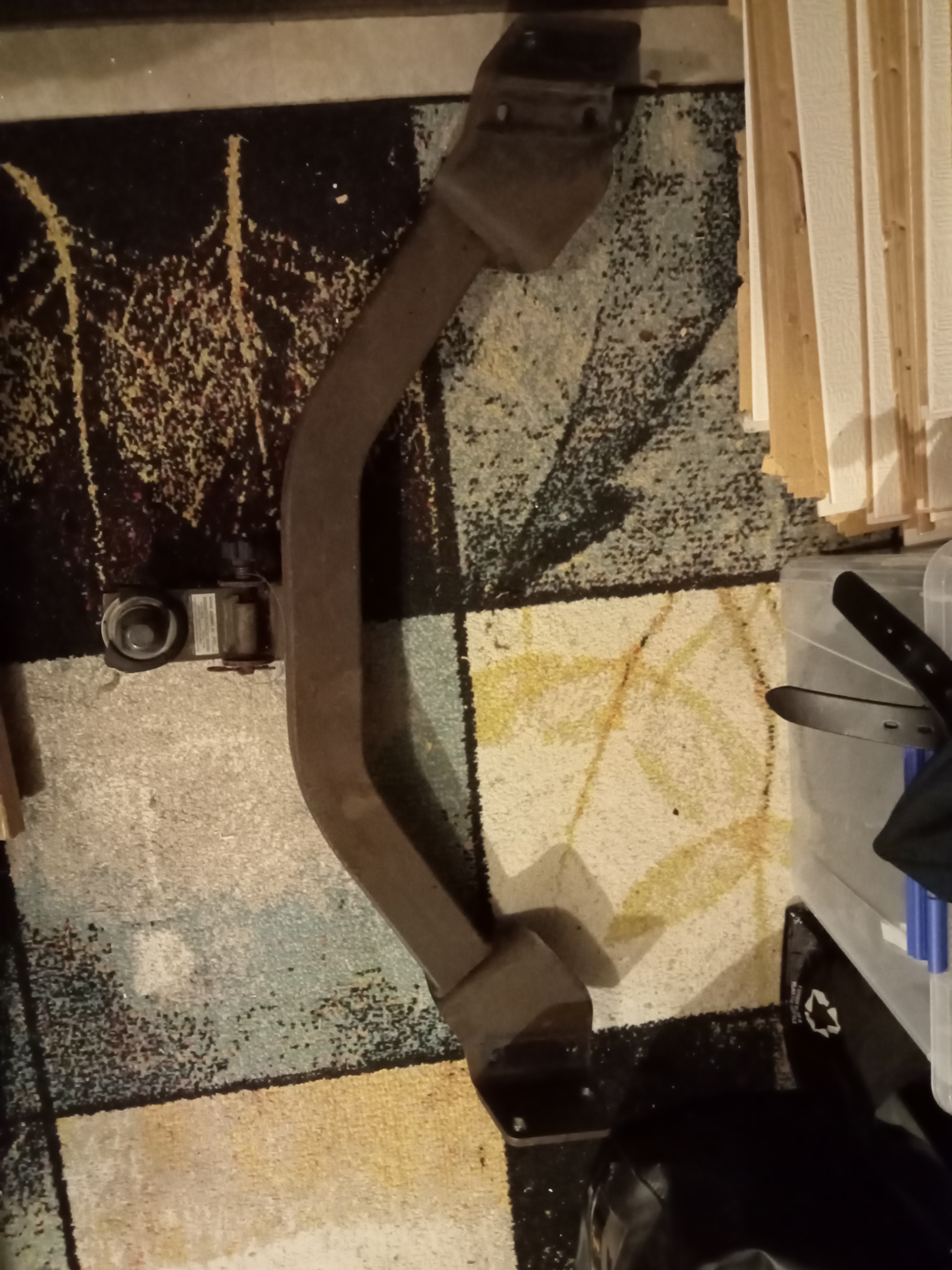

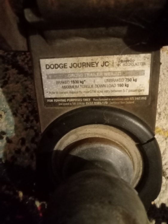

@ndy Posted June 8, 2023 Report Share Posted June 8, 2023 Hello, does anybody have the same tow bar (tow hitch) on their DJ like in the photos? Looks like a factory model tow hitch, there are holes that match the brackets on either side of the chassis frame, but I just can't figure out how you would put a nut or bolt in there. Maybe sombody has the same nad can take a phto for me or direct me to another post. My DJ is a 2011 2.7 right-hand drive New Zealand new, Thank you. Quote Link to comment Share on other sites More sharing options...
14WhiteRTRallye Posted June 8, 2023 Report Share Posted June 8, 2023 Fast forward to 3 min. Fishwire the bolt. Quote Link to comment Share on other sites More sharing options...
2late4u Posted June 8, 2023 Report Share Posted June 8, 2023 mine wasnt factory but you use a spring the screws onto the bolt thread then pulled thur the hole by a string or wire ;like shown in the video,,are using the oem wires for power i used the wiring kit and went to the battery up front ,,,if you use the factory oem wiring you will have to get the sales code authorized thur the local dealership before it will work Mcgusto82 and DodgeaWrench 2 Quote Link to comment Share on other sites More sharing options...
DodgeaWrench Posted June 9, 2023 Report Share Posted June 9, 2023 I installed a Curt #12134 class II hitch receiver on my 2014 DJ. It came with the gizmo 2late4u described used to feed the bolt and hardware through the frame channel. Curtis has several installation videos specific to the DJ showing the process. Easy install. Quote Link to comment Share on other sites More sharing options...
2late4u Posted June 9, 2023 Report Share Posted June 9, 2023 On 6/9/2023 at 2:26 AM, DodgeaWrench said: I installed a Curt #12134 class II hitch receiver on my 2014 DJ. It came with the gizmo 2late4u described used to feed the bolt and hardware through the frame channel. Curtis has several installation videos specific to the DJ showing the process. Easy install. i installed the curt class 3 hitch on my 2014 Expand johanbrandon 1 Quote Link to comment Share on other sites More sharing options...
