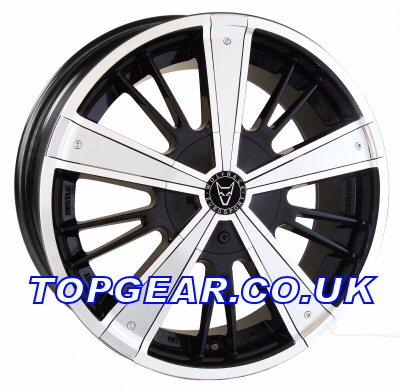

paulnat Posted August 15, 2010 Report Share Posted August 15, 2010 Hi what do you think these alloys will look like on a Black 2010 Journey SE. Need some opinions, getting my car next week and some new alloys will be the first addition, then the tints. Will upload pics when its sorted. Also if you change to 19" alloys from the original 16" what do you need to do? :blink: Will the car still drive fine and the wheels wont scrape on the wheel arches will they? Cheers. Paul Quote Link to comment Share on other sites More sharing options...
RebelThunder Posted August 15, 2010 Report Share Posted August 15, 2010 those are some sweet rims. just remember that the DJ have a very odd bolt pattern. its 5x127 i think. for some reason theres not alot of wheels that have these. +3 wheel size is still good.more than that is pretty much putting stress on some parts of your car and the ride will suffer. Quote Link to comment Share on other sites More sharing options...

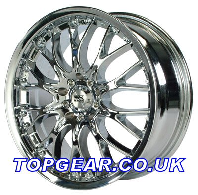

paulnat Posted August 17, 2010 Author Report Share Posted August 17, 2010 Thanks for the reply I have no idea what that means, but the website says they supply alloys for any cars, just enter make and model when filling in the postal thing and they will make sure the right ones get to you. Think that sounds ok? Going to change the alloys now to these ones I think. What do you think? Quote Link to comment Share on other sites More sharing options...
RebelThunder Posted August 18, 2010 Report Share Posted August 18, 2010 i like the first one imo. i'm not a tire expert. I just know all these stuff from reading threads here in this forum. just ask them if its gonna fit a dodge journey. i'm pretty sure they will not sell you one that will not fit. whats the website btw? Quote Link to comment Share on other sites More sharing options...
