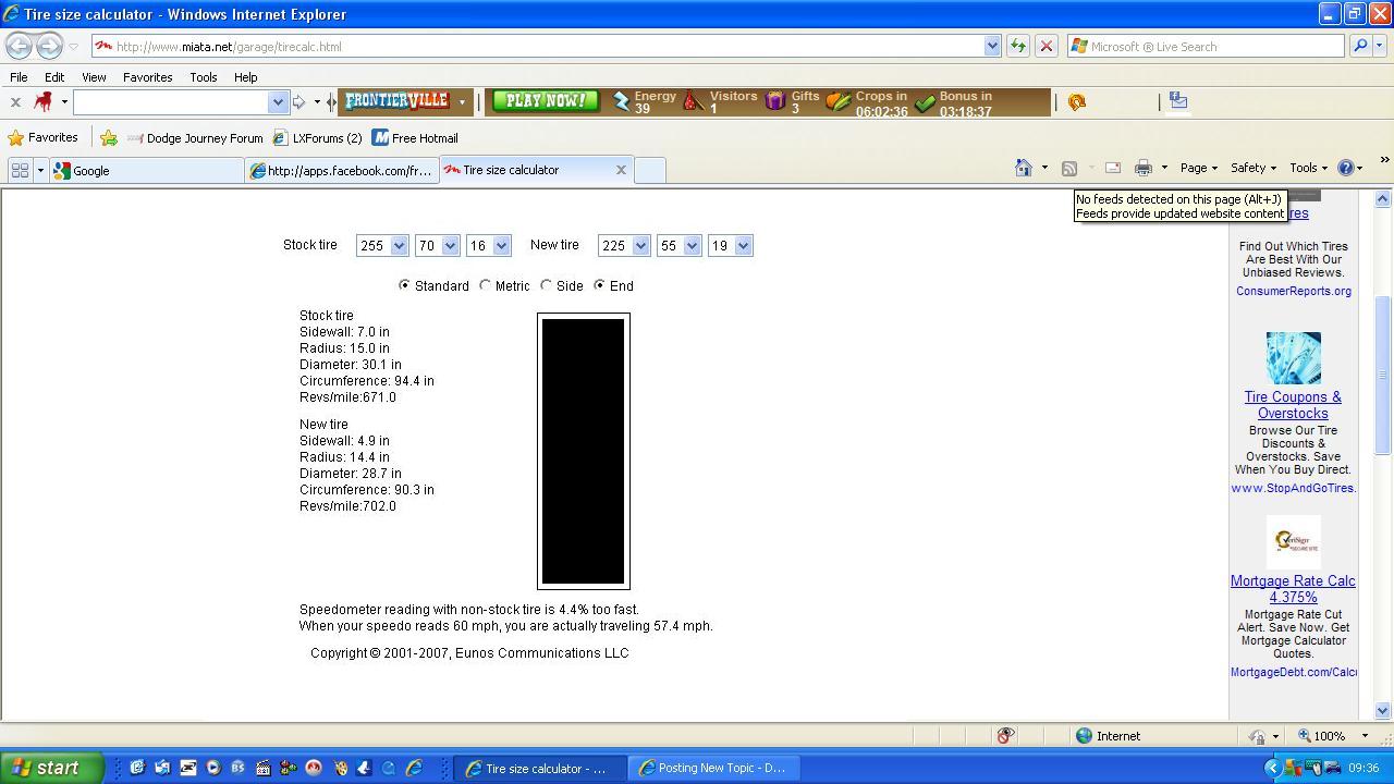

from the canadian Dodge website, it states the 3 different tire sizes. 255/70/16 >>>255/65/17>>>225/55/19
my question conserns the 4.4% diameter difference between the 19" and either the 17"or 16" as these both have the exact dimensions
do you recon that the speedo is calibrated accordingly? seeing as the 19" wheels are an option with the SXT trim
What's your take on this????
If you are too concern about the Speedo accruacy, you can go to the dealer and have them reprogram the tire size. These are Customer preference option, they usually do it for free on the first 3 months you bought ur car.
