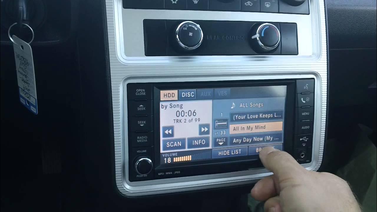

mpisio Posted July 6, 2023 Report Share Posted July 6, 2023 I was wondering, could the radio from say a 2018 Journey fit into a 2010 Journey and be just plug and play? as in the top pictured radio replace the bottom pictured radio? Quote Link to comment Share on other sites More sharing options...
bramfrank Posted July 6, 2023 Report Share Posted July 6, 2023 The answer is 'no'. Very different devices/ Locosiete and 2late4u 2 Quote Link to comment Share on other sites More sharing options...
mpisio Posted July 6, 2023 Author Report Share Posted July 6, 2023 Would it PHYSICALY fit? (ie. the plugs) and I just ignore the heater control and other functions? Quote Link to comment Share on other sites More sharing options...
Mcgusto82 Posted December 10, 2023 Report Share Posted December 10, 2023 the 8.4 uconnect is not a standard radio. The screen you see is literally just a flat screen. The actual radio is buried deep underneath the climate knobs. The actual size is also way bigger than the standard 2 din from the 2010 DJ. 2late4u 1 Quote Link to comment Share on other sites More sharing options...
Locosiete Posted December 14, 2023 Report Share Posted December 14, 2023 On 7/6/2023 at 6:39 PM, mpisio said: Would it PHYSICALY fit? (ie. the plugs) and I just ignore the heater control and other functions? The amount of customization needed to make it work it would be cheaper and easier to swap with a aftermarket stereo Quote Link to comment Share on other sites More sharing options...
