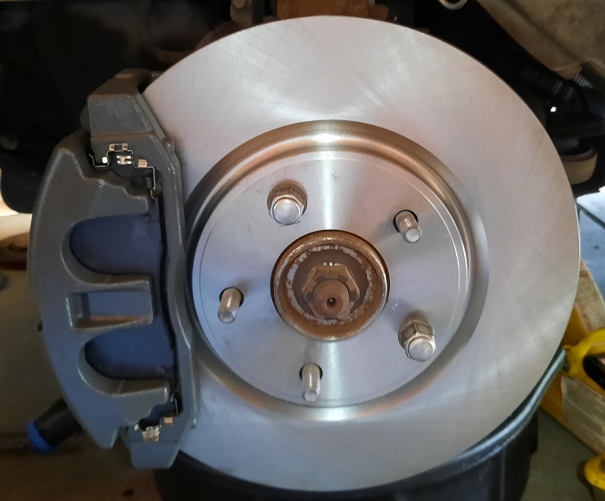

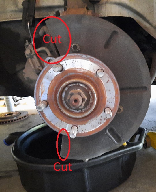

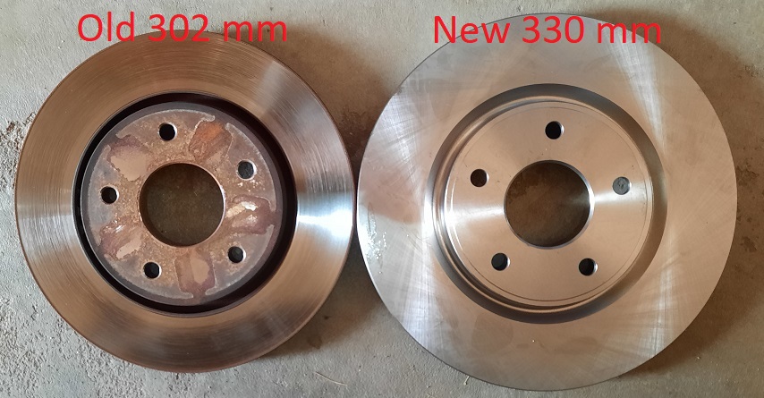

tsteves5 Posted July 7, 2023 Report Share Posted July 7, 2023 (edited) My 2011 Journey has the Standard-Duty brakes with the single-piston front calipers and the 302 mm rotors. These brakes are under sized, eat up pads, and have a nasty tendency to warp. My Town and Country has the Heavy-Duty brakes, dual-piston front calipers, larger pads, and 330 mm rotors. These are much more robust, last a long time, and seem to rarely warp. Dodge began offering the HD brakes as an option on the 2012 and later Journeys. I decided to see if I could upgrade my 2011 front SD brakes to HD brakes. It wasn’t difficult. All I needed was a set of dual-piston calipers with brackets, a set of 330 mm rotors, and a set of new pads for those rotors. The existing steel shield needed to be cut slightly to allow for the larger brackets. Everything else bolted right into place and fits within the existing wheel. I did have some issues with the new/rebuilt calipers. It took a couple of sets until I found some that worked correctly. The first set of calipers has frozen slide pins that would not budge. The second set had pistons that wouldn't retract slightly when the brake pedal was lifted. I just thought I would pass along the info if anyone else is frustrated with their SD brakes. Edited July 8, 2023 by tsteves5 5rebel9, 2late4u, sppmaster and 1 other 4 Quote Link to comment Share on other sites More sharing options...
