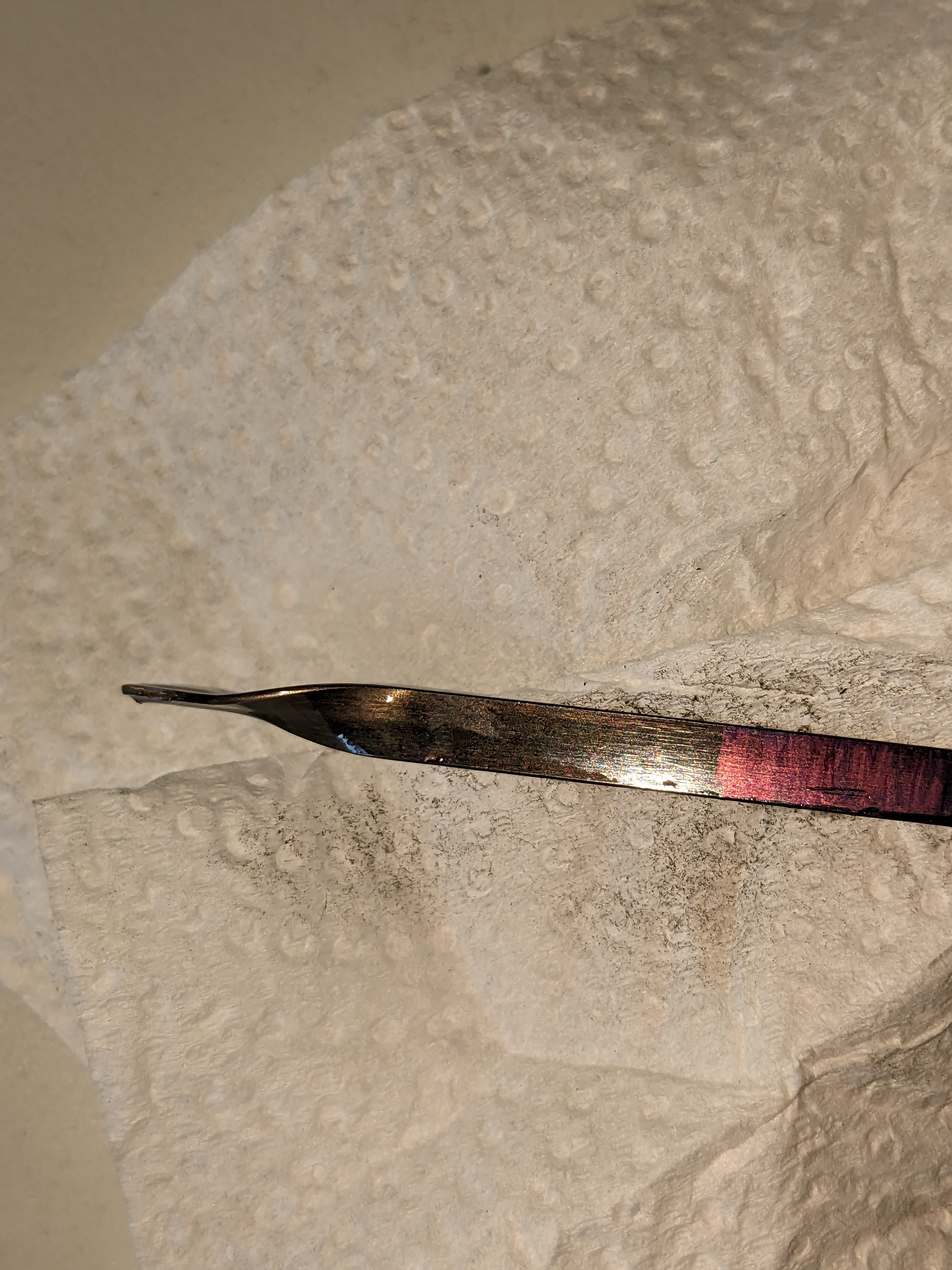

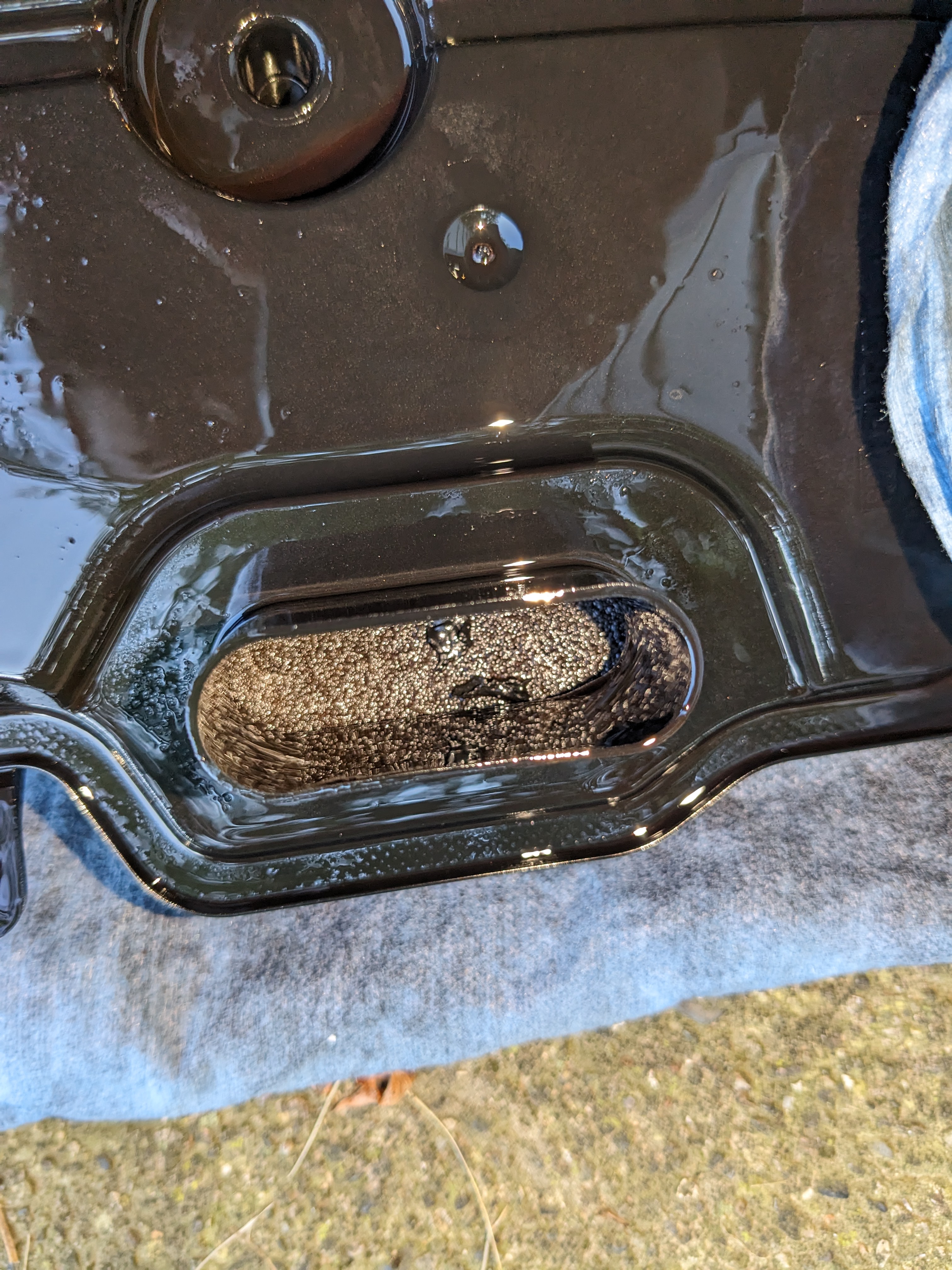

x_orange90_x Posted July 29, 2023 Author Report Share Posted July 29, 2023 Finished up tonight. Everything went smoothly as far as I can tell. I'll be driving it in the morning to work. I couldn't get a good reading on the dipstick when I started, the level was way off the mark. So either I didn't get the stick all the way in our the fluid was really low. I put exactly 5.5qts back in though. Attached is a photo of the filter and magnet. The fluid was very dark, like a deep red/black color. Quote Link to comment Share on other sites More sharing options...
2late4u Posted July 29, 2023 Report Share Posted July 29, 2023 if you used you oil dip stick it should bottom out as it cant be put in to far,if your not sure if you marked the dip dtick right them you can buy a test stick from a part store............ Quote Link to comment Share on other sites More sharing options...
x_orange90_x Posted July 29, 2023 Author Report Share Posted July 29, 2023 Just now, 2late4u said: if you used you oil dip stick it should bottom out as it cant be put in to far,if your not sure if you marked the dip dtick right them you can buy a test stick from a part store............ I'm pretty certain I marked it correctly. It went pretty far down in there and I DID get fluid on it. See attached picture. 2late4u 1 Quote Link to comment Share on other sites More sharing options...
x_orange90_x Posted July 29, 2023 Author Report Share Posted July 29, 2023 My fluid level was at almost the exact same spot as in that video. So I must've been low? I'm going to recheck it later today and see if it's up in the hot range. Quote Link to comment Share on other sites More sharing options...
