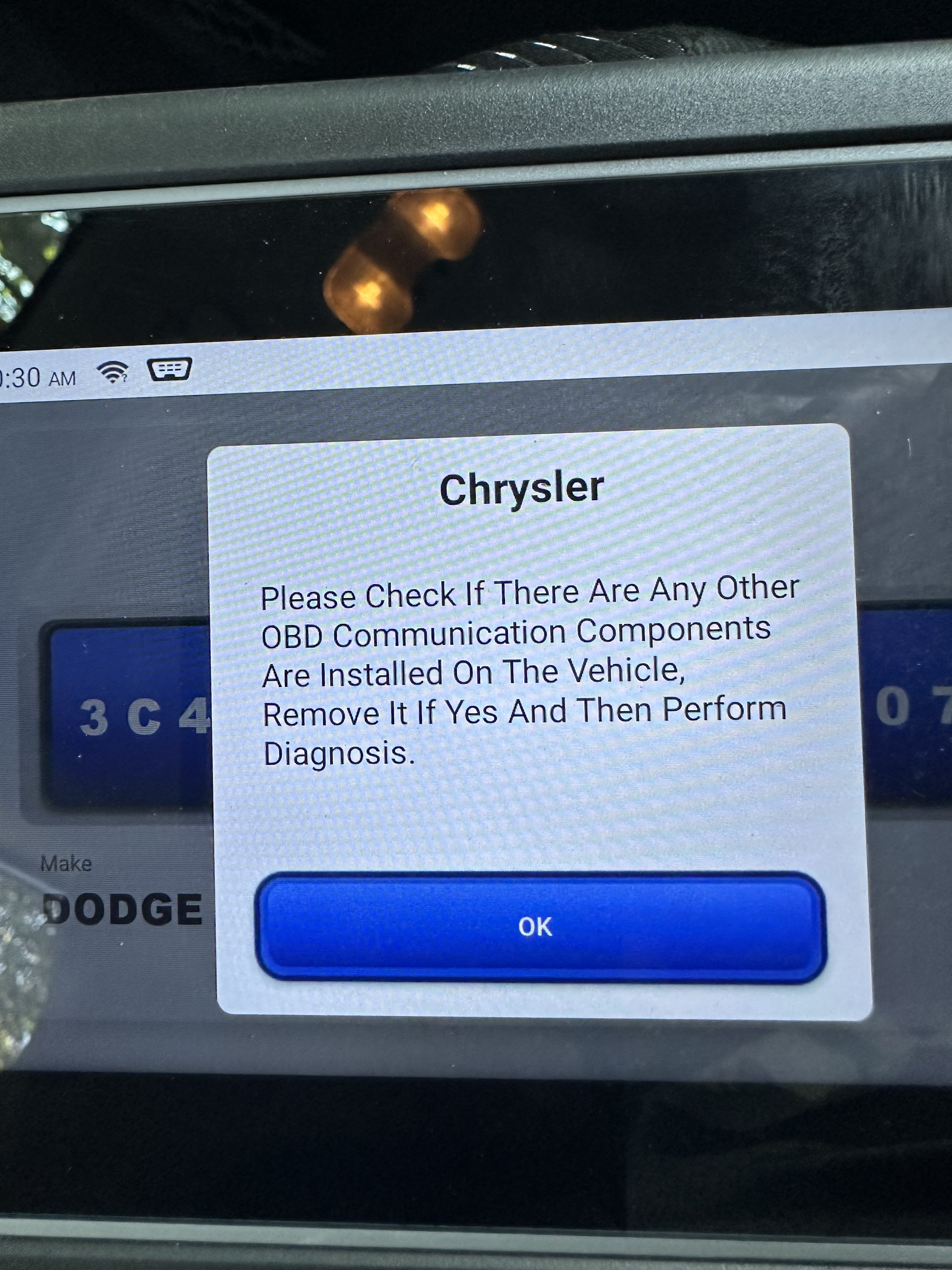

my issue is the car went into limp mode CEL on and it has the throttle lighting bolt flashing and it has a good 20 codes ranging from Throttle to transmission codes , I am getting a Chrysler message that I have never seen before in my life ! It reads …..
Chrysler
please check if there are any other obd communication components are installed on the vehicle remove it if yes then perform diagnosis
this will not let my scanner communicate with pcm to delete dtcs , I have checked to see if there is any loose wires but no luck !

Badly installed remote start can leave a mess. They never solder connections but use endless black tape.
Usually just removing the add on units fuses or main plug into the starter  electronics unit decouples it.
Doing live may have created issues. Try carefully with out arcing  against anything, to remove positive battery terminal for 5 mins.
Could even do the remote jump start feed from battery, will kill all power. The fuse box in passenger side kick panel has a lot of fuses to check if they aren’t blown.
PCM units are very tough, rarely fail.  They don’t run on 12 volts, but are usually stepped down to 8 I believe. Protects them quite a bit.  Probably still some extra wiring tied to harness; check brake pedal switch for something added on.
