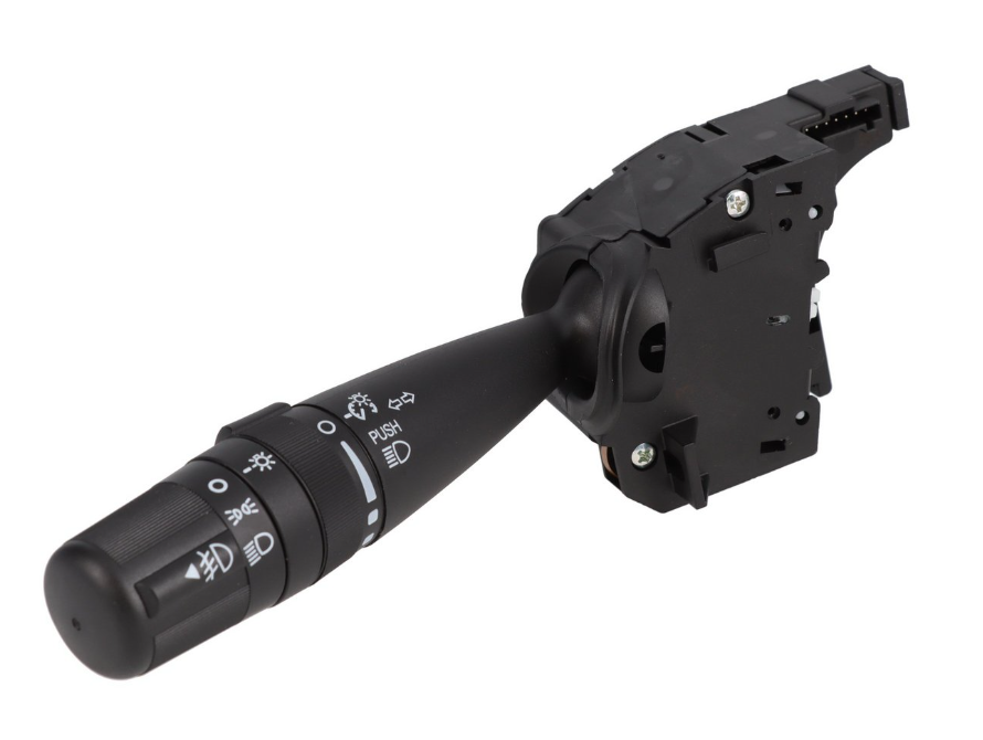

Dean H Posted September 9 Report Share Posted September 9 Katlyn, Replace the turn signal lever-switch. Quote Link to comment Share on other sites More sharing options...
Katlyn Posted September 9 Author Report Share Posted September 9 15 hours ago, Dean H said: Katlyn, Replace the turn signal lever-switch. I have tried that. Quote Link to comment Share on other sites More sharing options...
Dean H Posted September 9 Report Share Posted September 9 (edited) okay, That fixed Krishelle's DJ. So on the 2010 DJ, There is no separate light switch. Everything is on the turn signal switch on the steering column. Have you been able to locate a fuse or relays under the hood or interior fuse box? Need to get a copy of the correct 2010 wiring diagram. For all lighting systems. Ask a shop if they would get them for you. My information is for a 16 DJ. Dean Edited September 9 by Dean H Quote Link to comment Share on other sites More sharing options...
