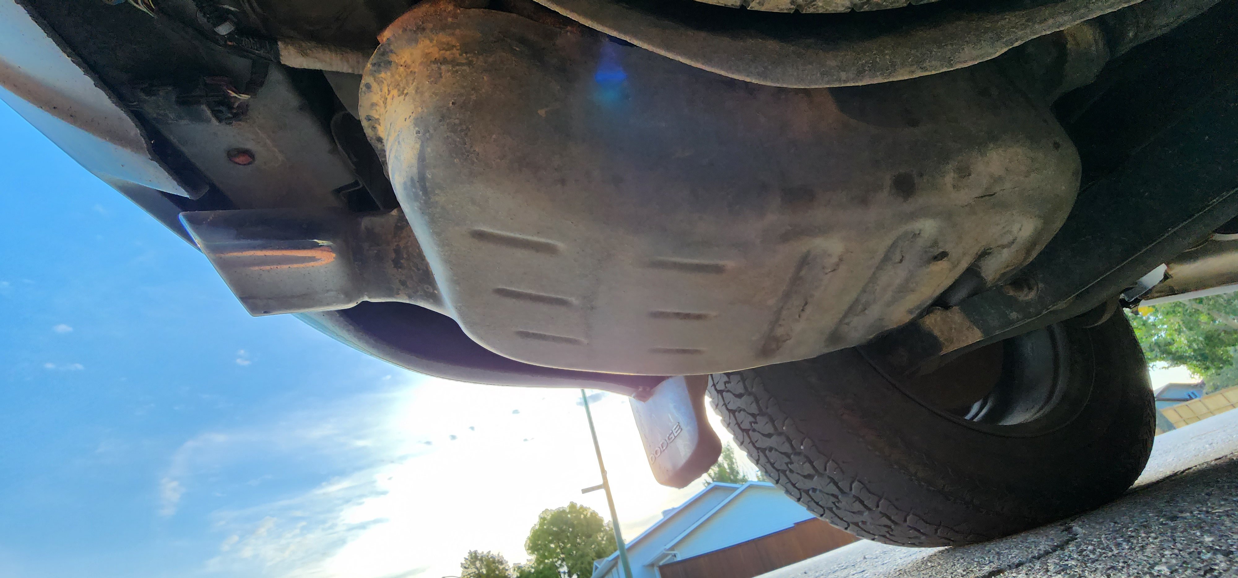

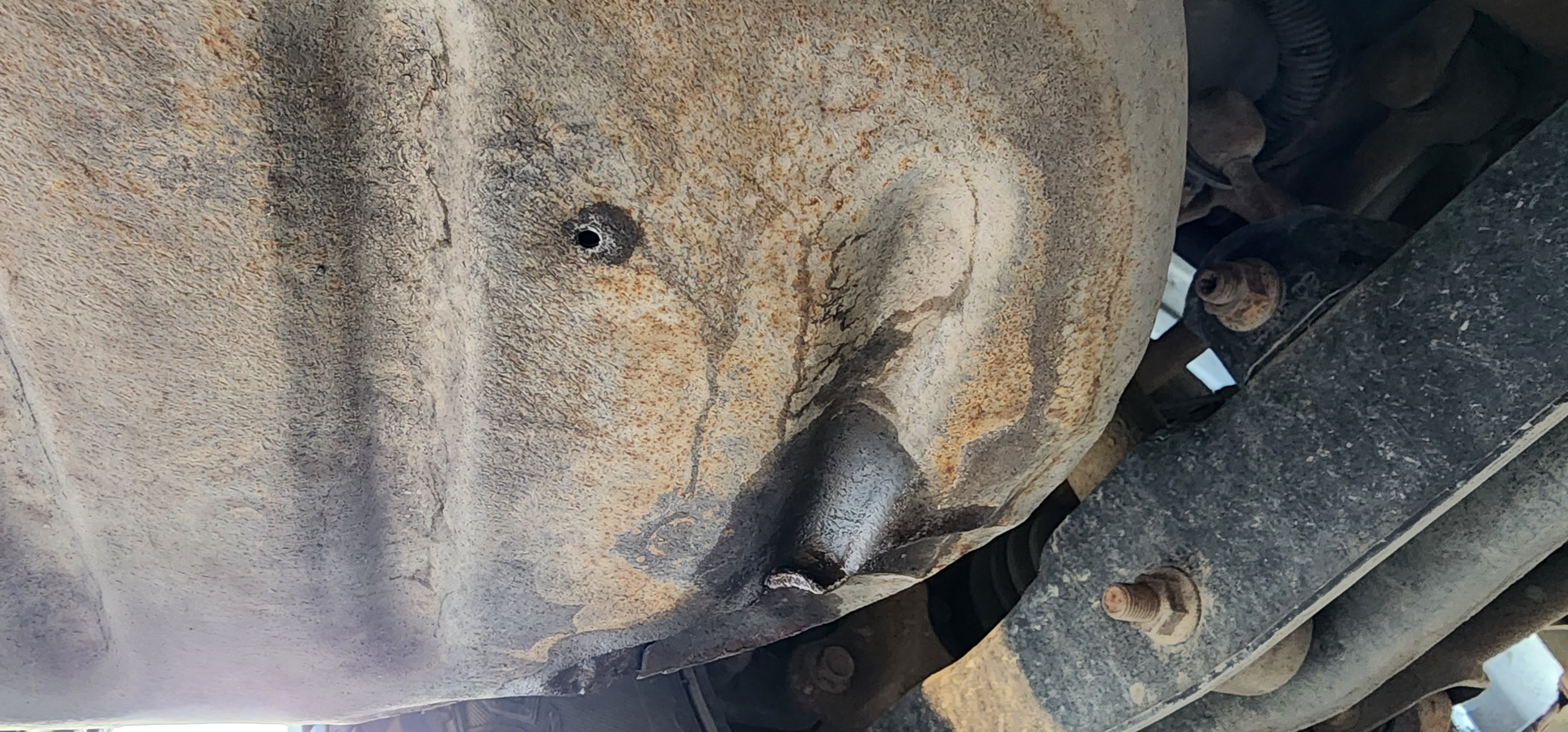

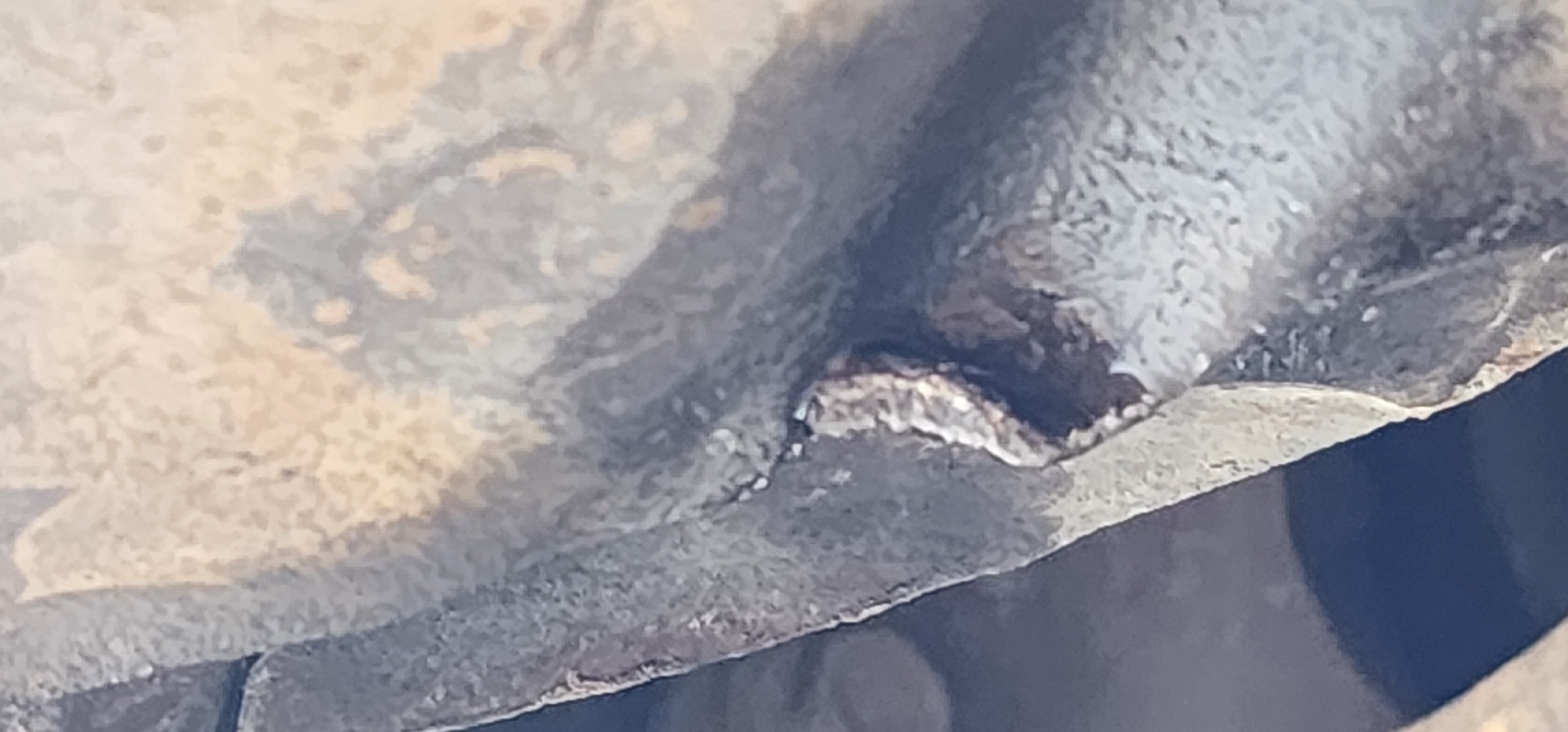

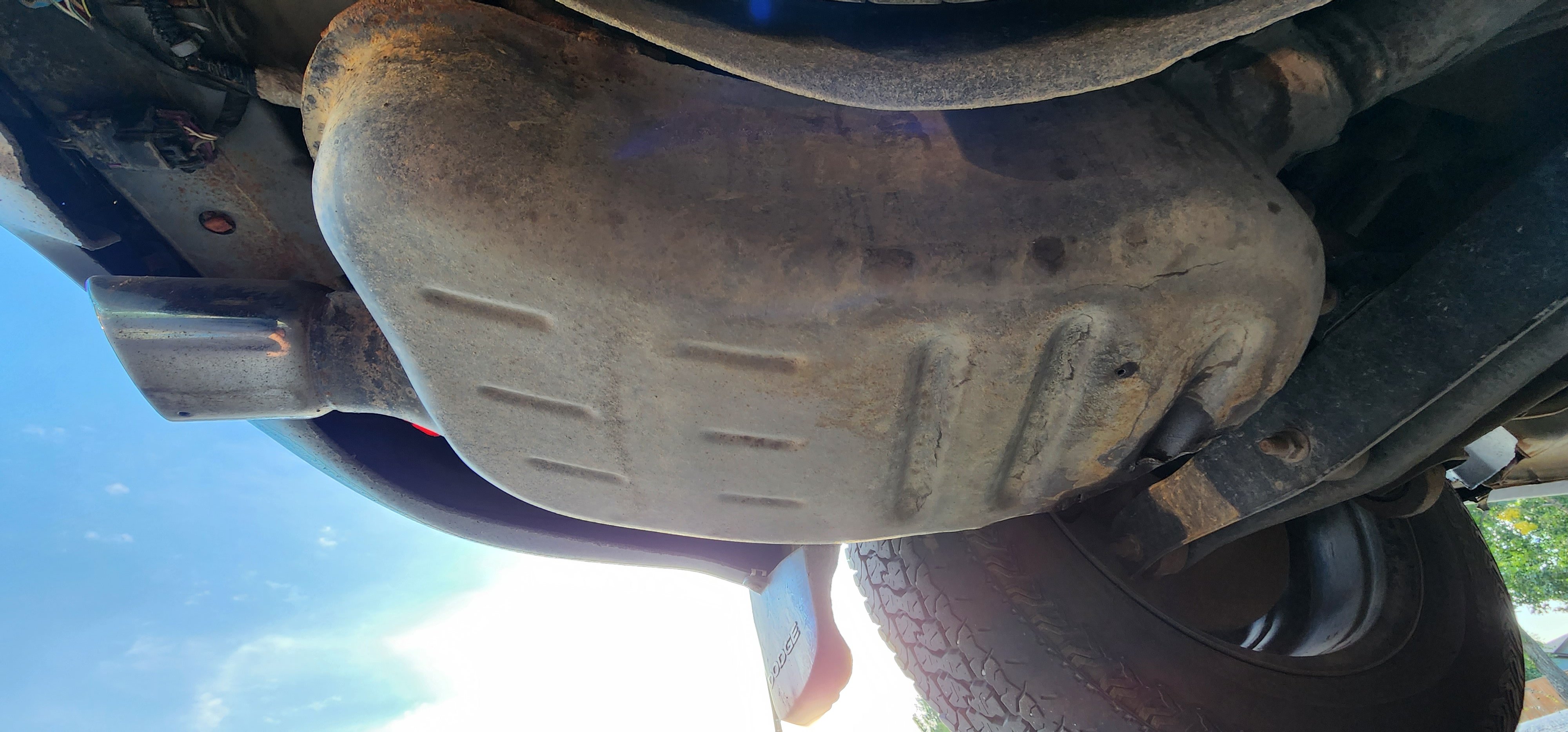

I just recently bought this dodge journy 2016 RT at 180,000 kms. So I have been driving around and I dont remember hitting any bumps but last night I noticed a leak from my vehicle. And now I have this big dent in the left muffler.
And i never noticed any leaks before even when buying the vehicle, i didnt do much driving the day i realized the leak.
I dont know if this is okay and i dont know what to do, can someone help me.
Thank you!
(First time on this site btw)
Don't worry about it that small hole you see is the drain hole to let out water created by your exhaust, the dent might just now be the lowest drain spot due to being hit ,,that said it might rust out a bit faster in the next 4-5 yrs but i wouldn't be worried about it just depends on much salt they use on the roads up there.... all journeys leak water out of there...also welcome to the group:welcome:
