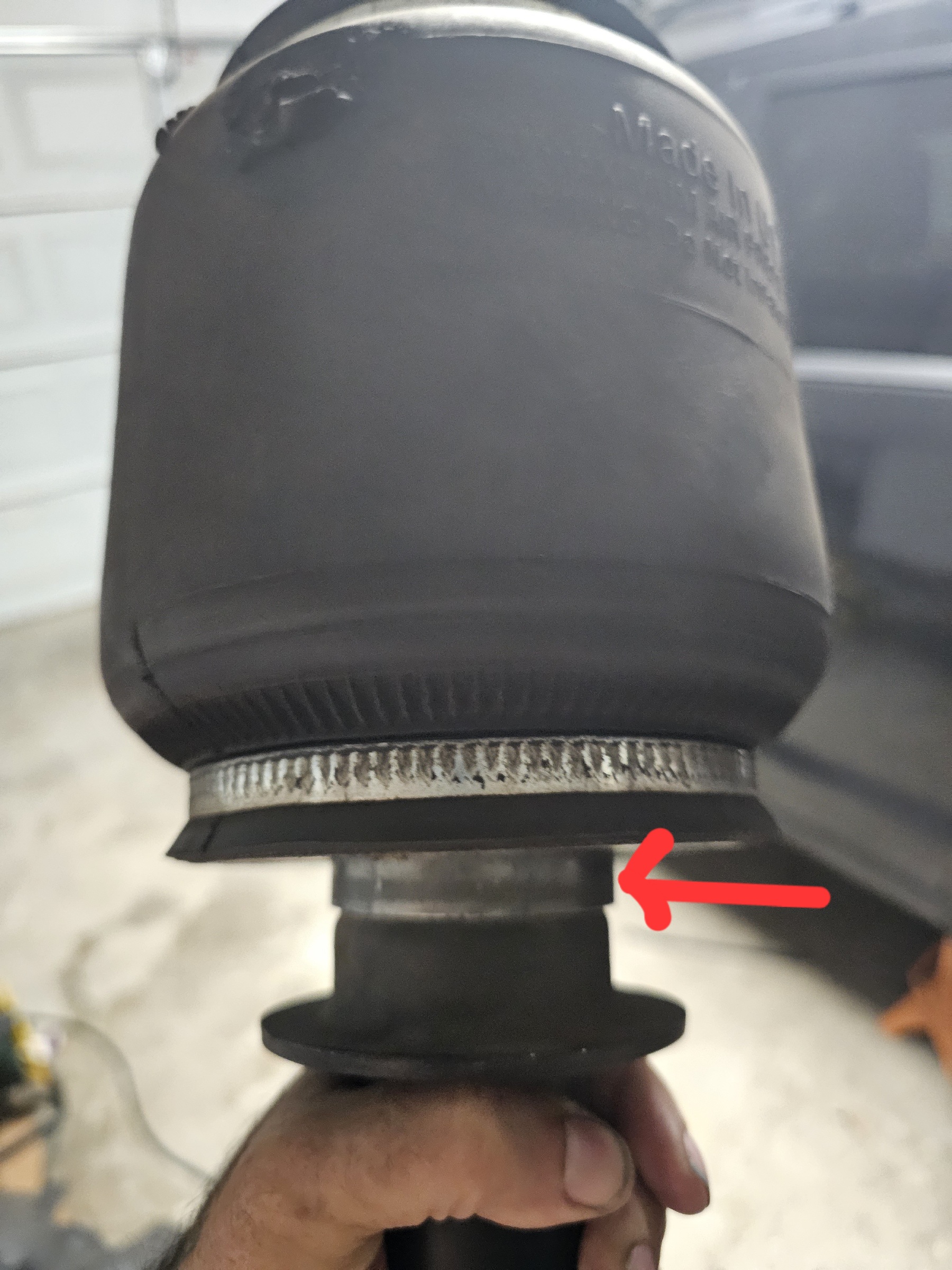

Locosiete Posted November 13, 2023 Author Report Share Posted November 13, 2023 Well got started this weekend and didn't get as much as I wanted accomplished. Found rear passenger had been rubbing and rather then putting it back on and replaced it in the near future just ordered a replacement one. So needless to say that puts a slight delay in plan. The other delay is waiting on my Cadillac to finish getting the seats redone. Which is a good since this leave me extra room in garage while it being done but bad cause I am using the air manifold from that car to put in my dodge so i can then upgrade the Cadillac. I'm upgrading my Cadillac to 1/2" lines since the 3/8" setup works but not as quickly as I want, Cadillac is not a skinny girl ? ? ? ? Side note if anyone needs to replace front struts I found a bungee cord works perfect to hold brake assembly in place. I'm sure others know this but thought I'd share while I was at it. The jack is just there to keep it from sagging too much. Car is currently on 4 jackstands. Other hiccup was I need to either trim the spring perch in rear or add a spacer. Rather the possibly ruining the rear struts went with a 1/2" spacer. So it won't sit as low now by 1/2" but I don't think it will be too noticeable when it's parked and layer down. Without the spacer the fittings would hit the perch and break from the weight. Man that took way too long to make by hand using a pipe cutter. One of those times I wish I has a bandsaw! 2late4u 1 Quote Link to comment Share on other sites More sharing options...
5rebel9 Posted November 13, 2023 Report Share Posted November 13, 2023 And those rear bags have lasted how long? You have done something that FEW have done with a Journey, and I know there is not much room to visually see for clearances of the rear strut perches. You did very well on the initial air system install! Now it's time to "fine tune" fitment to take care of the slight rubbing and make your planned "upgrades" you posted of. Don't get discouraged and keep on going. Looking forward to more updates! 2late4u and Locosiete 2 Quote Link to comment Share on other sites More sharing options...
Locosiete Posted November 13, 2023 Author Report Share Posted November 13, 2023 (edited) Got 3 years out of them so I guess I can't complain too much. I'm just curious if they were rubbing before I installed the adjustable rear arm or after once the alignment was redone and camber was adjusted. Or it always has rubbed. May need to use a "finesse" hammer and "massage" it lol. I'm just not to confident the metal is thick enough to take a whack that will move it or just end up with a hole that need to be repaired. Also thought maybe I can apply a greese of some sort but would need to find something that won't ruin the rubber. Hmmm... Edited November 13, 2023 by Locosiete add info Quote Link to comment Share on other sites More sharing options...
5rebel9 Posted November 13, 2023 Report Share Posted November 13, 2023 On 11/13/2023 at 3:05 PM, Locosiete said: Got 3 years out of them so I guess I can't complain too much. I'm just curious if they were rubbing before I installed the adjustable rear arm or after once the alignment was redone and camber was adjusted. Or it always has rubbed. May need to use a "finesse" hammer and "massage" it lol. I'm just not to confident the metal is thick enough to take a whack that will move it or just end up with a hole that need to be repaired. Also thought maybe I can apply a greese of some sort but would need to find something that won't ruin the rubber. Hmmm... Expand WOW ! 3 years? Normal struts and shocks don't last much longer on any vehicles up my way. And yours is just a minor rub problem that WHO CAN KNOW from under WHAT conditions they rub. Raising/lowering and driving/cornering all come into play on when they might have been rubbing. One thing I'm finding out with all 3 of mine is that all 3 camber/toe and control arm bushings are definite wear/weak links in maintaining "tight"suspension geometry to keep all "lined up". From watching shows of doing car mods with "bagging" a suspension, it is very important for a very liberal clearance room all the way around, and usually VERY HARD to determine when inflated and weight put to the car on the ground. As I said before, you have done some pretty special upgrading to do this and 3 years use is a nice return. NOW a bit more "engineering" and make the system last longer. Locosiete 1 Quote Link to comment Share on other sites More sharing options...
Locosiete Posted November 13, 2023 Author Report Share Posted November 13, 2023 It will take some trial and error but that is something I knew would happen since I don't know anyone else that has done a journey i can learn from that that alreadyhad to deal with this. I know they are out there but I don't know them lol. Replacement bag should arrive Friday and then back at it ? ? ? 5rebel9 1 Quote Link to comment Share on other sites More sharing options...

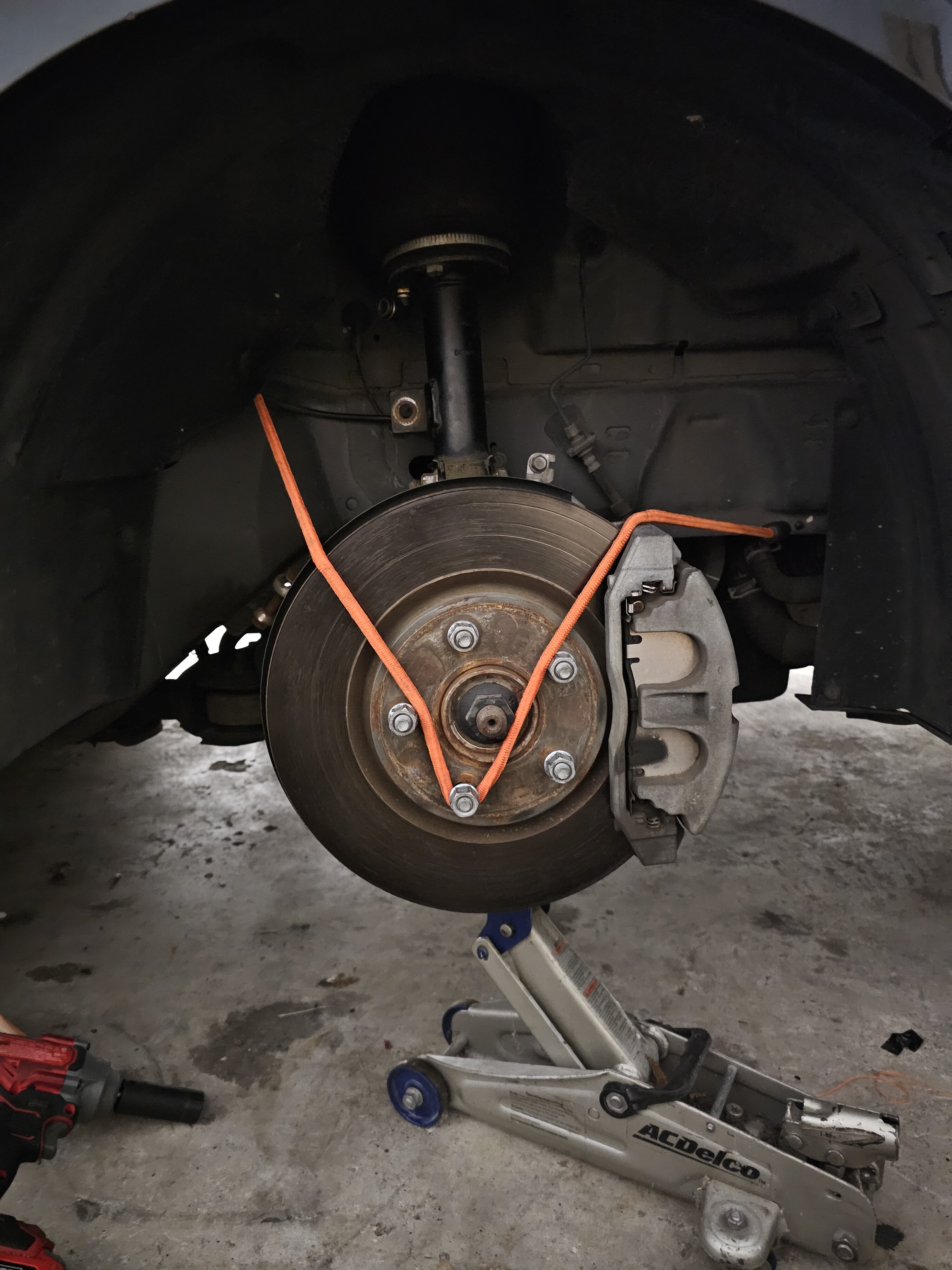

Locosiete Posted November 20, 2023 Author Report Share Posted November 20, 2023 (edited) Well got a little further. Ran air lines for front through the openings of the side skirt and used the grommet in front of the rear axle for the front bags. And used the grommet that is behind the rear axle for rear bag. Then mocked up the frame and used some cardboard to make a stencil for a new rear floor board. The upholstery should arrive tomorrow so during the week hope to have board cut and wrapped. New tank should also arrive tomorrow so can then moc that up so once the cadillac gets home so i can pull the manifold, slap it in the Dodge and then move onto the cadillac. Guy doing the upholstery was hit by a semi and so he is running behind. But again that helps me leaving me room in the garage. The Caddy is my other toy. I took this picture a couple months ago when I picked it up from paint. Edited November 20, 2023 by Locosiete typo 2late4u and 5rebel9 2 Quote Link to comment Share on other sites More sharing options...
