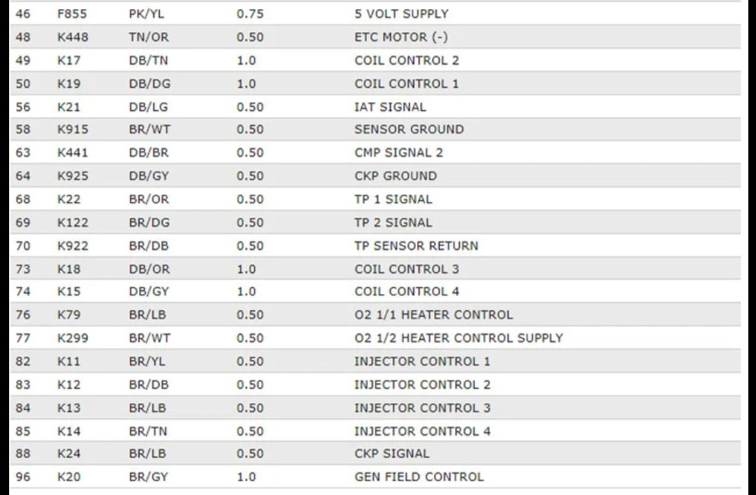

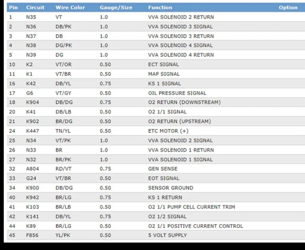

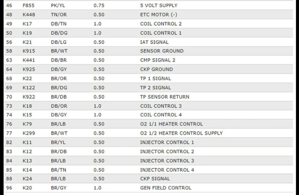

WhatAGirlMustDo Posted December 21, 2023 Author Report Share Posted December 21, 2023 Thank you for the time in replying. A local mechanic was able to print up what needed while I was waiting for post approval. My dodge is up and running again. I've included them for anyone who searches the forum. Hopefully the can open them. Quote Link to comment Share on other sites More sharing options...
