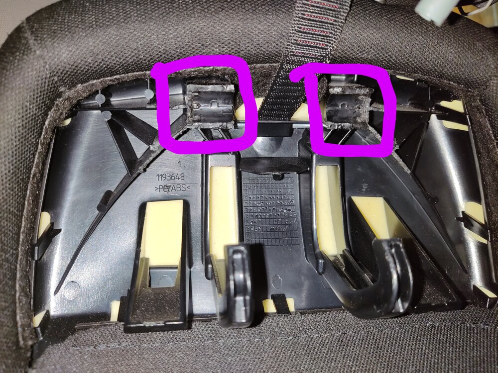

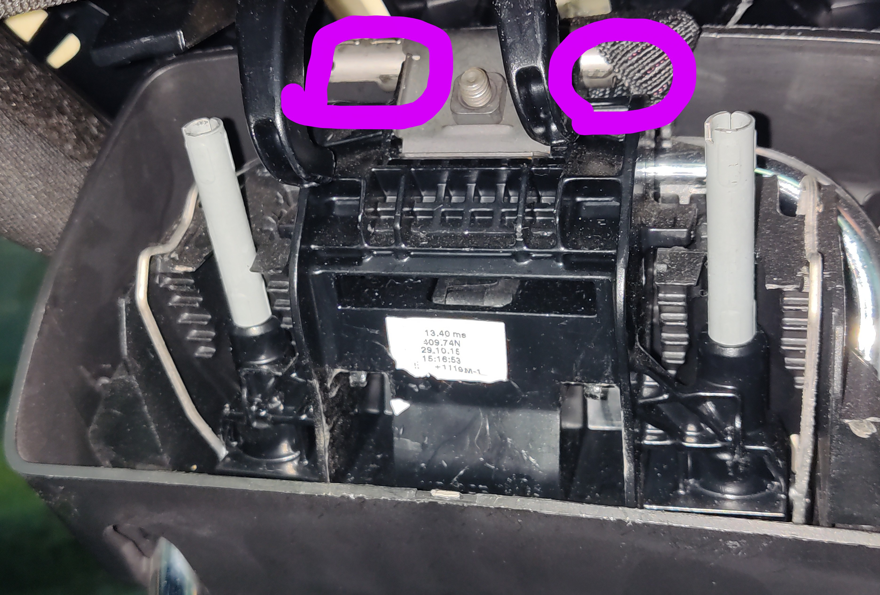

Sitting in the back seat, behind the popped headrest. The trim piece
pops loose off the headrest frame.
Lower the front seat back towards you. Then see how the headrest fits into the frame. At the top specifically. Fit the hooks on the bottom of the headrest into the frame.
Then you will see how the headrest sits.
See my pictures, I marked where
the headrest fits into the frame. I applied E6000 adhesive there.
I held the headrest to the frame for
15 minutes.
It has been a year and holding strong.
