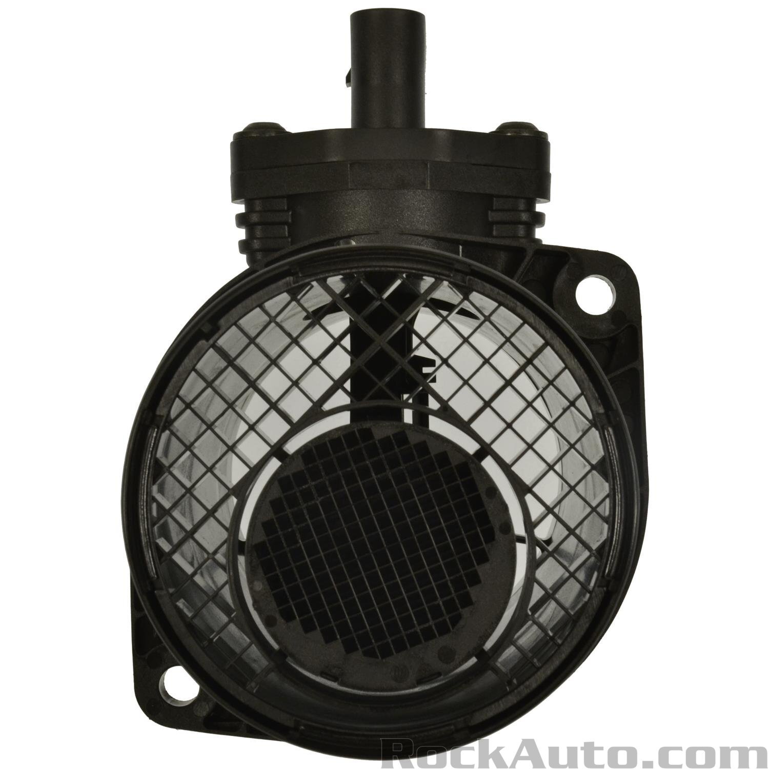

John/Horace Posted May 26, 2024 Report Share Posted May 26, 2024 Wow you have been busy. Often crank sensors are plug and play, cam not as likely. Your listed codes could be so many things. You mentioned a few posts back about breaking map sensor and gluing it. The 3.6 has one, you have a maf mass air flow sensor. They can get dirty and cause rich codes and rough idle etc. and the listed codes. Need special spray cleaner to not wreck it. It’s located in the intake air ducting. Simple and worth trying. Should not be any broken tiny wires in the fine mesh. larryl 1 Quote Link to comment Share on other sites More sharing options...
JennyRebecca Posted May 26, 2024 Author Report Share Posted May 26, 2024 Oh yeah thanks John. I guess I didn't mention I I did get a new map sensor and IAT sensor since the second gluing wasn't doing it.As far as the mass air flow sensor I'm not sure if I have one It is the 3 5 engine. Not quite sure how much difference in the 3.6 there is. And I do not know if I have more than one cam sensor or just one crank sensor and one cam sensor. The codes I'm getting now after replacing everything is the PO 340 and the PO 344 and still the damn po301. I cannot get rid of that 301 to save my life. And it's still not nearly as bad as it was before when you try to accelerate it just kind of shutters a little and and seems like it's really really struggling to go Quote Link to comment Share on other sites More sharing options...
