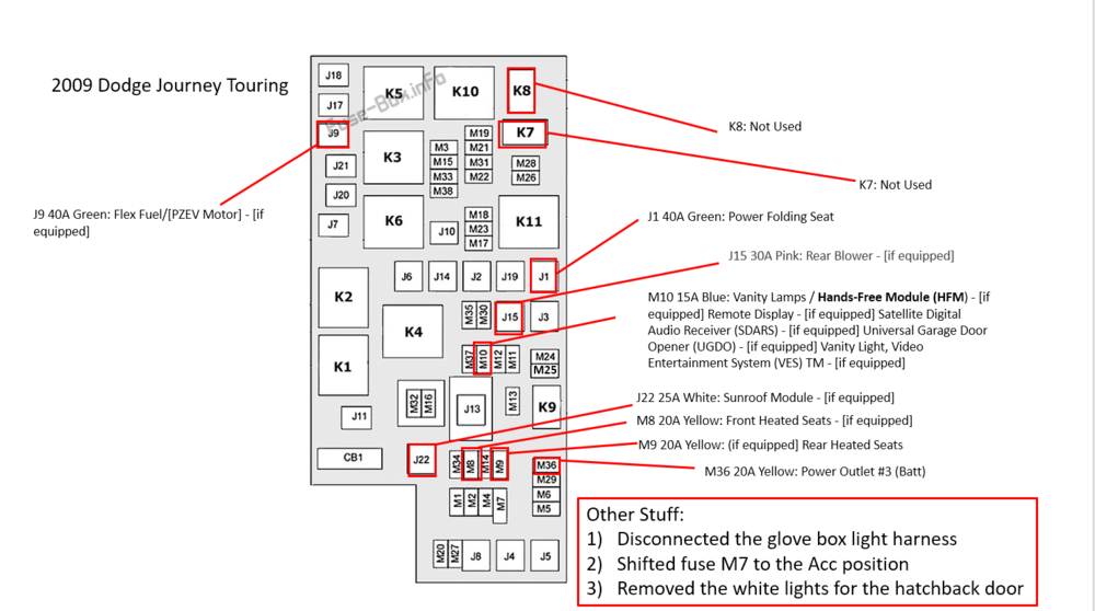

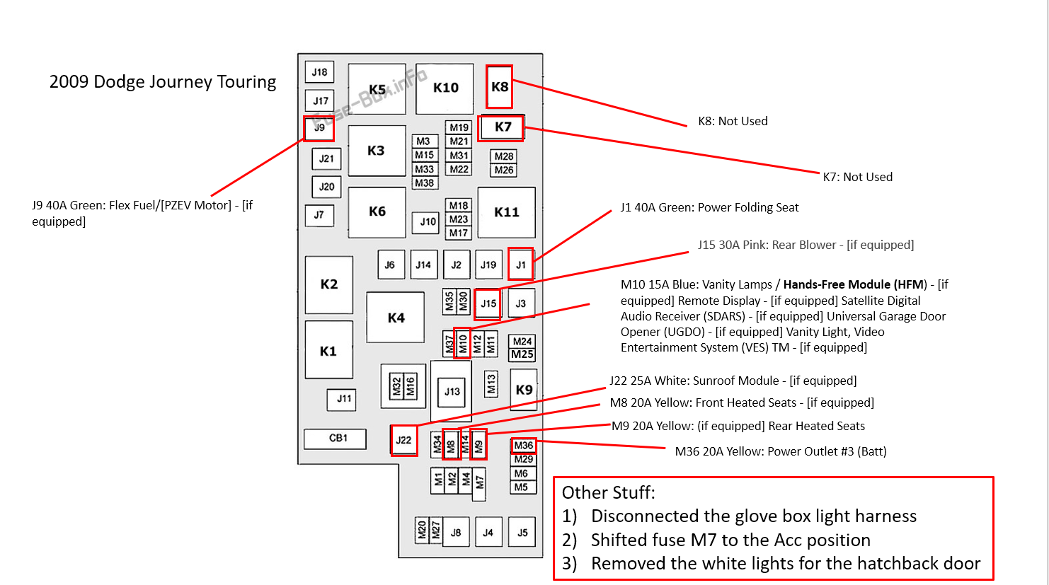

leaning Posted March 21, 2024 Author Report Share Posted March 21, 2024 I use this Journey just as a work car, so the less tech and gadgets, the better. So, while I was under the hood pulling the M10 fuse for the HFM, I went ahead and pulled a bunch more of stuff I never use. Less stuff I have to worry about weighing on the electric system. (I did this before bare-bonesing Windows computers that have a bloat of added "helpful" features.) I can always put the fuse back in if I find I need a feature. Anyway, here is what is gone so far. Time to take the car for a drive to see if any of this helped with the original door-locking-itself issue. Quote Link to comment Share on other sites More sharing options...

leaning Posted May 3, 2024 Author Report Share Posted May 3, 2024 On 4/25/2024 at 9:48 PM, Katlyn said: Hi have you found any solution to this issue?! My 2010 dodge Journey is having this exact same issue all the way down to the battery draining and I have no idea what it is causing it. Thanks in advance!! Take a look at the picture I posted. I pulled the fuses, disconnected the glove box light, and removed the bulbs from the hatchback light, and as of now, the car is just fine, no battery draining, and it has stopped starting and stopping on its own. So, give those a try, especially removing fuse M10. Good luck! Quote Link to comment Share on other sites More sharing options...
