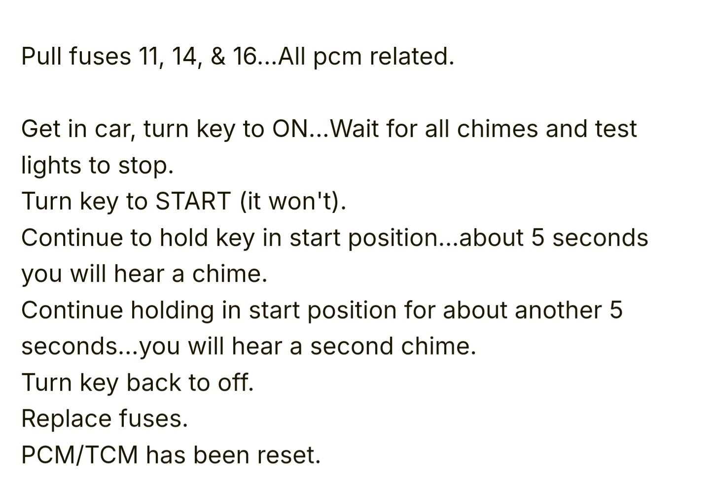

CaveManJedi Posted September 4 Report Share Posted September 4 On 4/4/2024 at 7:46 PM, 5rebel9 said: Without a scanner, the only way to erase and put computer into a relearn by driving mode is to disconnect the battery for a period of some time{folks offer varying amount} of 10 to 15 minutes. BUT, a 3.5 timing belt motor with an interference fit design...has the TIMING BELT ever been replaced? Your codes COULD be from a stretched or jumped tooth timing belt. Factory recommends 7yr 90k mile replacement, that most folks DON'T DO and pay the price later when the belt jumps time or BREAKS. That's a myth, it's not the correct way to reset pcm. Quote Link to comment Share on other sites More sharing options...
CaveManJedi Posted September 4 Report Share Posted September 4 8 minutes ago, CaveManJedi said: That's a myth, it's not the correct way to reset pcm. 8 minutes ago, CaveManJedi said: That's a myth, it's not the correct way to reset pcm. The fuses numbers may be different, but make sure you pull everyone of them that has pcm or tcm on it. I have four in my '19 journey. Quote Link to comment Share on other sites More sharing options...
