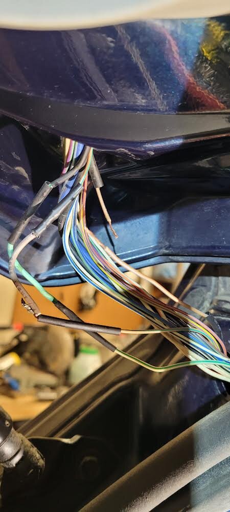

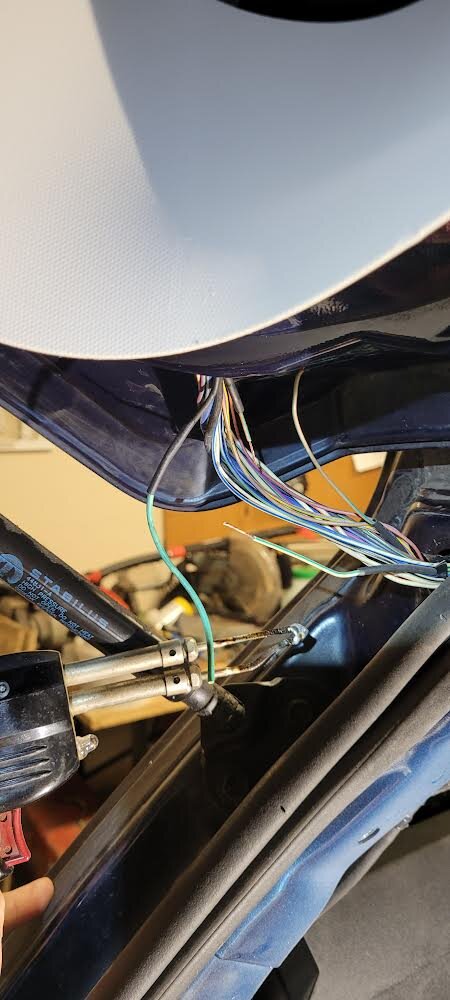

Another person with broken wires in the hatch harness.  Lost the high brake light led last year and recently the remote lock switch on the hatch close to latch handle.  Slit the boot and get out the heat shrink, solder,flux, soldering iron and tye wraps.
Found two severed wires and one cracked soon to fail wire.  Around an hours work if you can solder. About $5 in materials.
