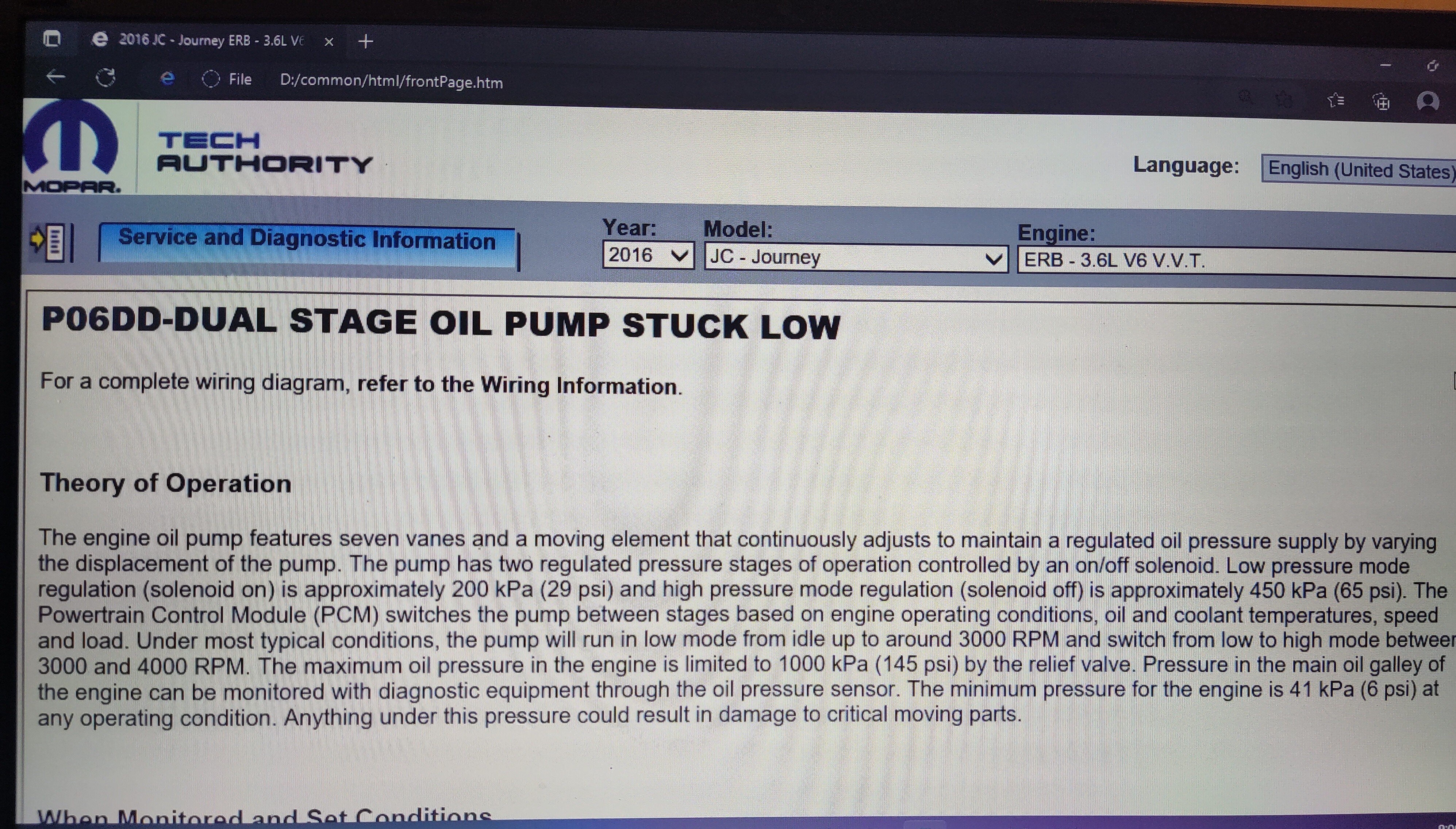

P06DD-DUAL STAGE OIL PUMP STUCK LOW
I am reading from the Mopar 2016 Dodge Journey service CD.
The oil pump runs in 2 modes controlled by the PCM.
Low pressure is Idle speed to around 3000 rpm.
High pressure mode comes on between 3000 to 4000 engine rpms.
Code P066DD dual stage oil pump stuck low (mode).

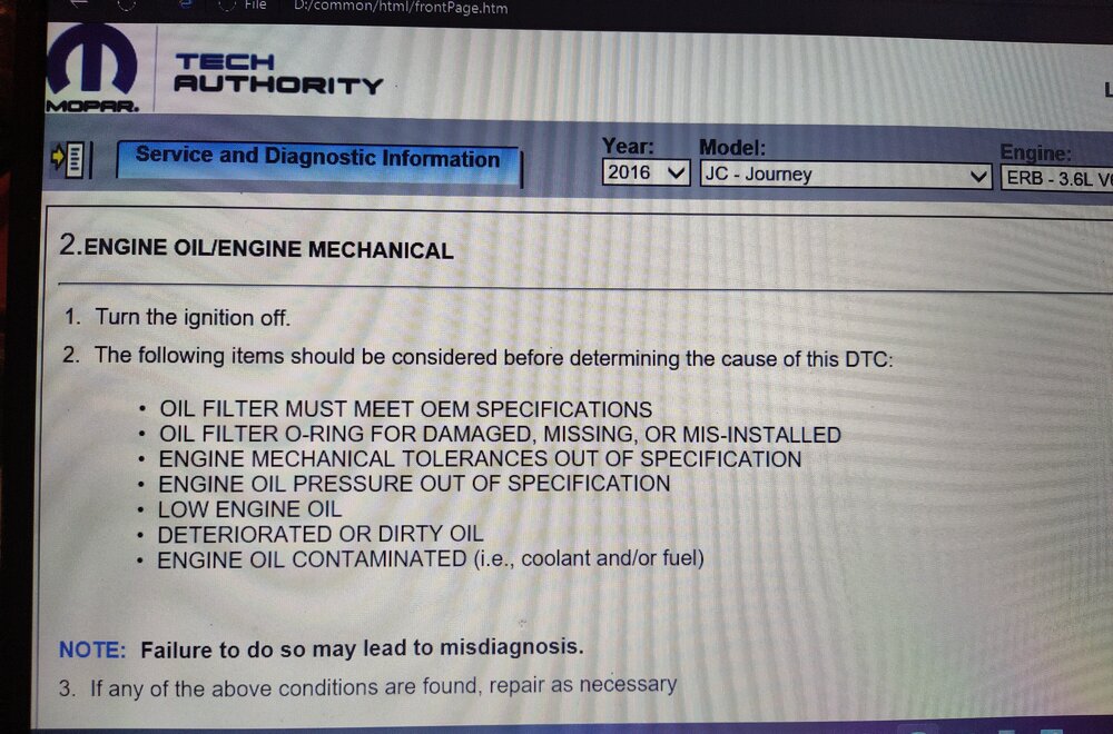

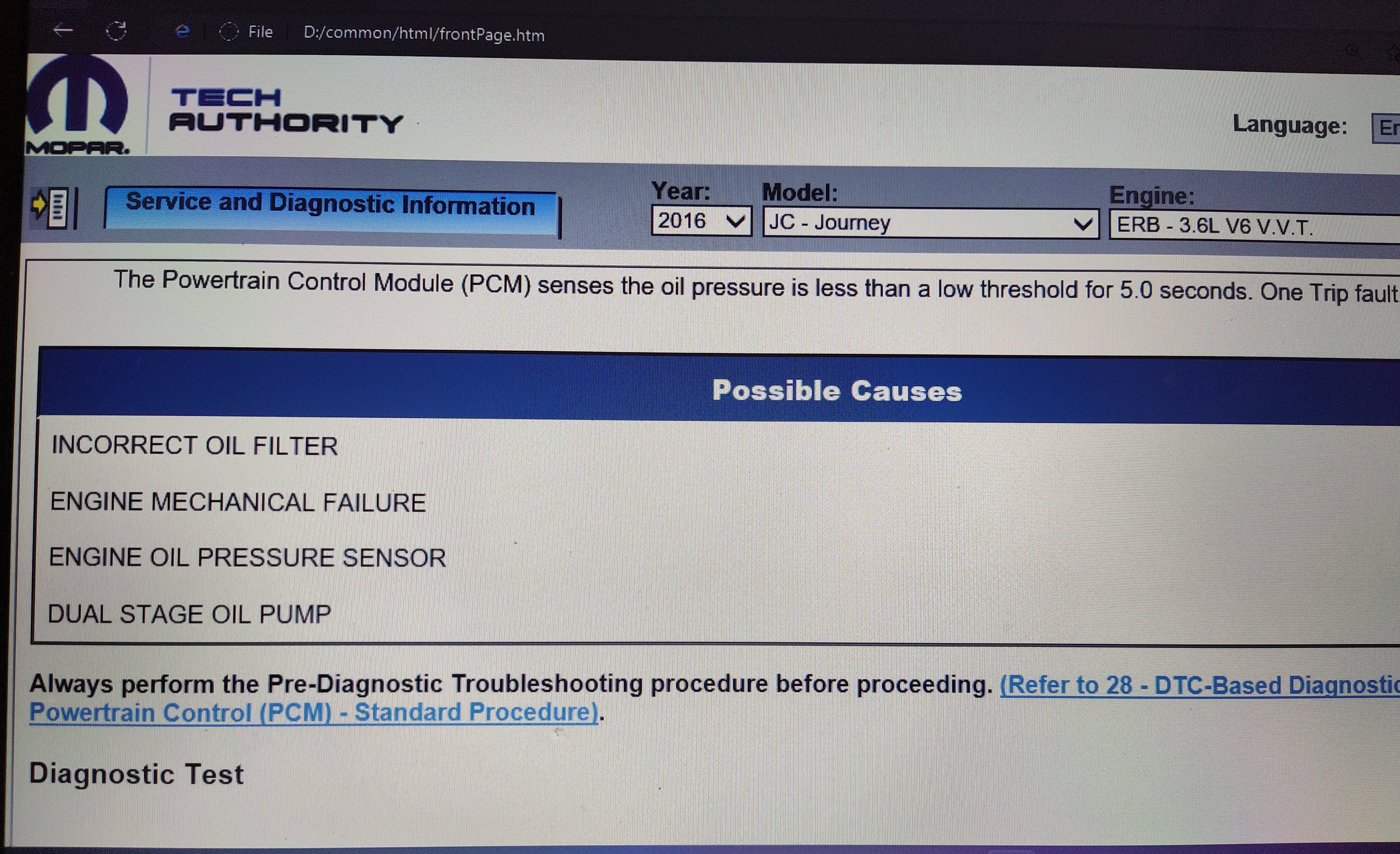

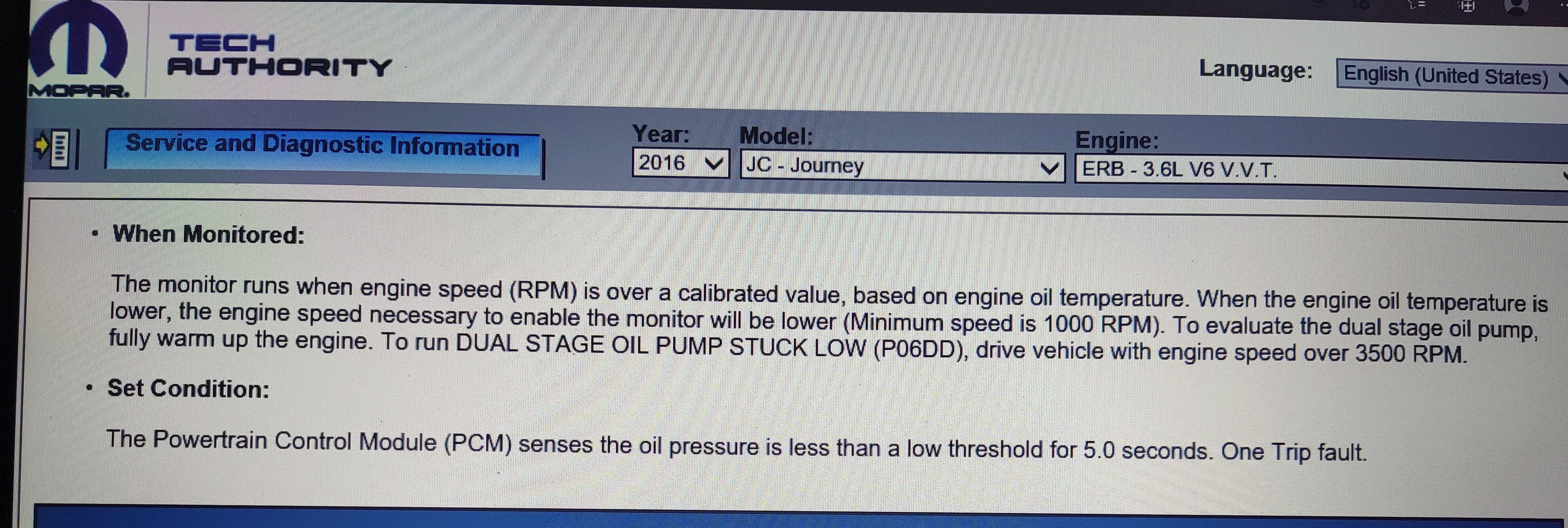

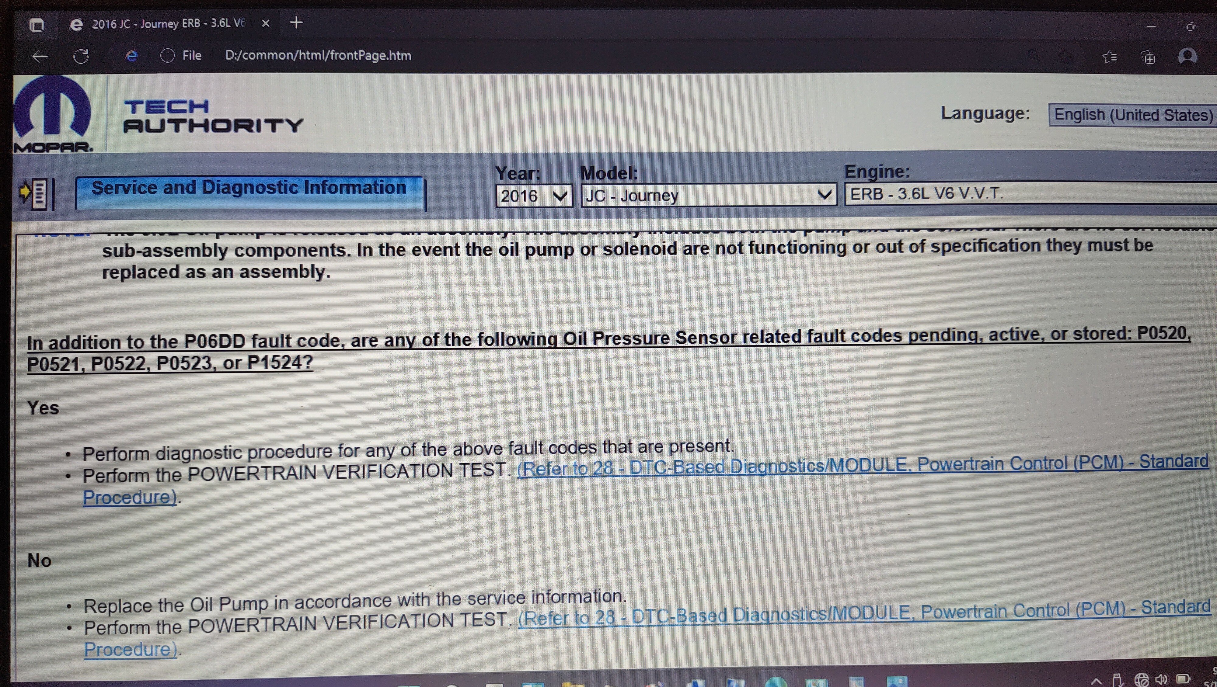

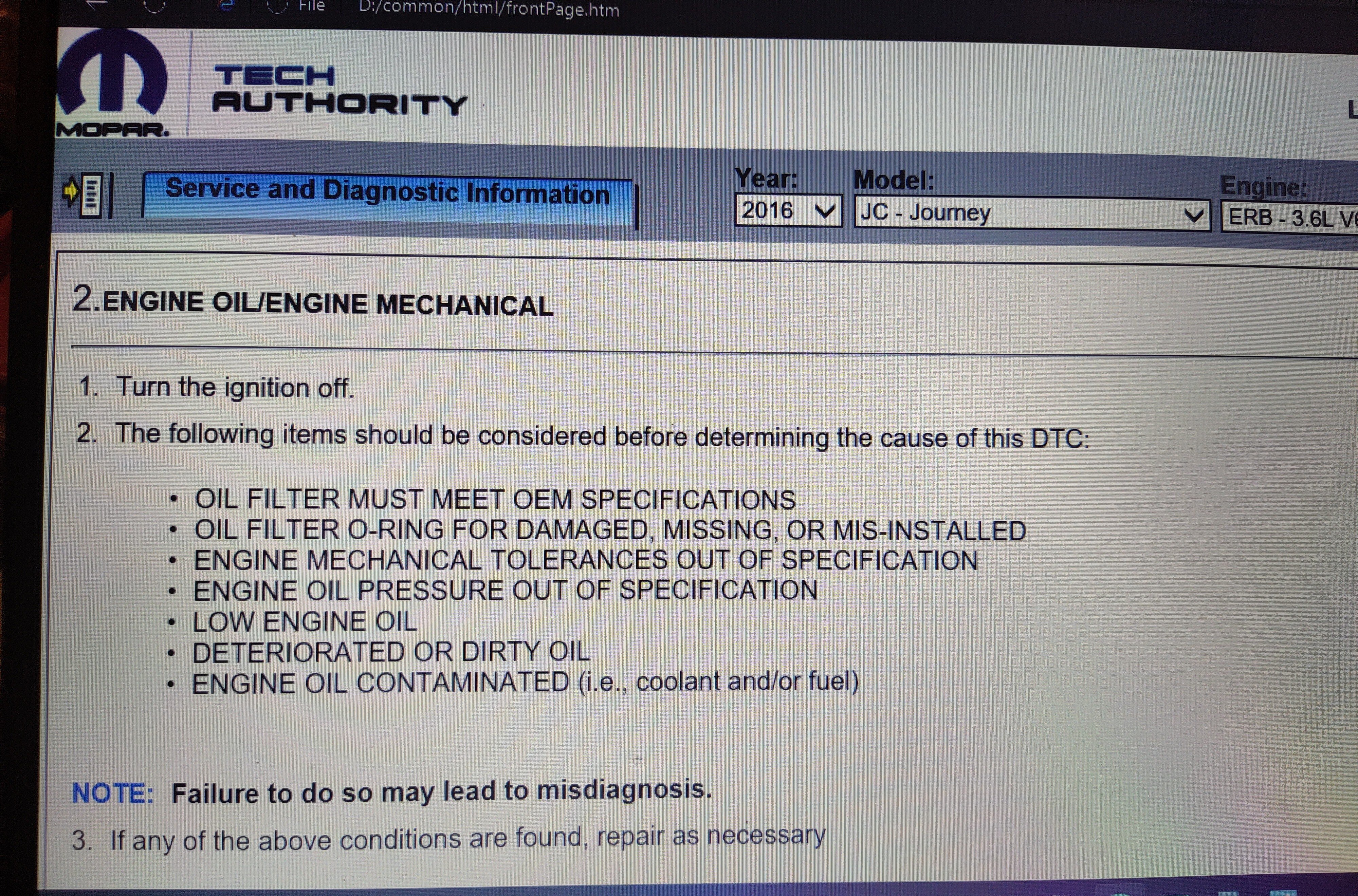

I am posting photos of the Dodge diagnostic trouble-shooting chart. For this code.
Note photos on the next post.
Based on your information and what the Service CD states. You need a new engine oil pump.
