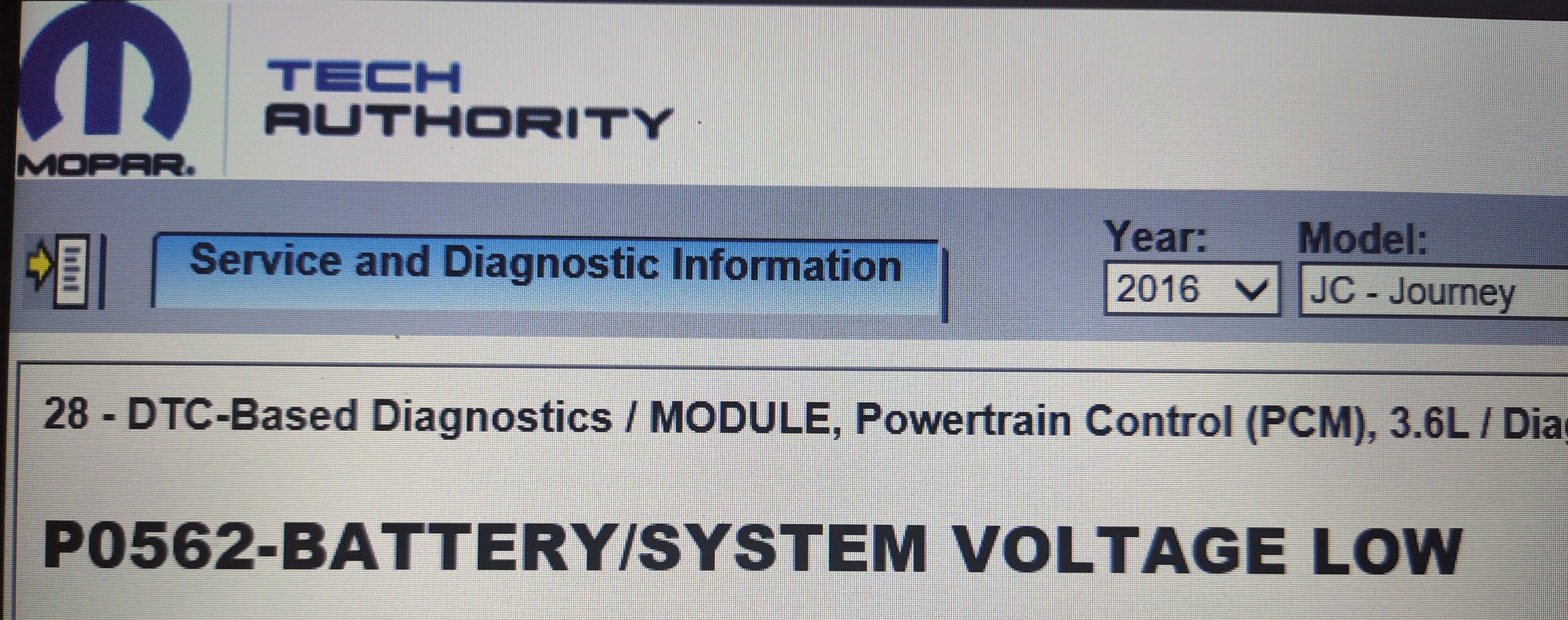

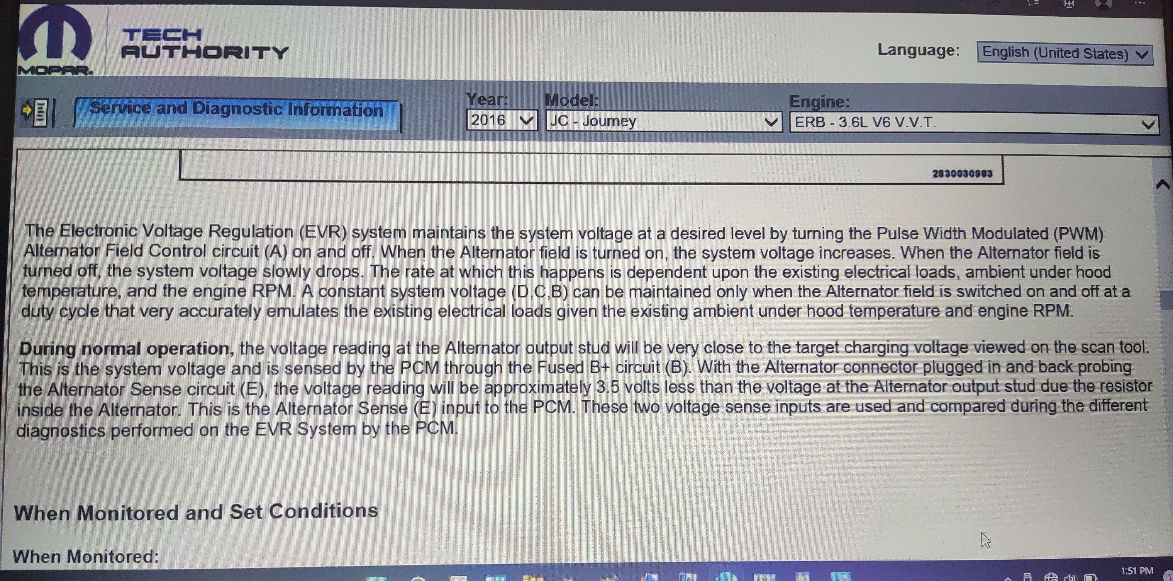

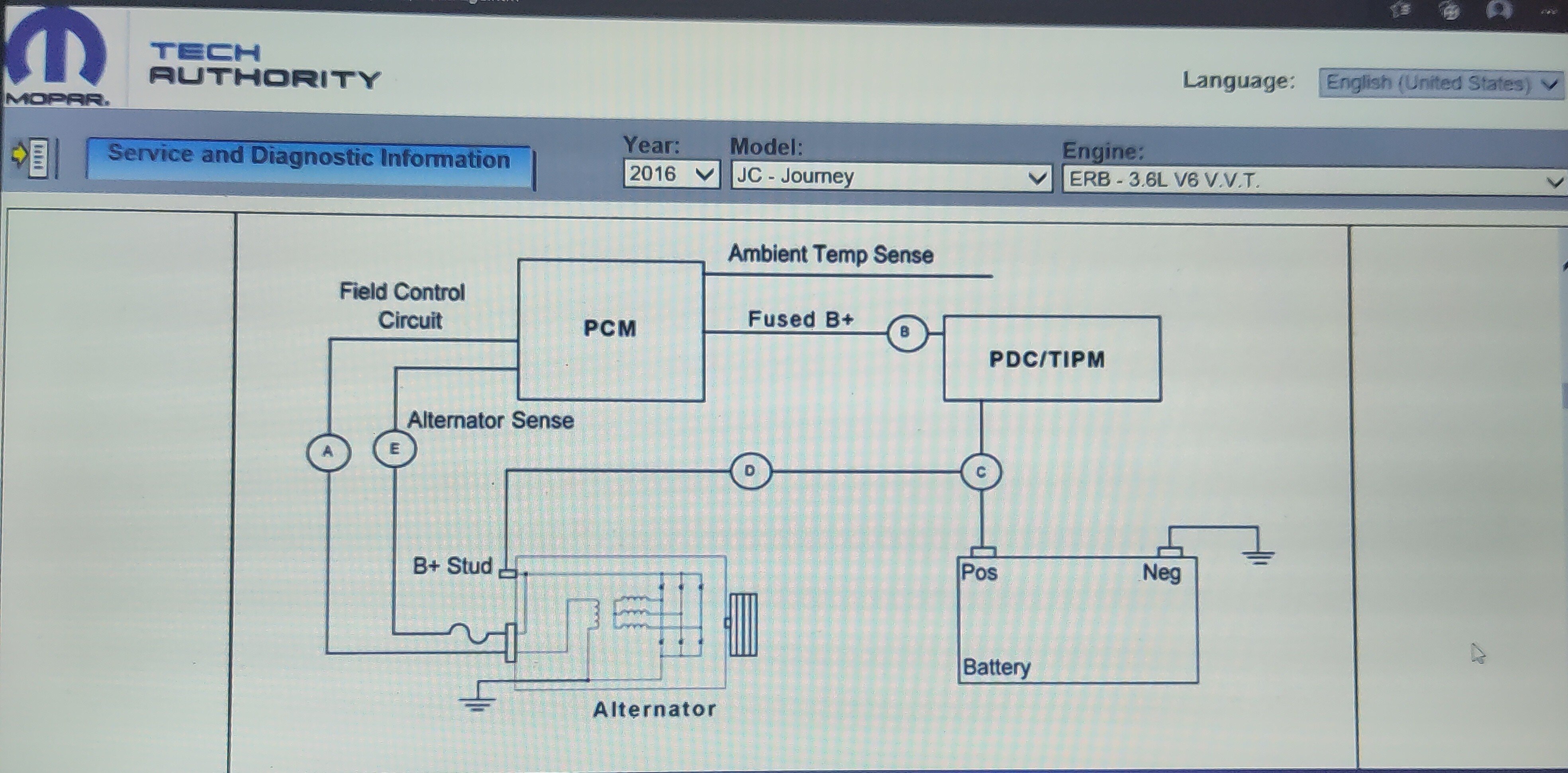

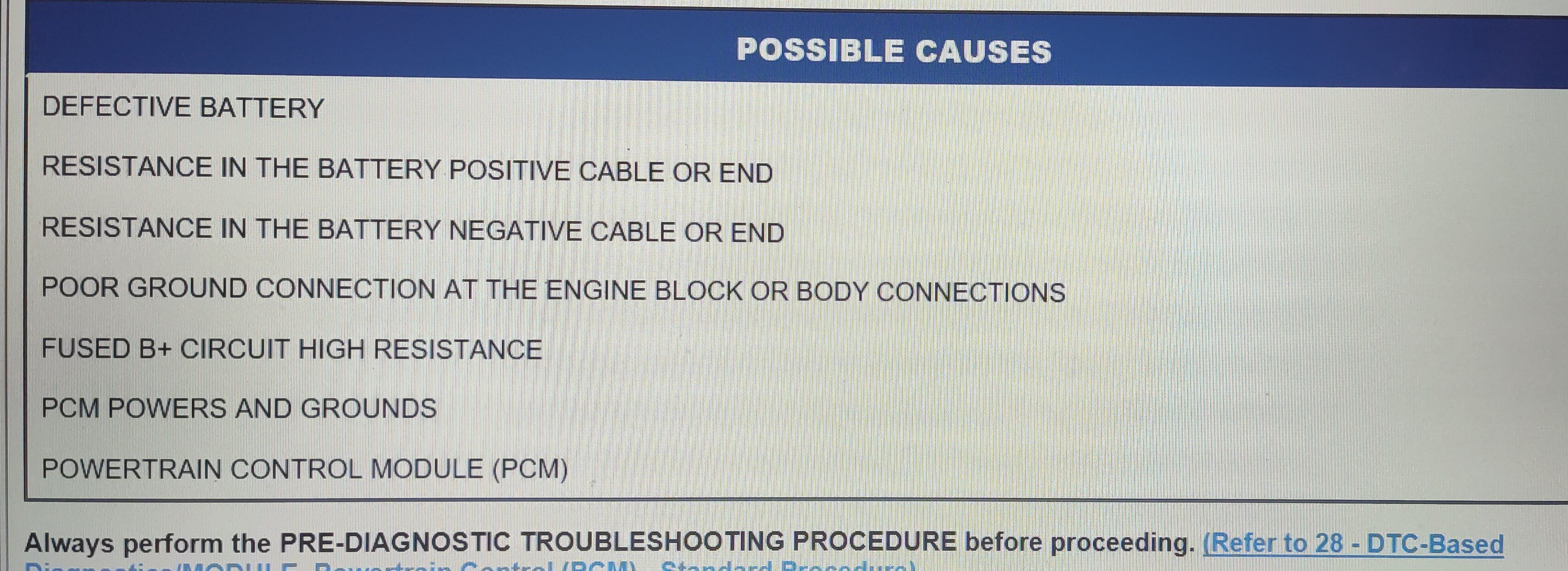

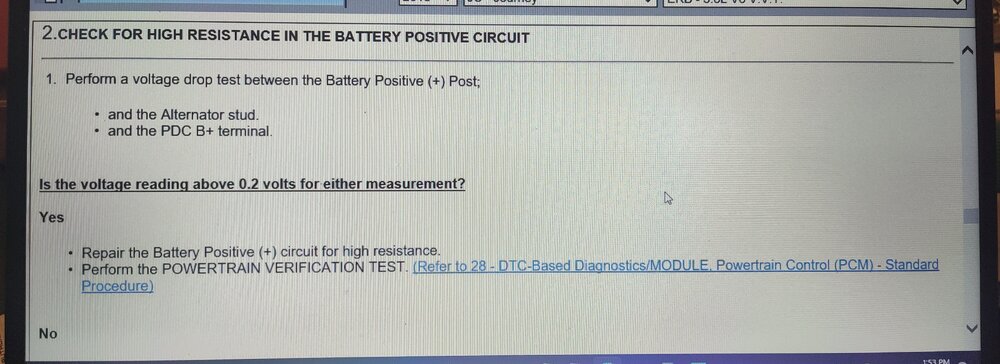

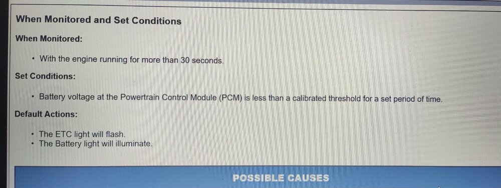

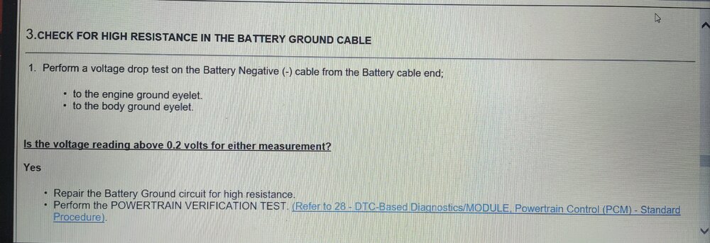

Dean H Posted May 17, 2024 Report Share Posted May 17, 2024 All pictures from Dodge 2016 service dvd. Will be in 2 posts. Dontbesojumpy 1 Quote Link to comment Share on other sites More sharing options...
Dean H Posted May 17, 2024 Report Share Posted May 17, 2024 (edited) part 2 service CD. P0562. The photos are out of order. Read possible causes. Then read from the bottom up. Simplified: check your battery first. All battery connections and Cables. Edited May 17, 2024 by Dean H Dontbesojumpy 1 Quote Link to comment Share on other sites More sharing options...

Dontbesojumpy Posted May 20, 2024 Author Report Share Posted May 20, 2024 On 5/17/2024 at 6:14 PM, Dean H said: part 2 service CD. P0562. The photos are out of order. Read possible causes. Then read from the bottom up. Simplified: check your battery first. All battery connections and Cables. Expand Oh wow, thank you for this--this was really helpful. I followed ya'll's advice, pulled the battery and took it to someone with no stakes in selling me a new battery. She showed me how it held a charge but wasn't healthy enough for what the car demanded (sounds familiar huh??) and send me down the right path. The only issue: Their literature showed that my vehicle took a Group 26 Battery, not a Group 86 as was replaced. Everything except for the physical size of the battery was the exact same as the battery being replaced--a total 1:1--Cold Cranking Amps, Voltage, term. post location/orientation and fitment were all A-OK, too--the compartment space limitations was a consideration... I will be overjoyed if a simple battery swap resolves all the issues--I could use the win. Quote Link to comment Share on other sites More sharing options...
