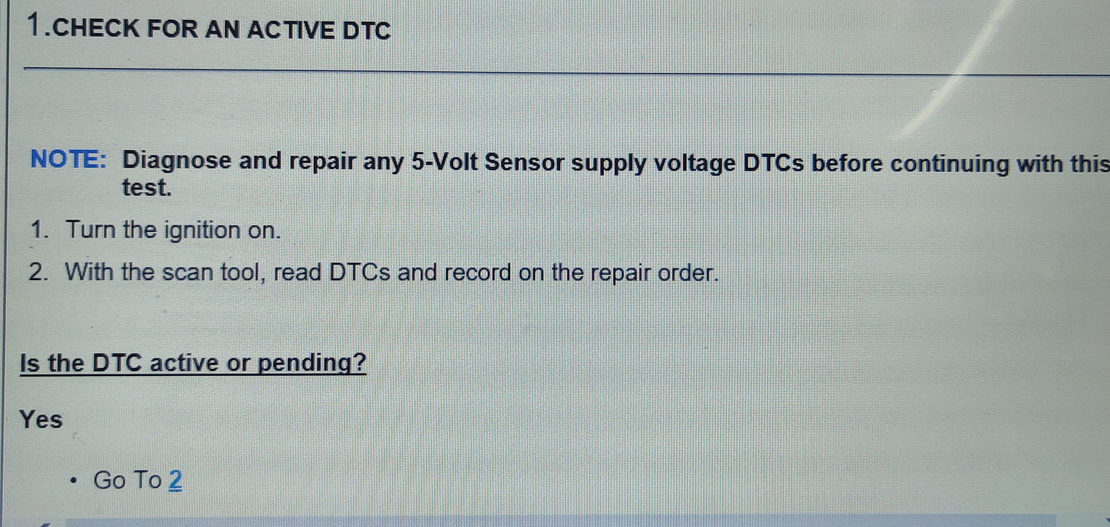

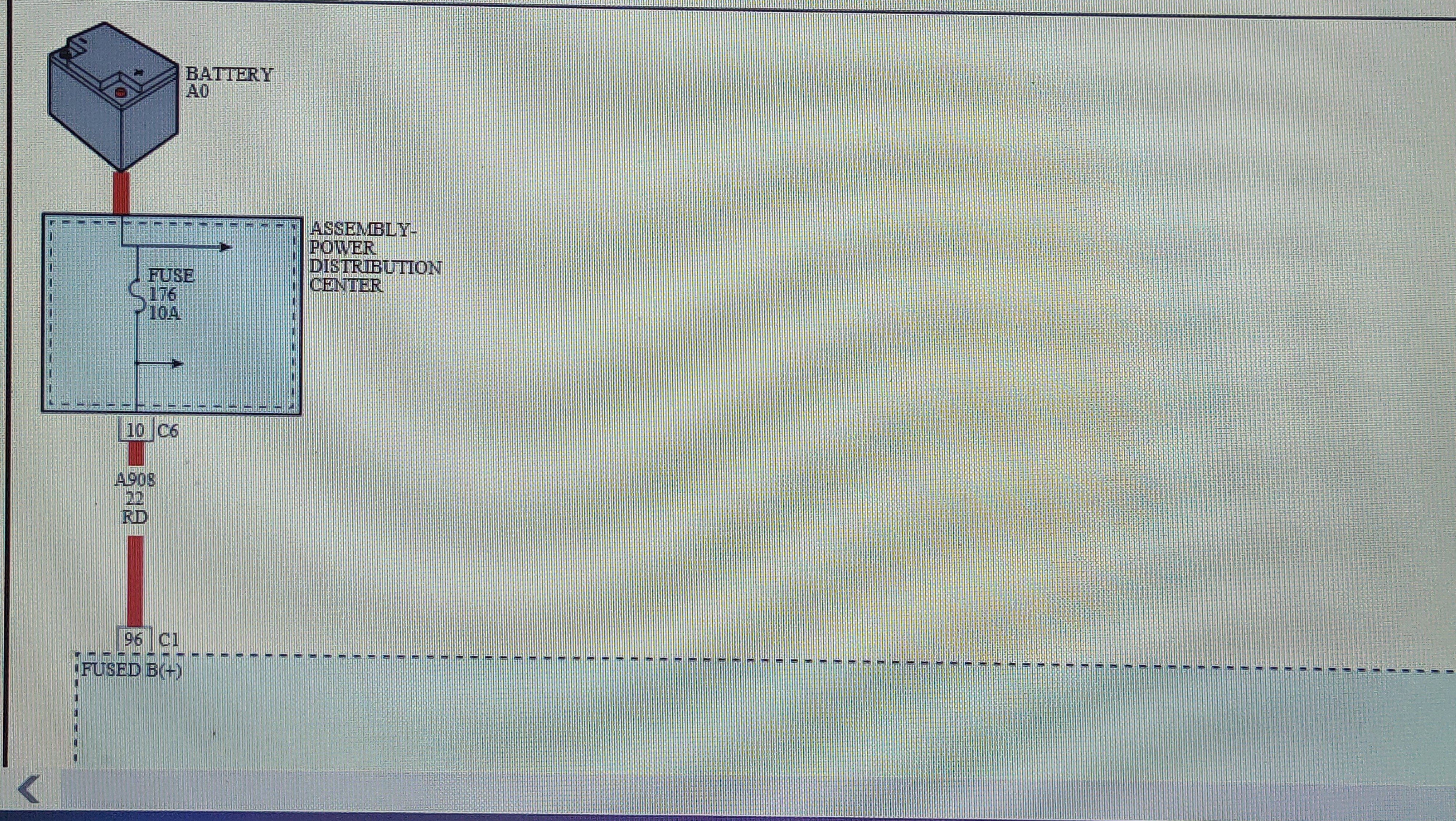

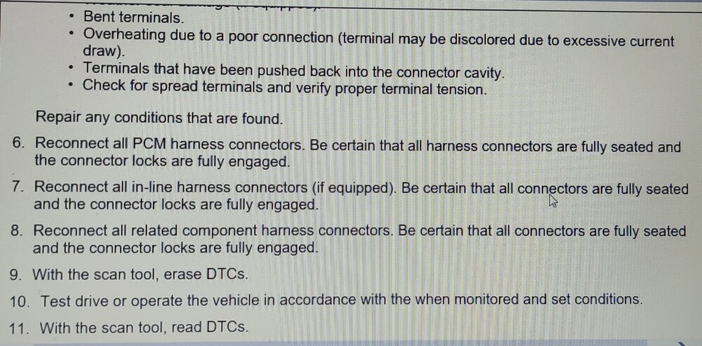

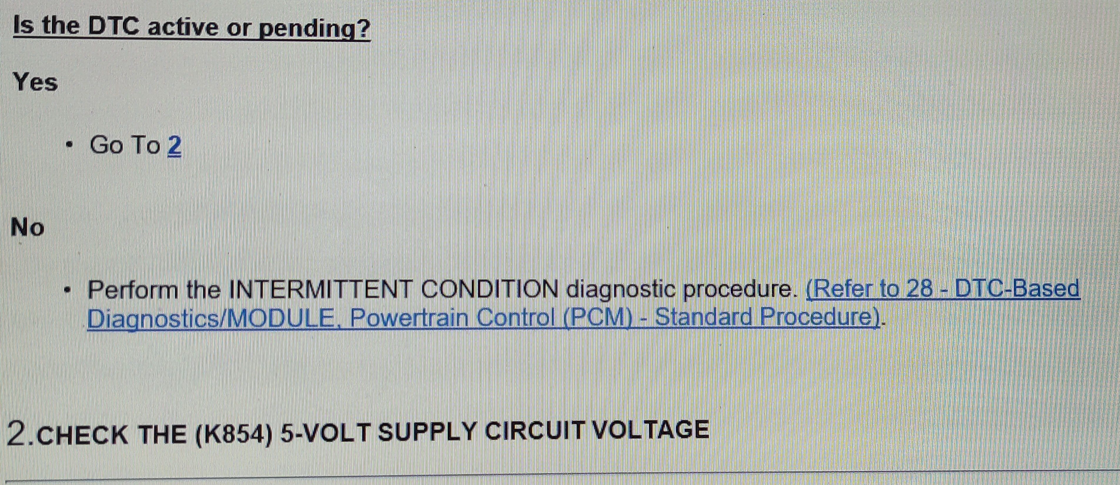

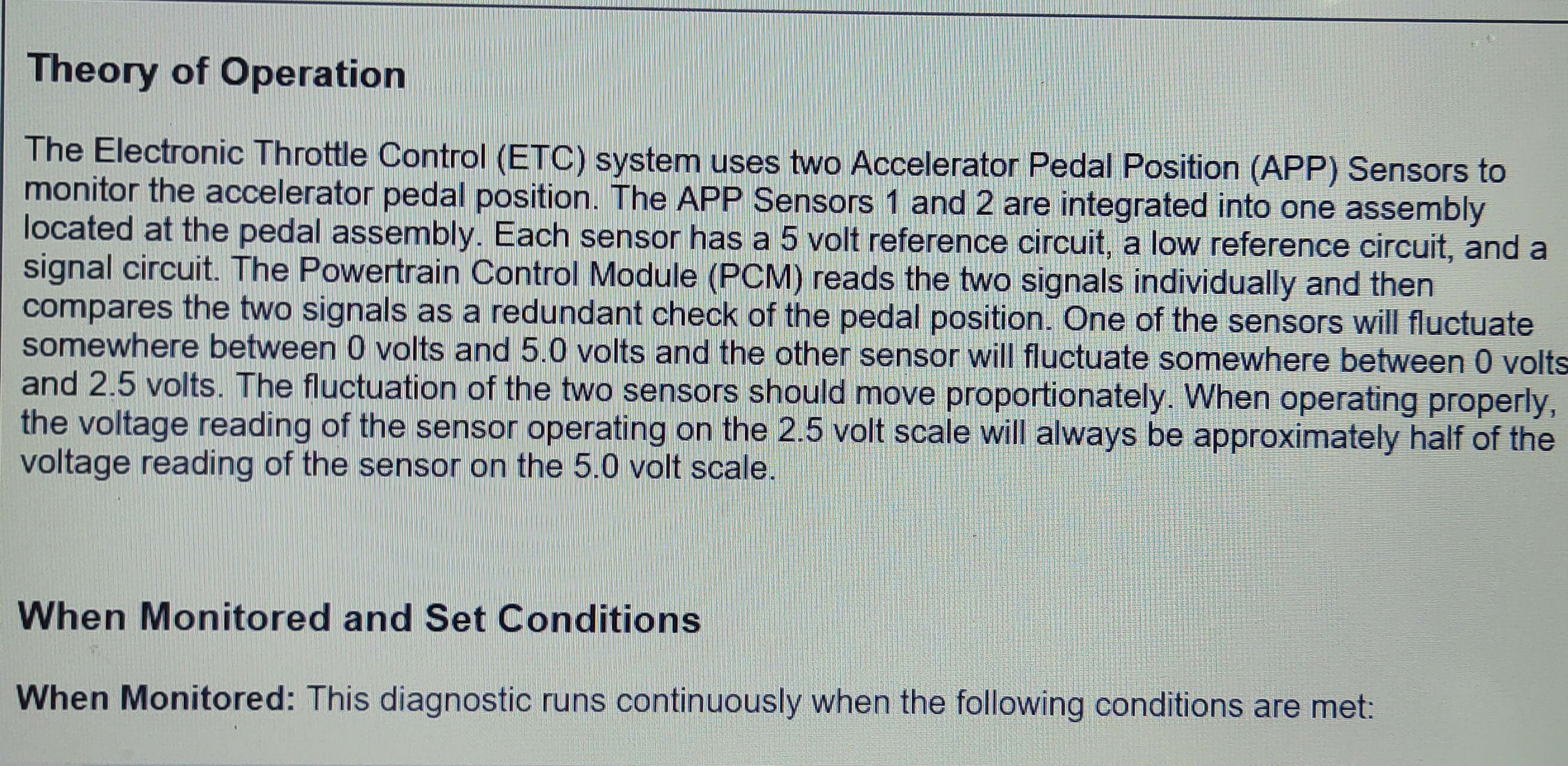

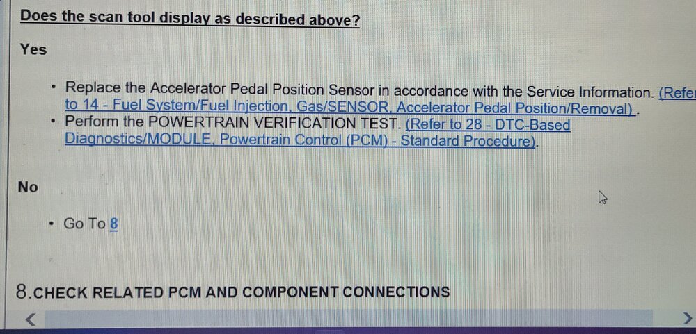

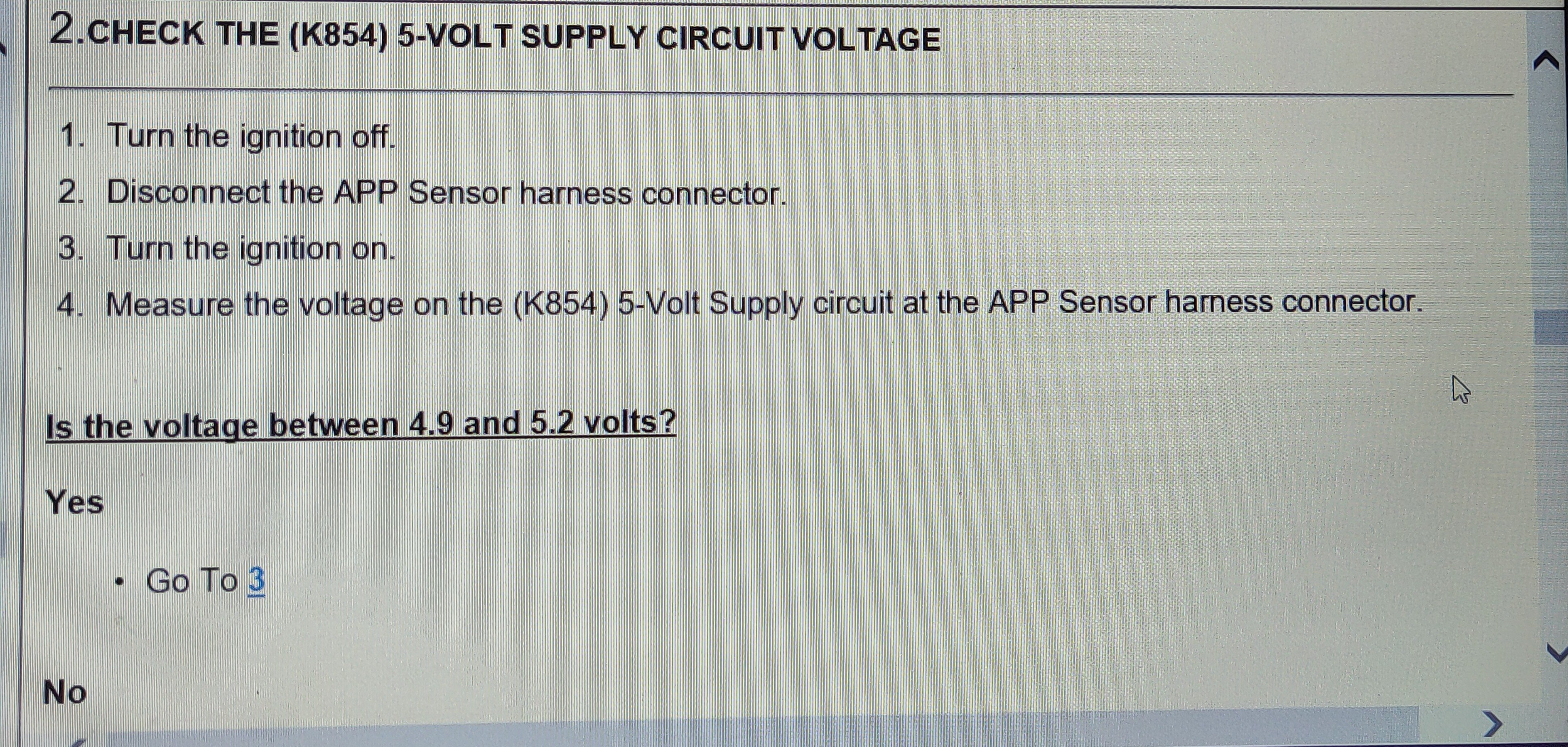

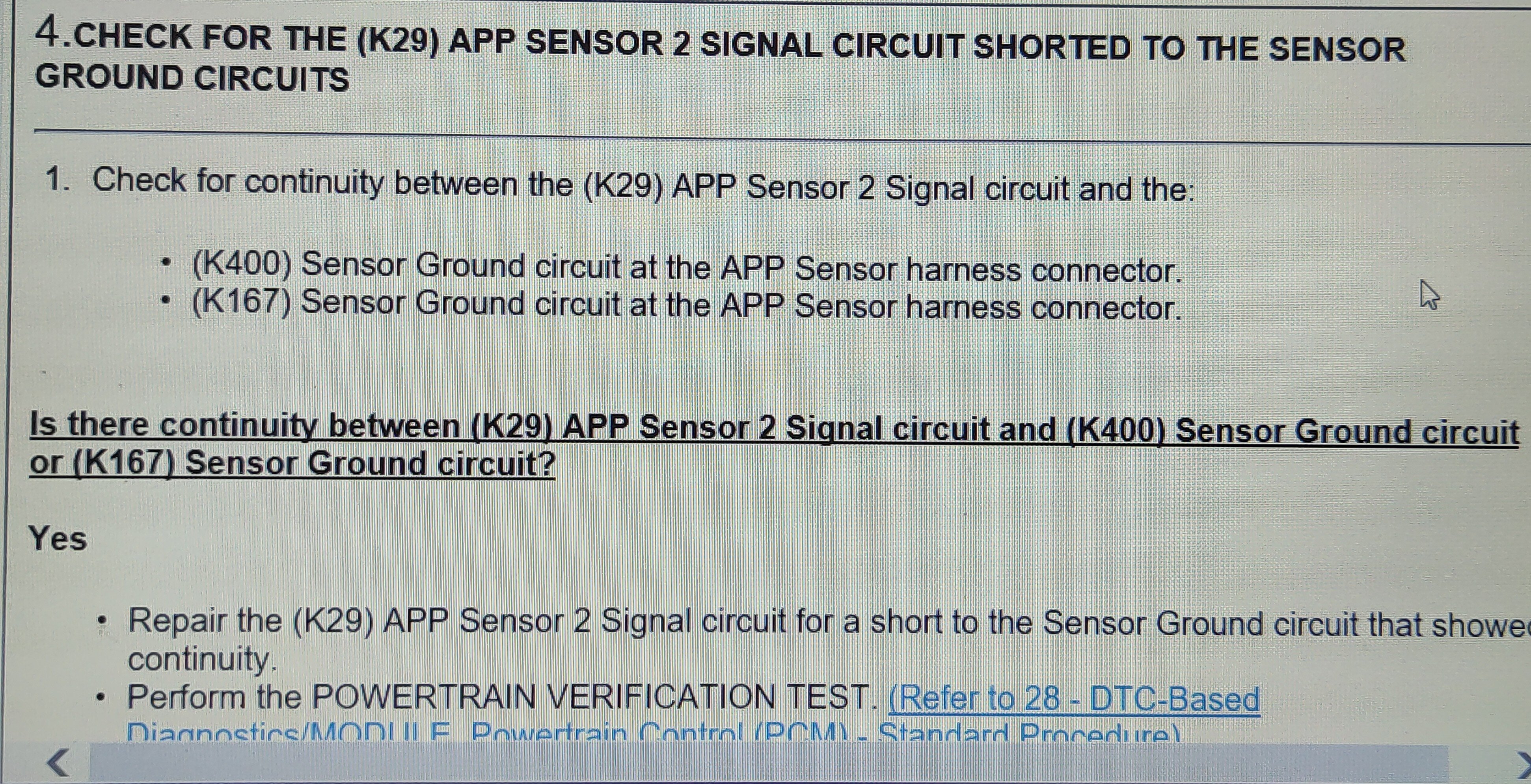

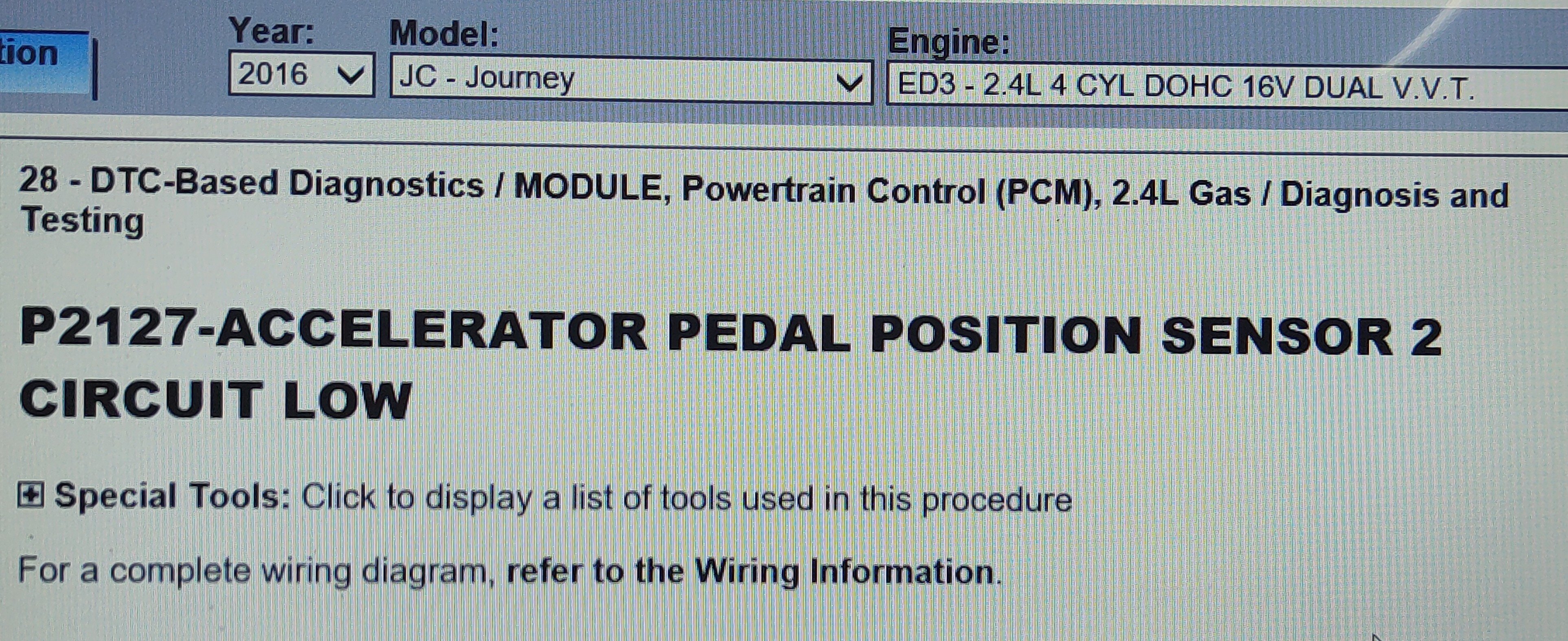

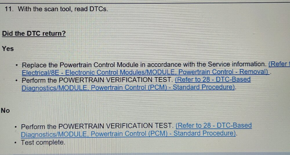

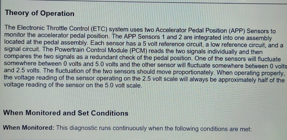

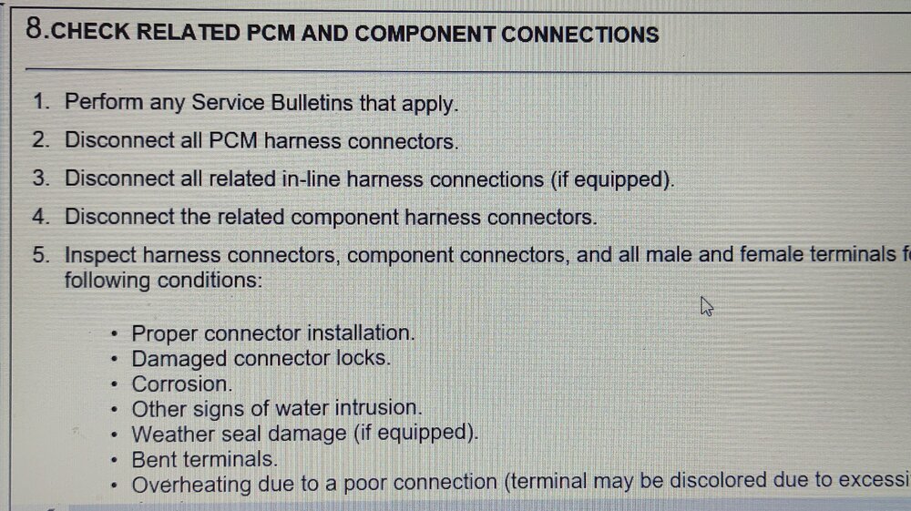

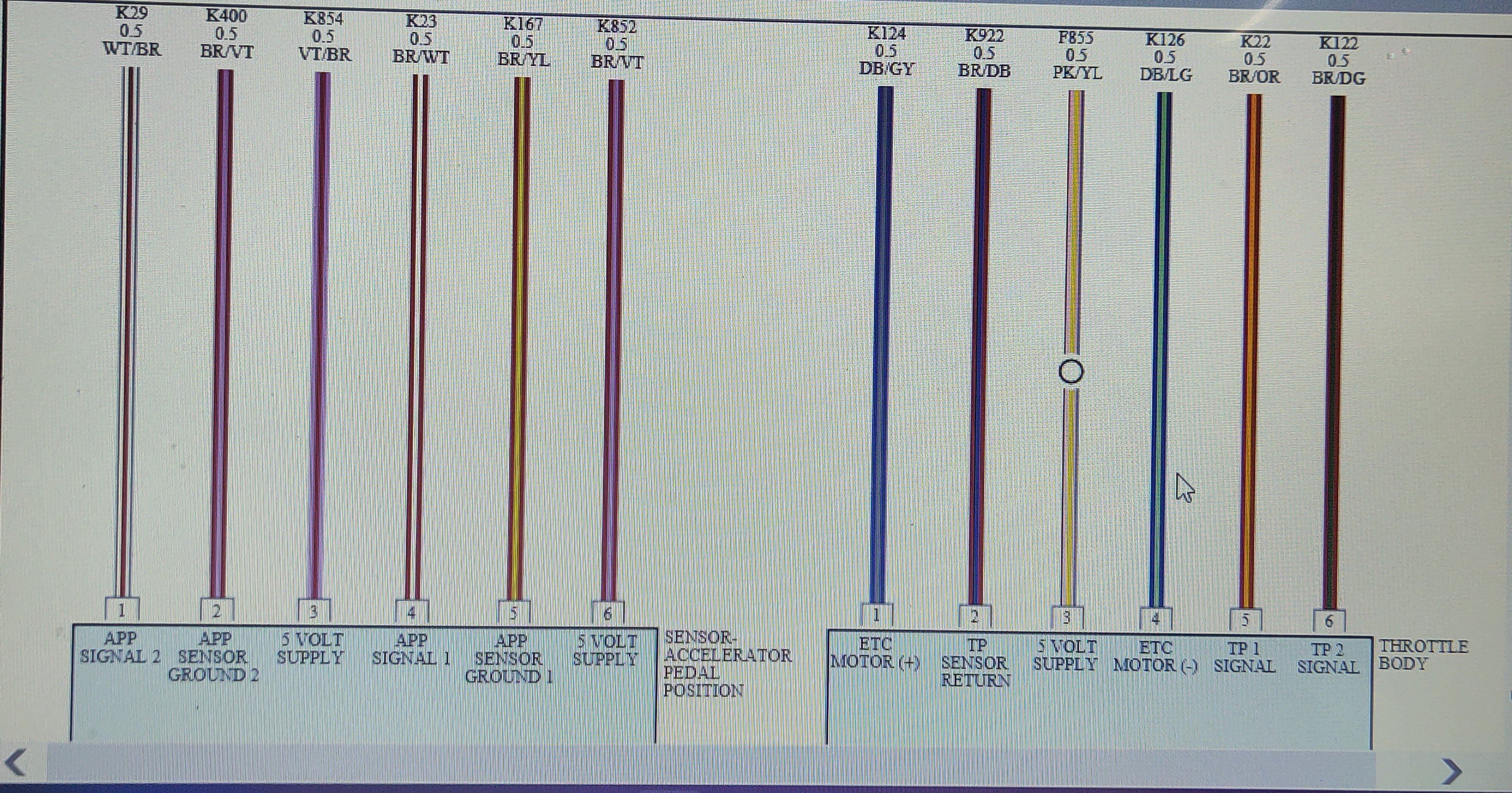

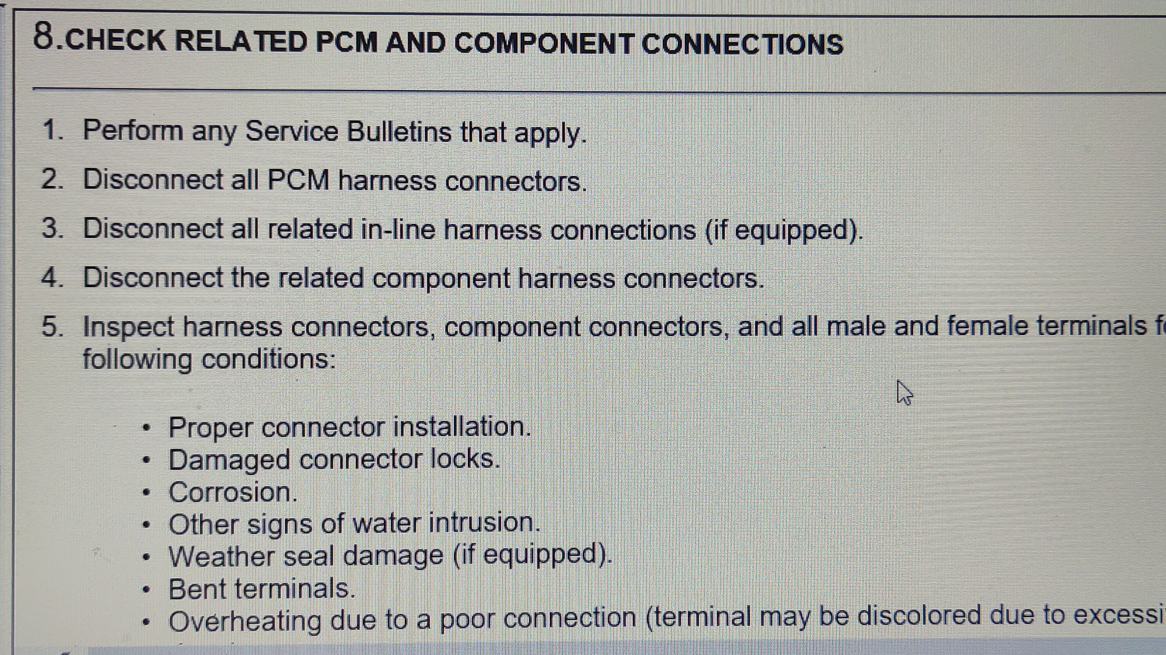

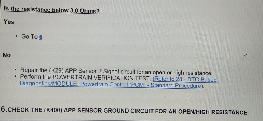

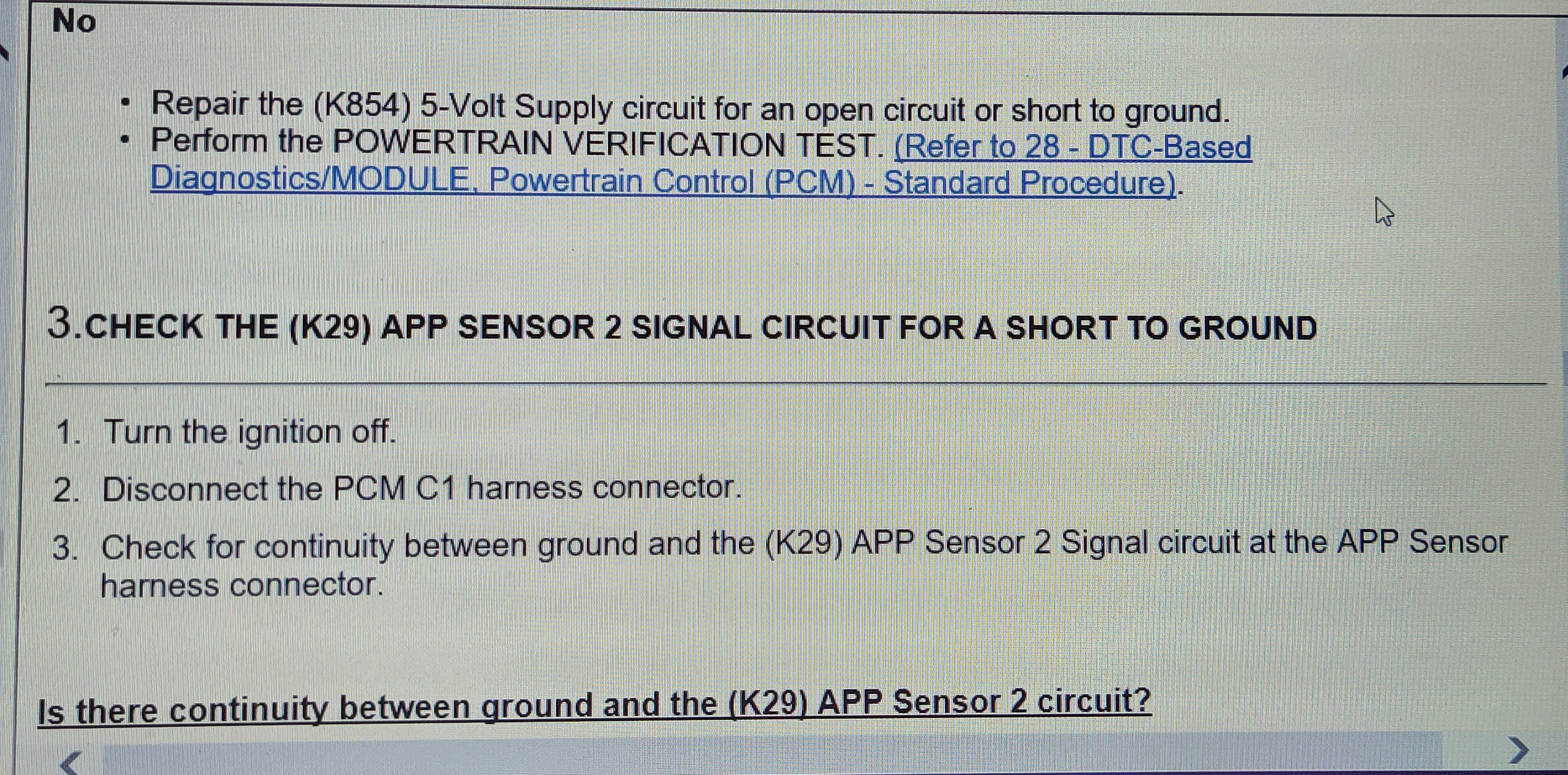

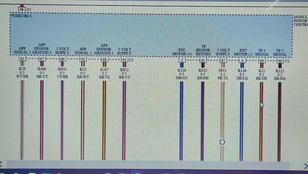

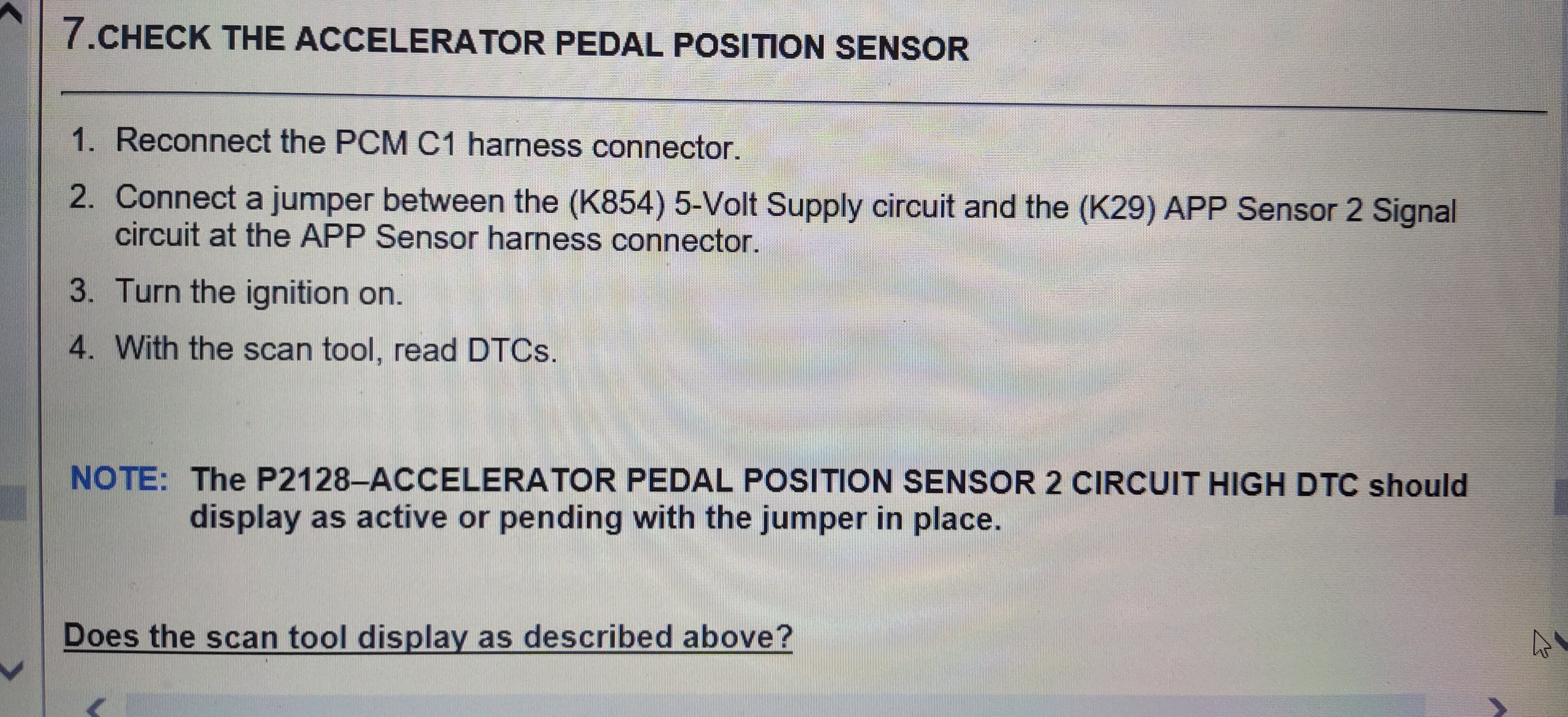

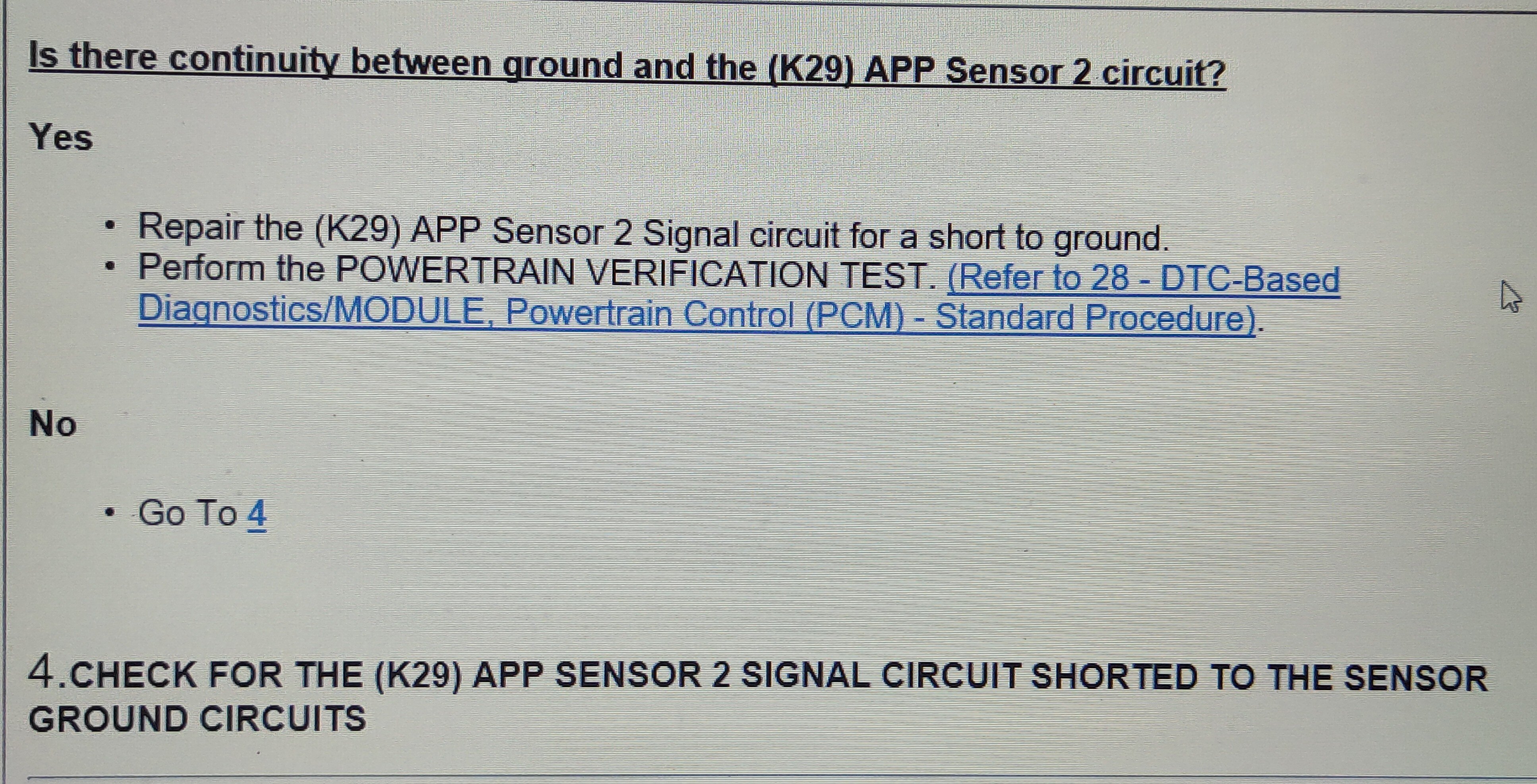

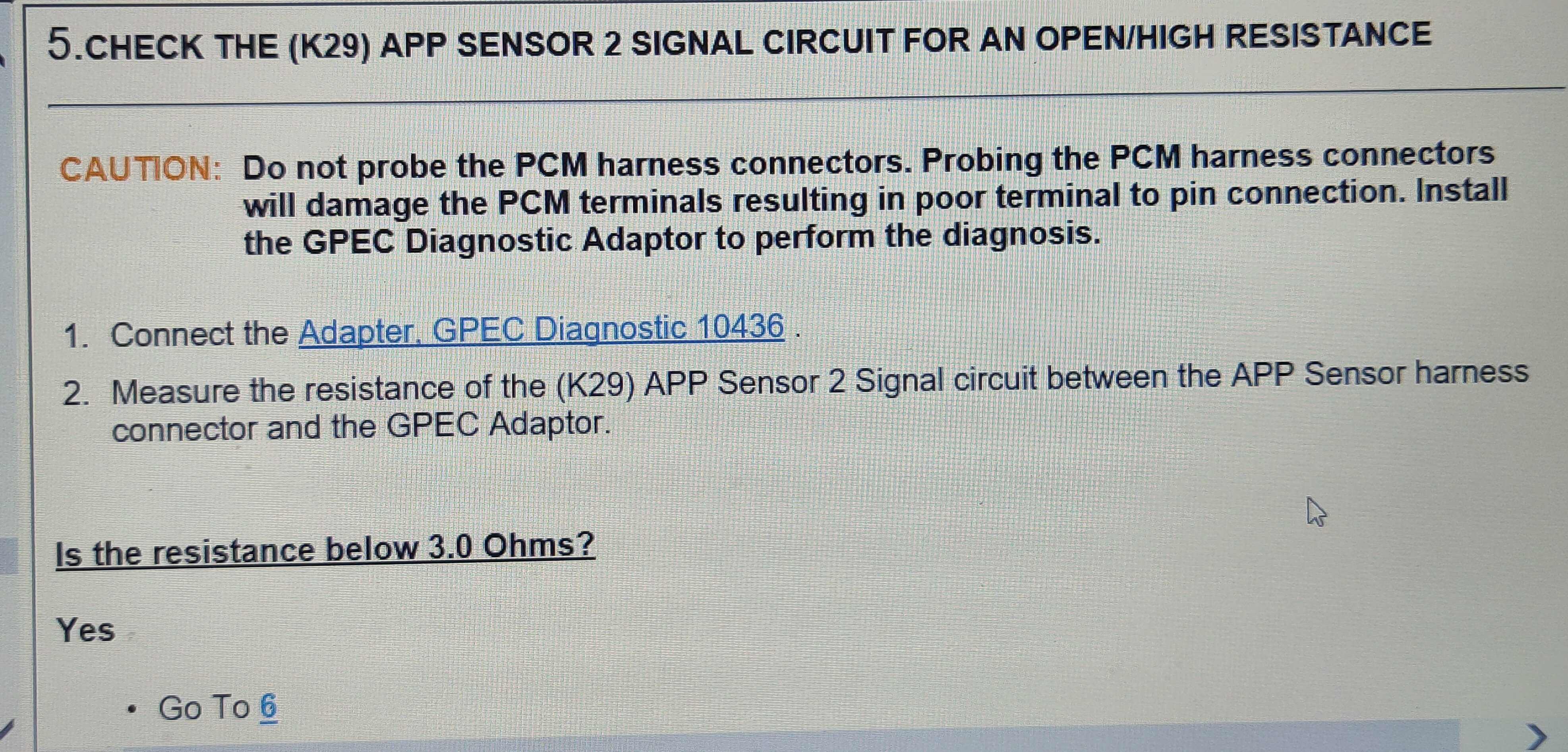

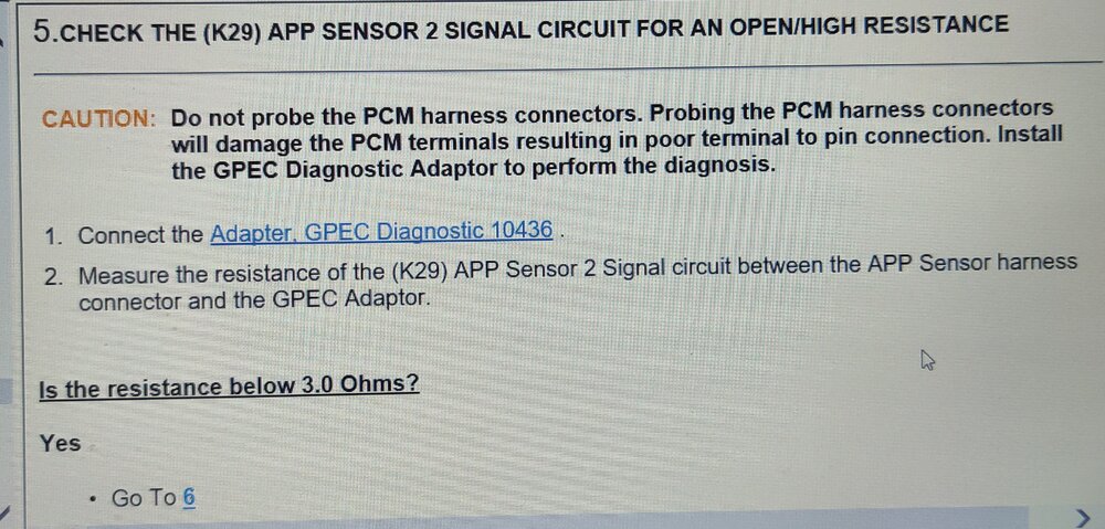

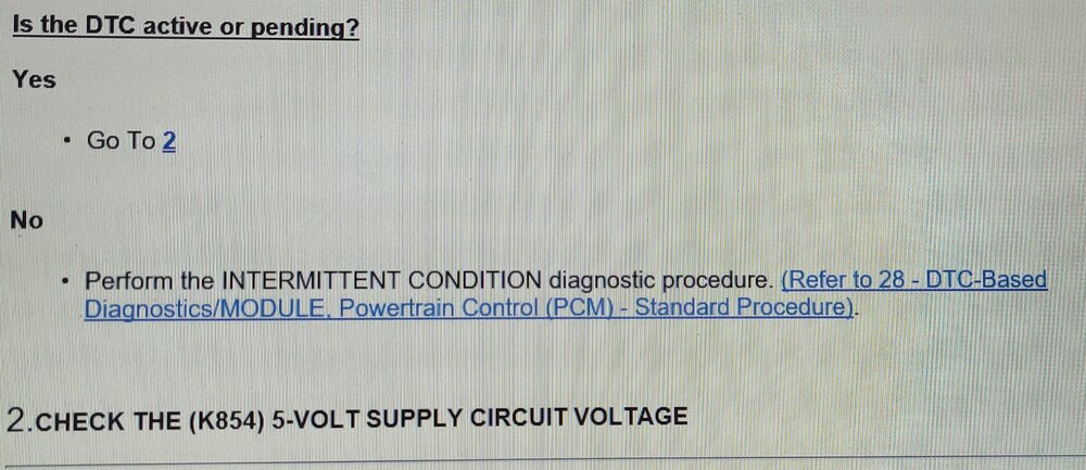

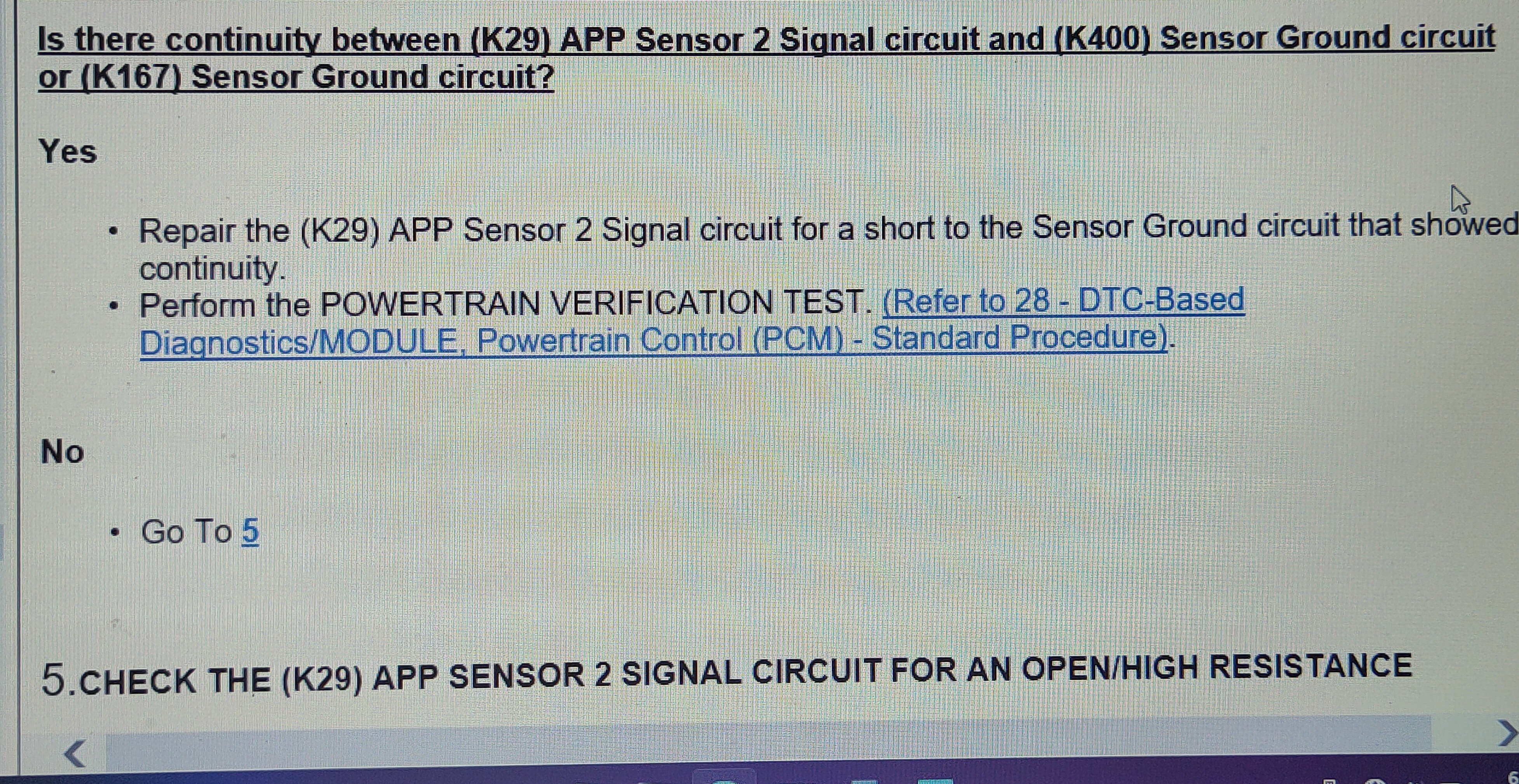

Dean H Posted May 23 Report Share Posted May 23 First thing on a Journey. A known good and tested battery. When replacing the gas pedal, did you use the scan tool? There is a apps relearn function required. Quote Link to comment Share on other sites More sharing options...
Dean H Posted May 23 Report Share Posted May 23 Quote Link to comment Share on other sites More sharing options...

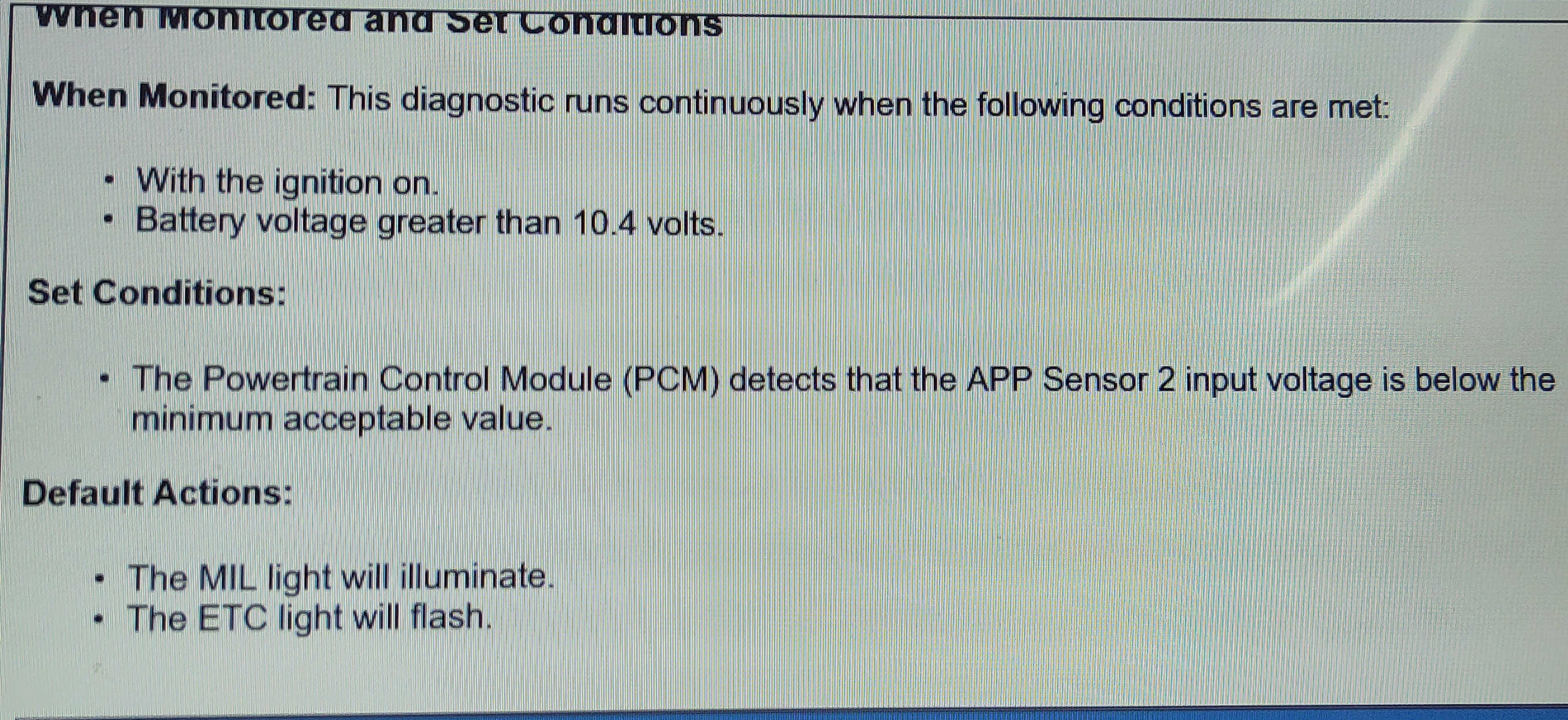

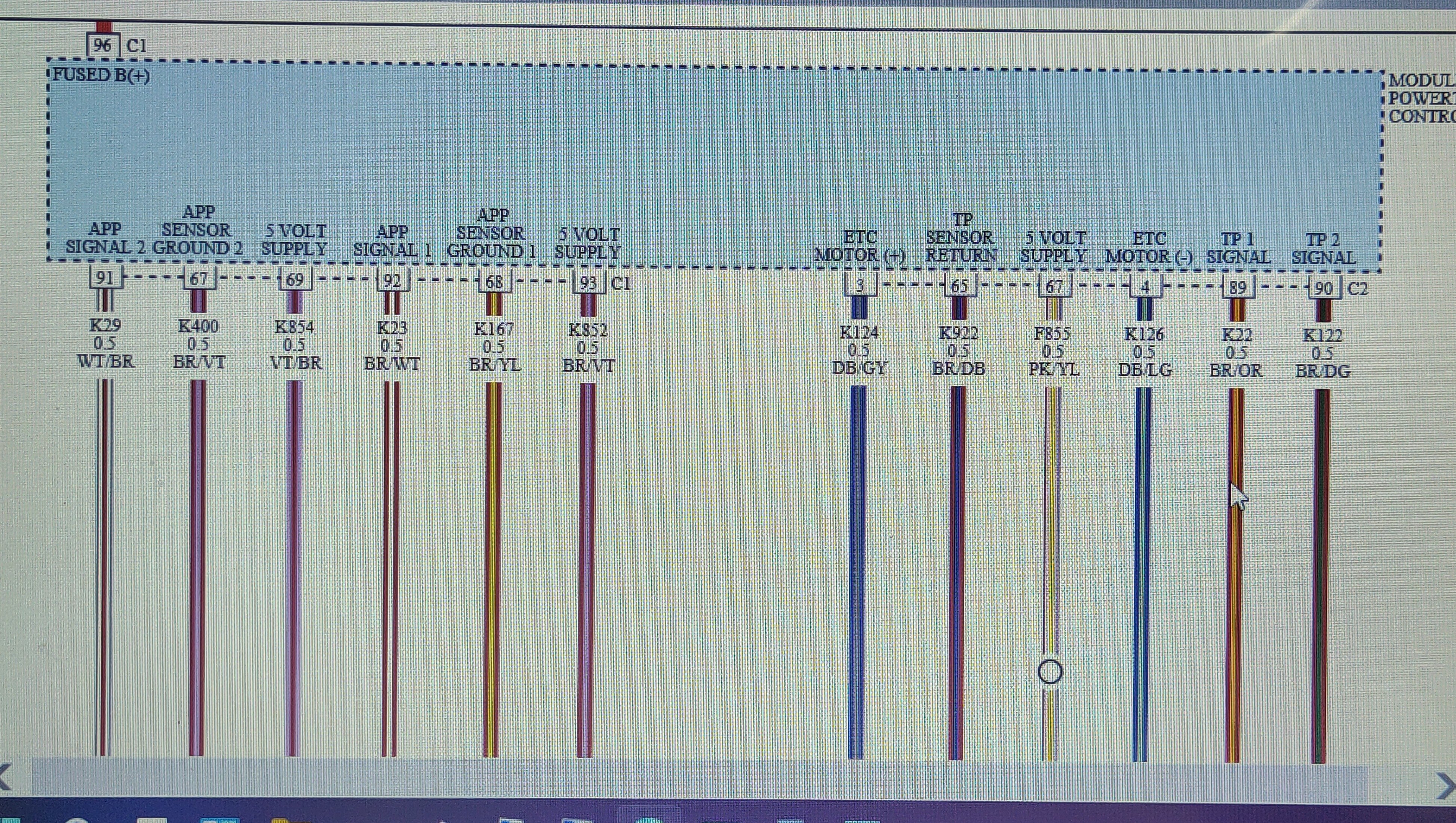

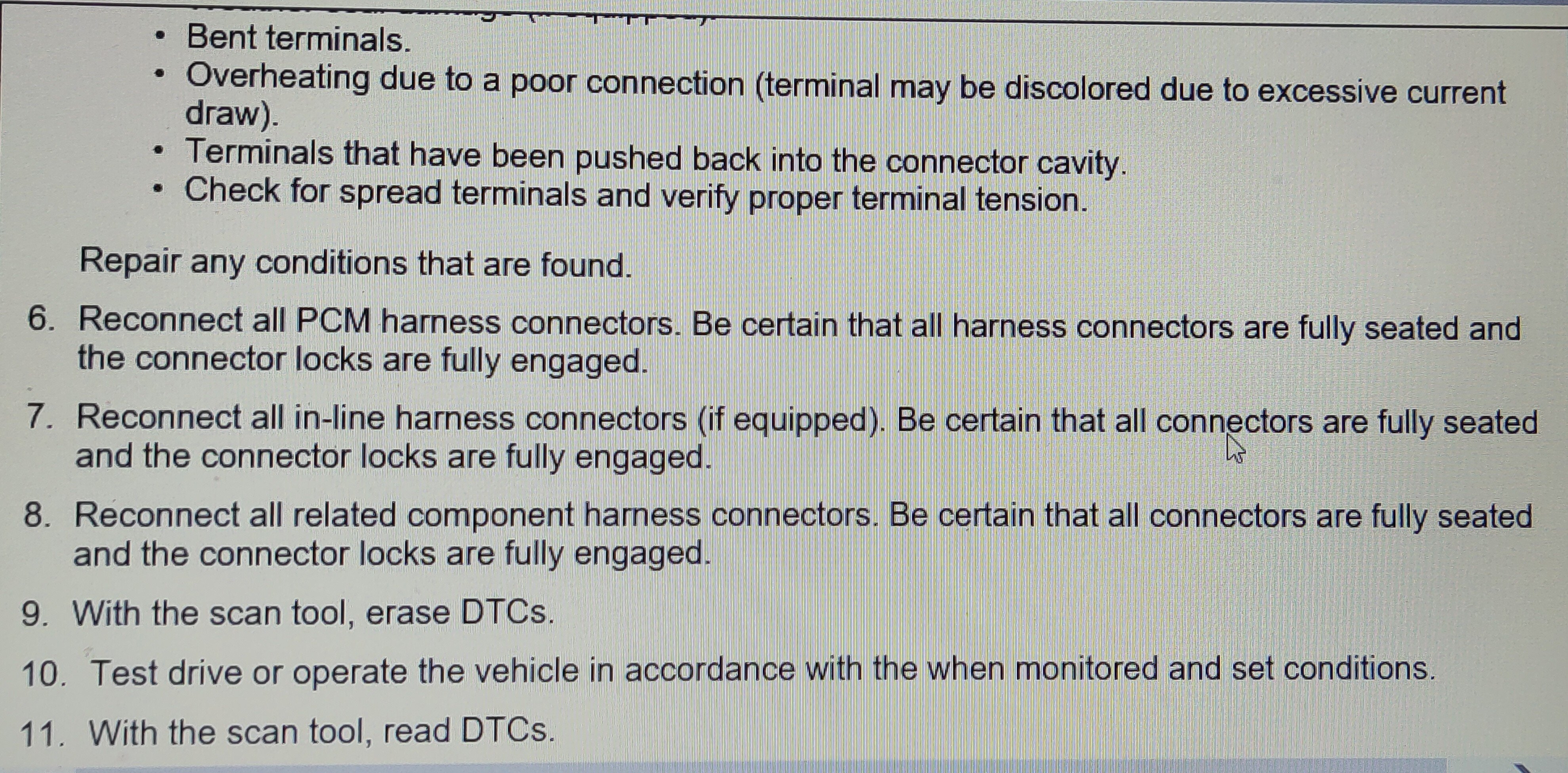

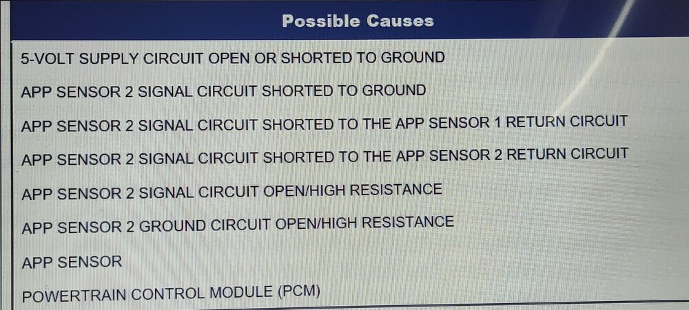

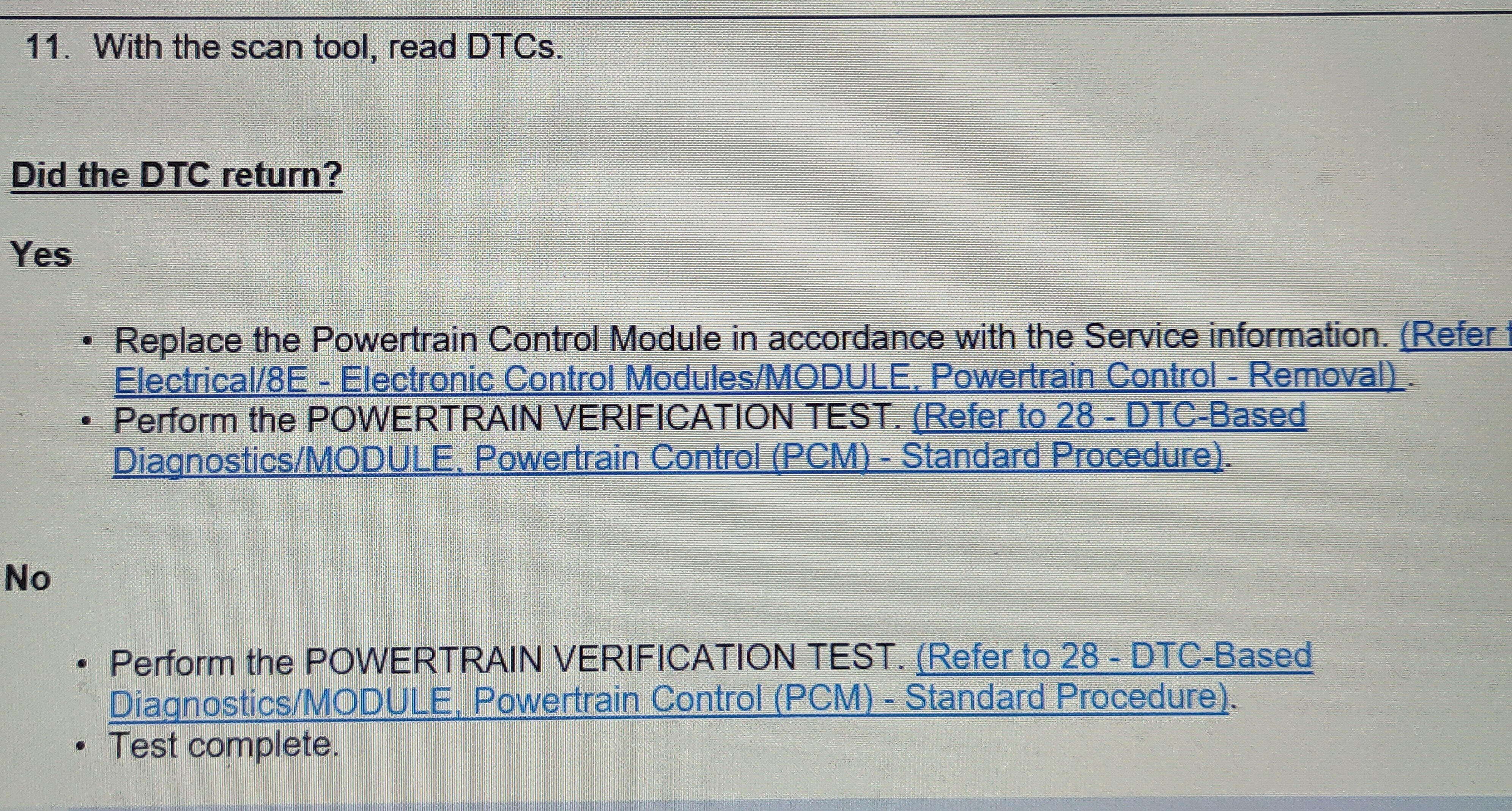

Dean H Posted May 23 Report Share Posted May 23 Thank you whole foods for the WiFi. I hope this helps. Quote Link to comment Share on other sites More sharing options...

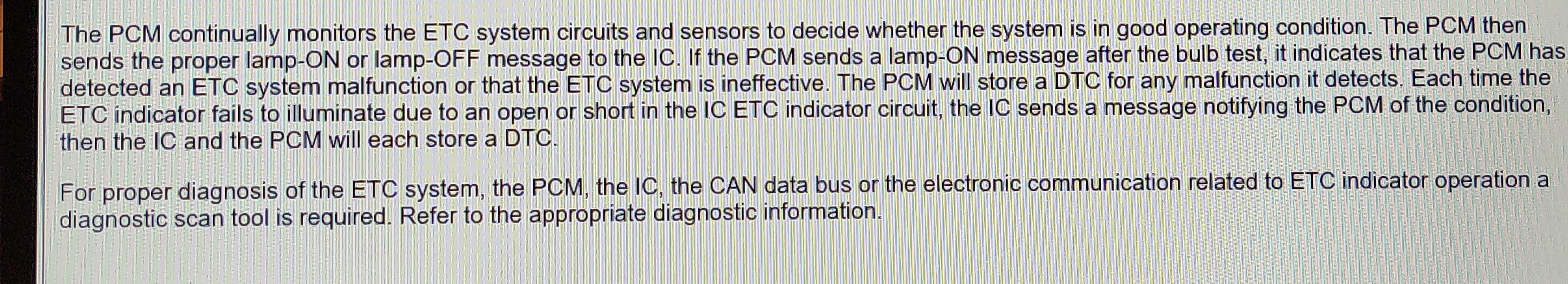

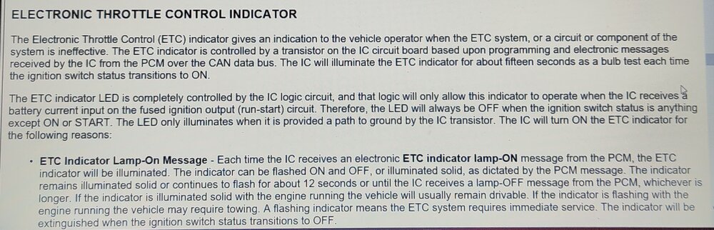

Dean H Posted May 25 Report Share Posted May 25 Hi John H. These are the specific codes in the 2016 DJ service CD. Electronic Throttle Control (ETC) lightning ⚡ bolt warning light. ETC LIGHT Illuminated --- TP sensor codes P0121, P0122, P2135 ETC codes P2110 Accelerator pedal codes P2115, P2116, P2166, P2167 ETC LIGHT FLASHES ----- TP sensor code P0123 ACCELERATOR PEDAL codes P2122, P2123, P2127, P2128, P2138 ETC LIGHT FLASHING ---- ETC codes P2100, P2101, P2107 P2111, P2112 P2118 Dean Quote Link to comment Share on other sites More sharing options...
Dean H Posted June 6 Report Share Posted June 6 This explains the ETC lightning bolt light. Quote Link to comment Share on other sites More sharing options...
