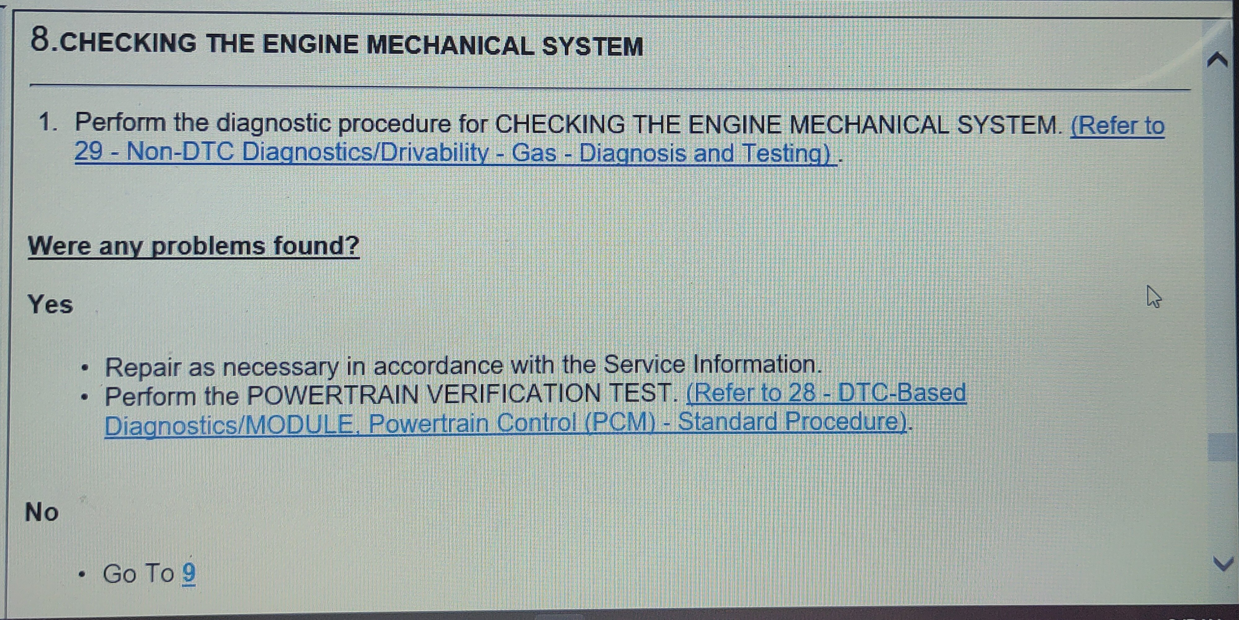

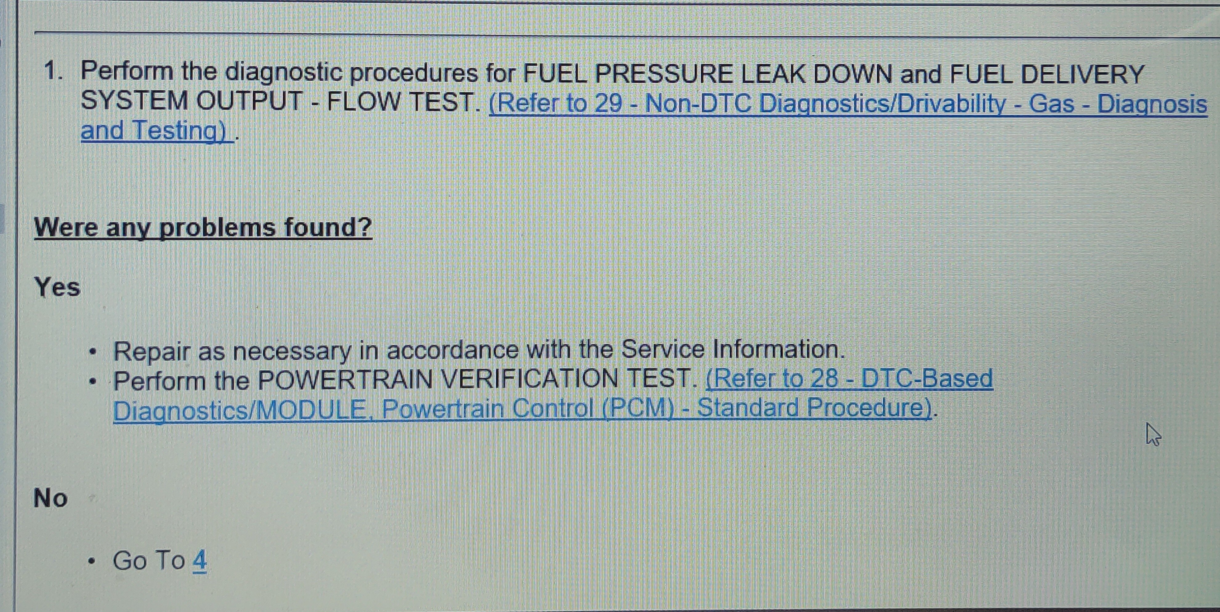

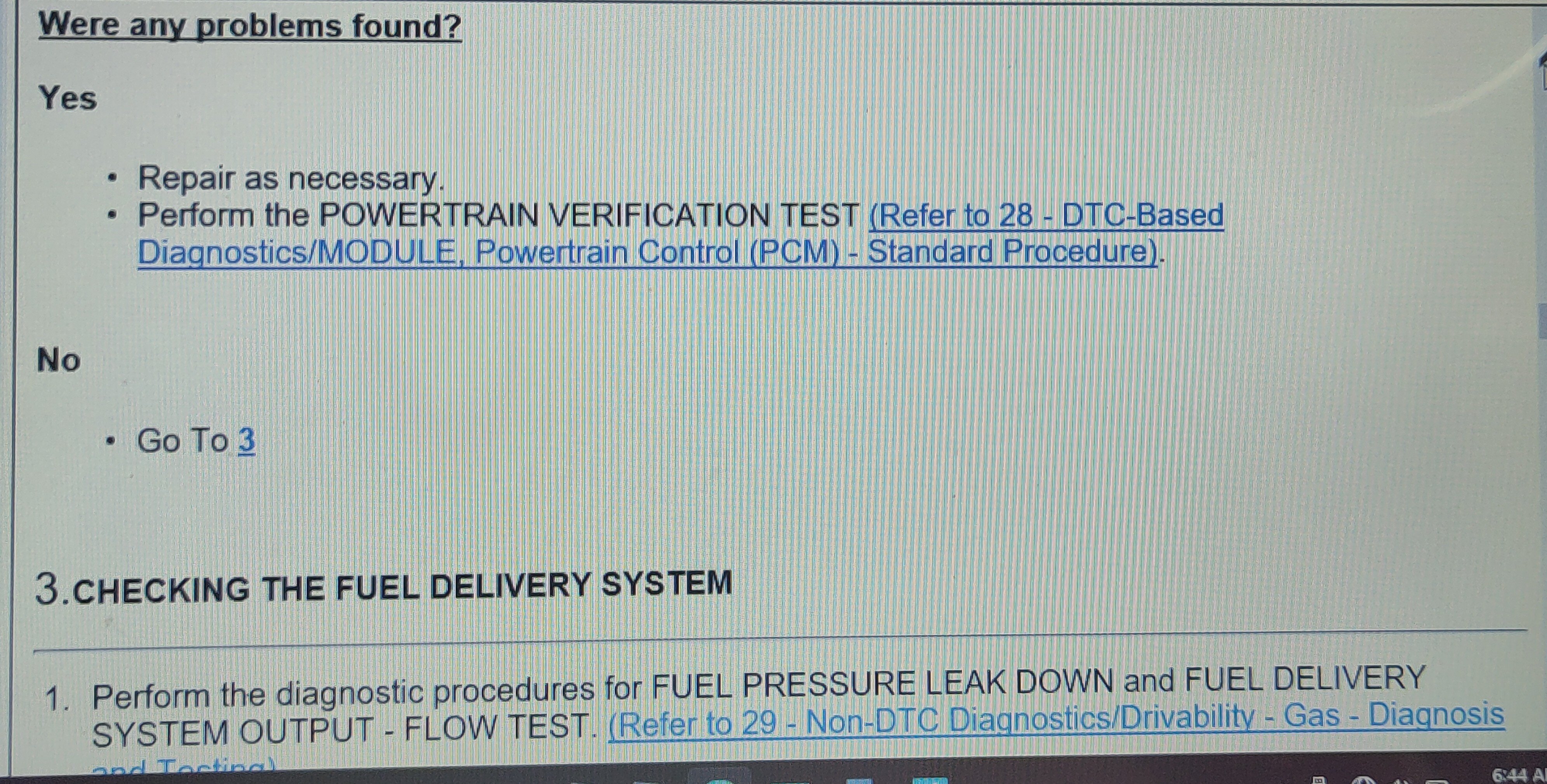

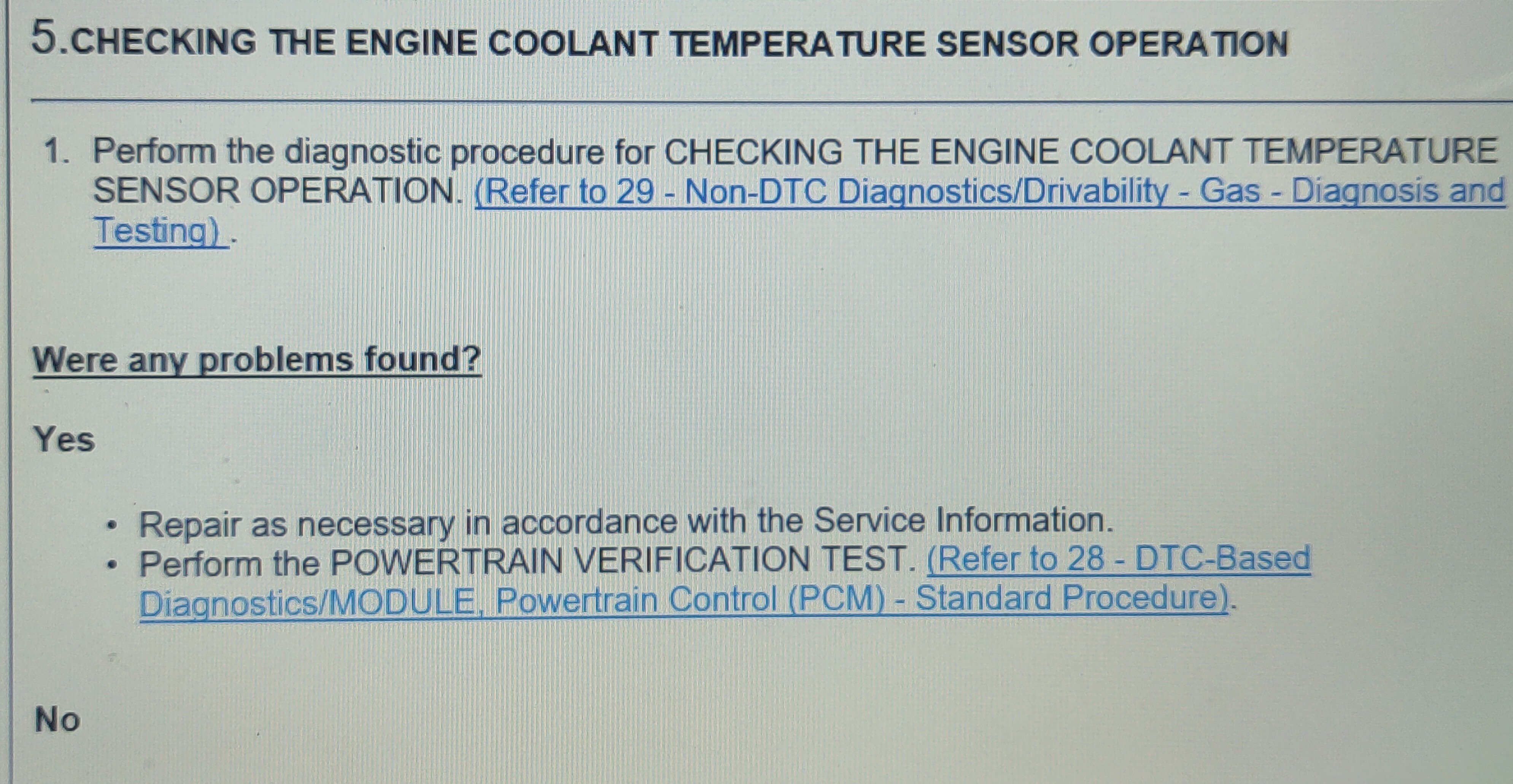

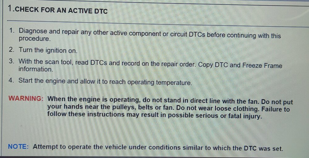

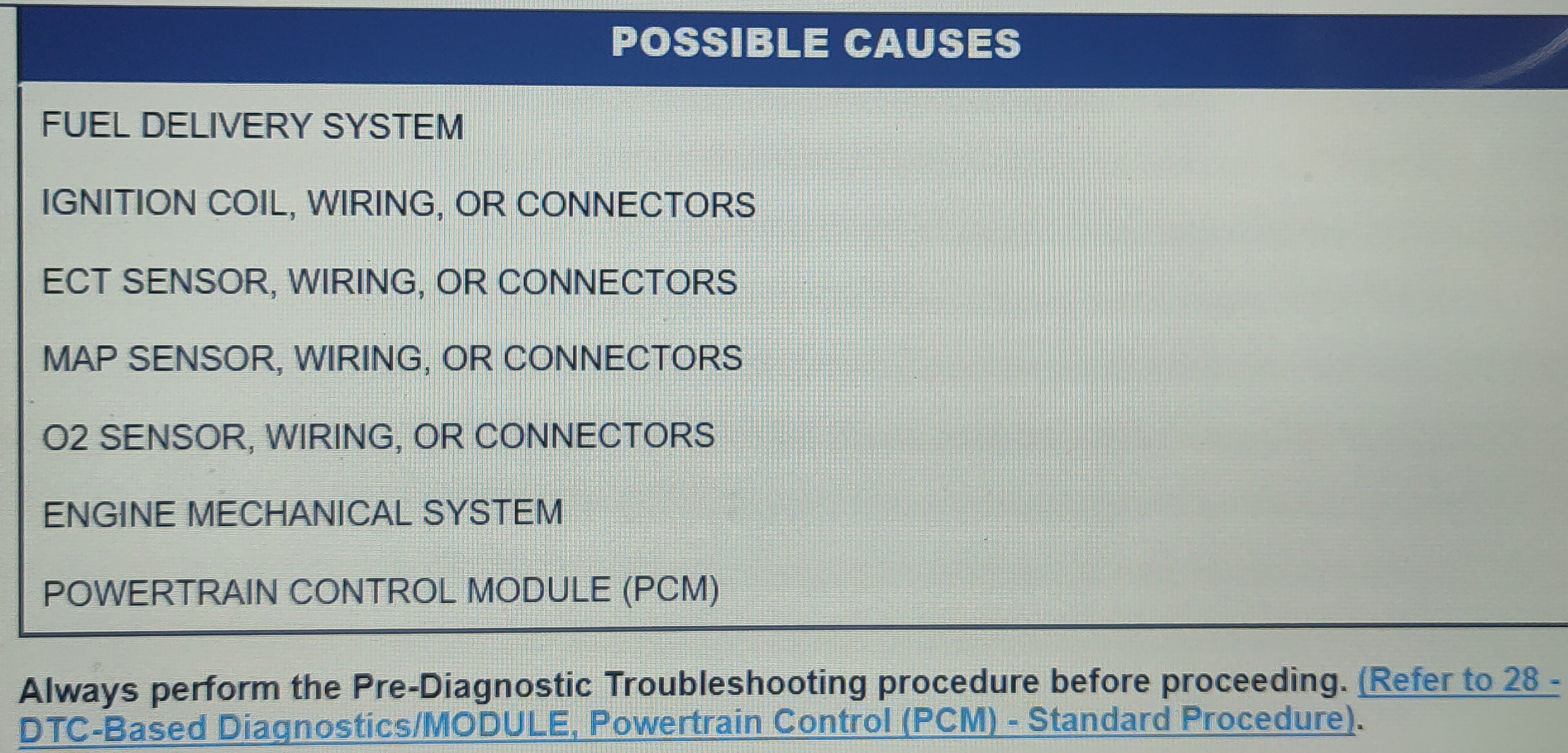

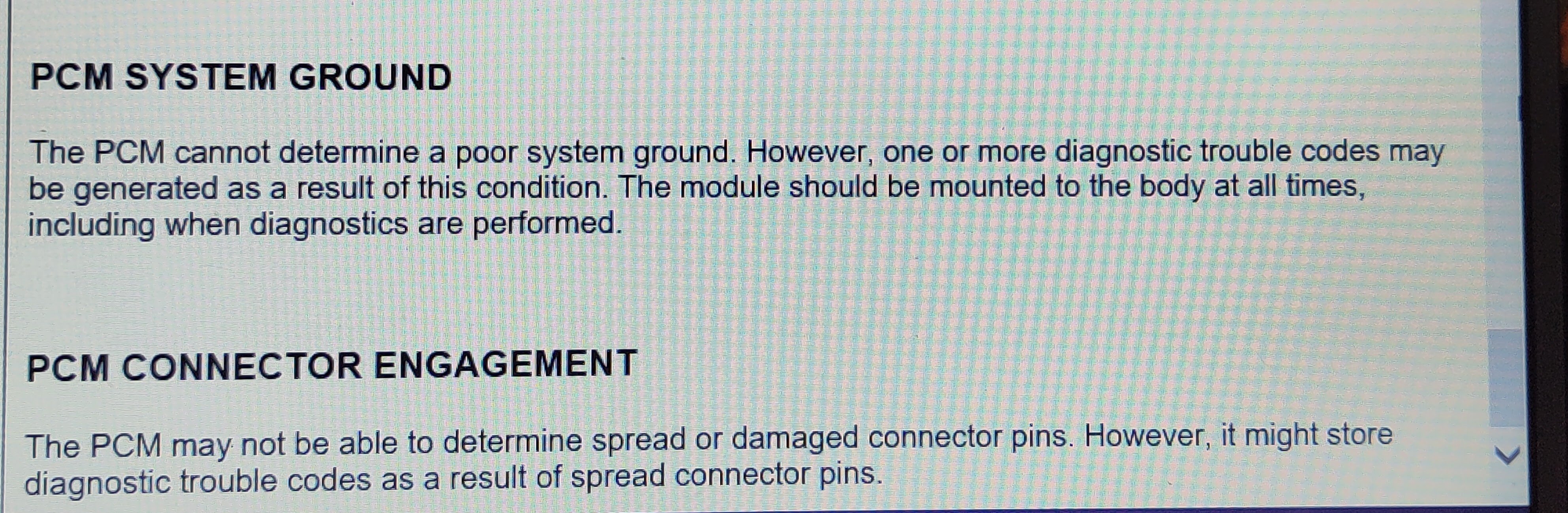

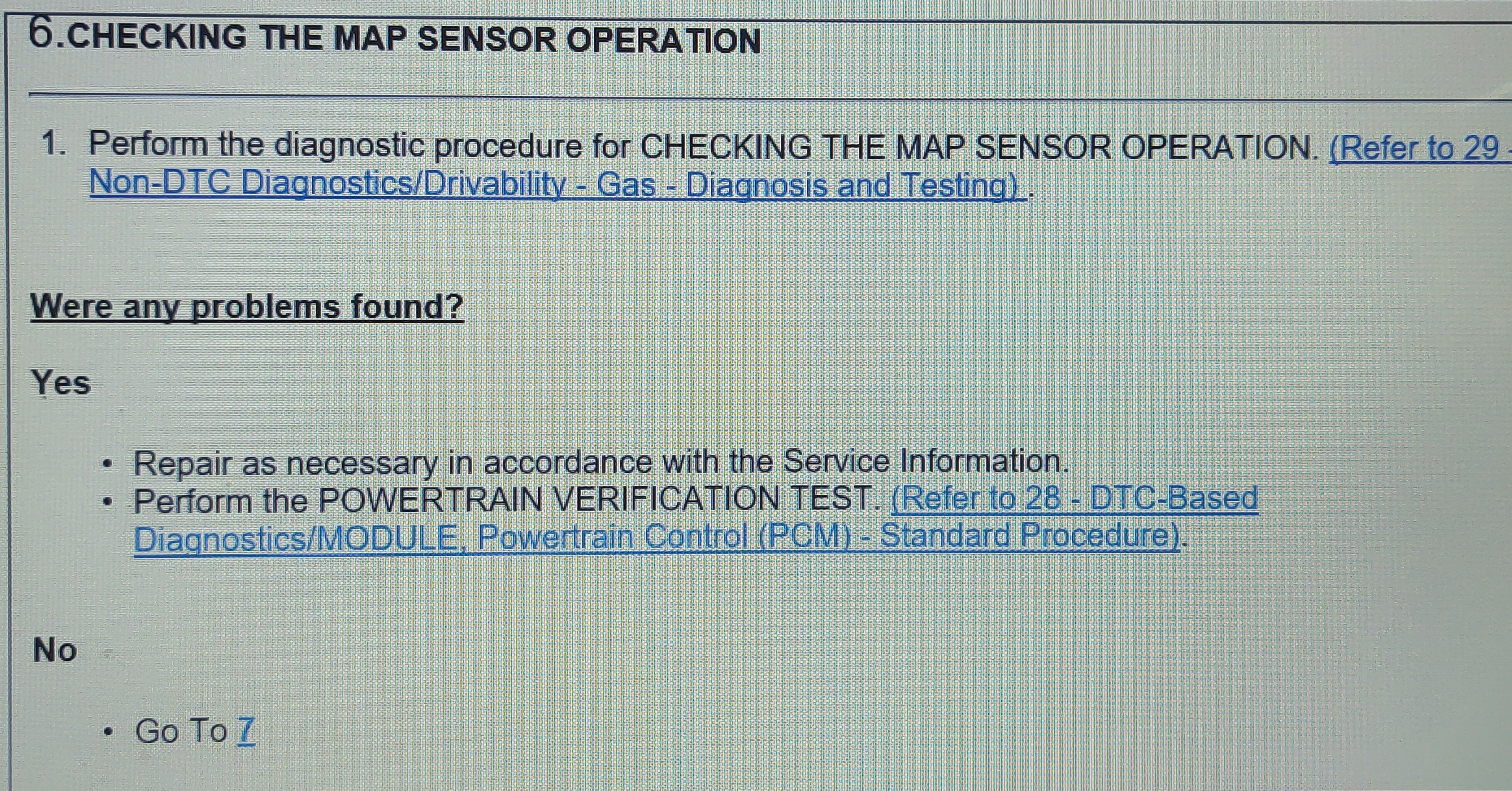

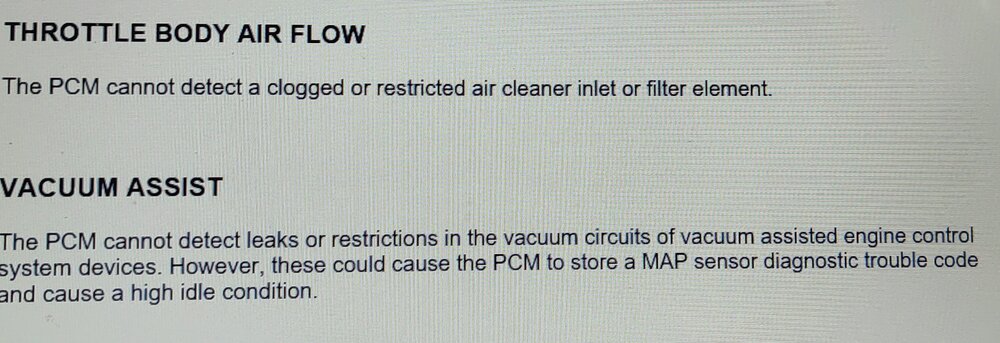

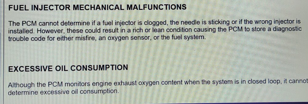

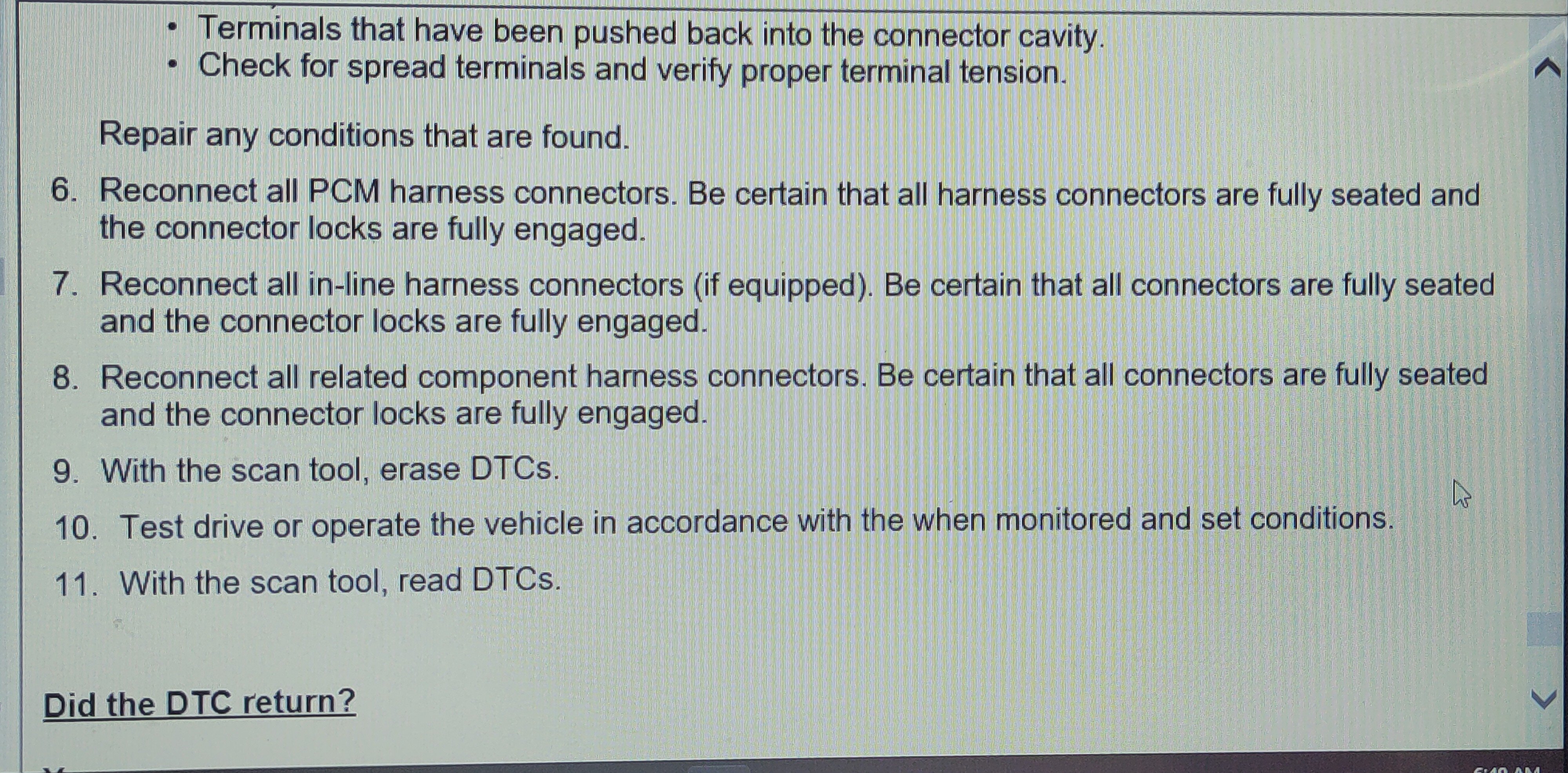

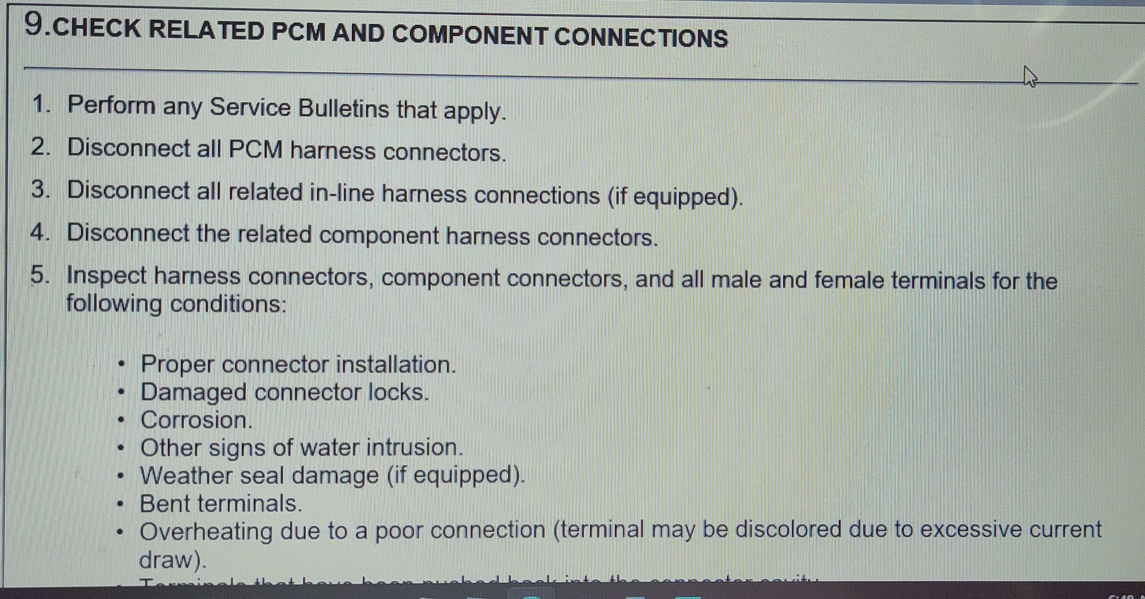

Dean H Posted May 25 Report Share Posted May 25 I'm posting the 2016 DJ service CD. Trouble shooting chart. Read carefully. Quote Link to comment Share on other sites More sharing options...
Dean H Posted May 25 Report Share Posted May 25 Quote Link to comment Share on other sites More sharing options...
Dean H Posted May 25 Report Share Posted May 25 One thing, that is a problem on the Journey. There isn't enough engine to chassis ground straps or cables. The main engine battery ground is a small 4 gauge. Should go to a 2 gauge. Add a 4 gauge ground on the opposite engine mount. 2 gauge if it will fit in. Dean Quote Link to comment Share on other sites More sharing options...

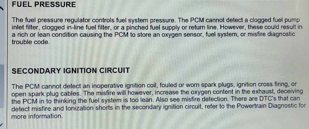

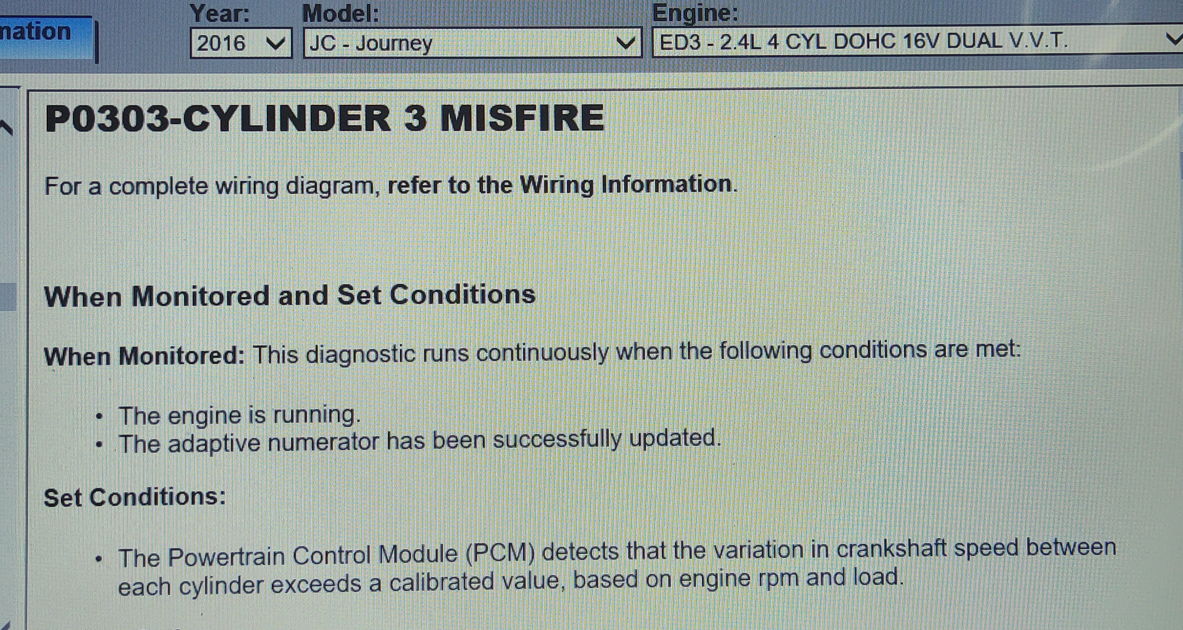

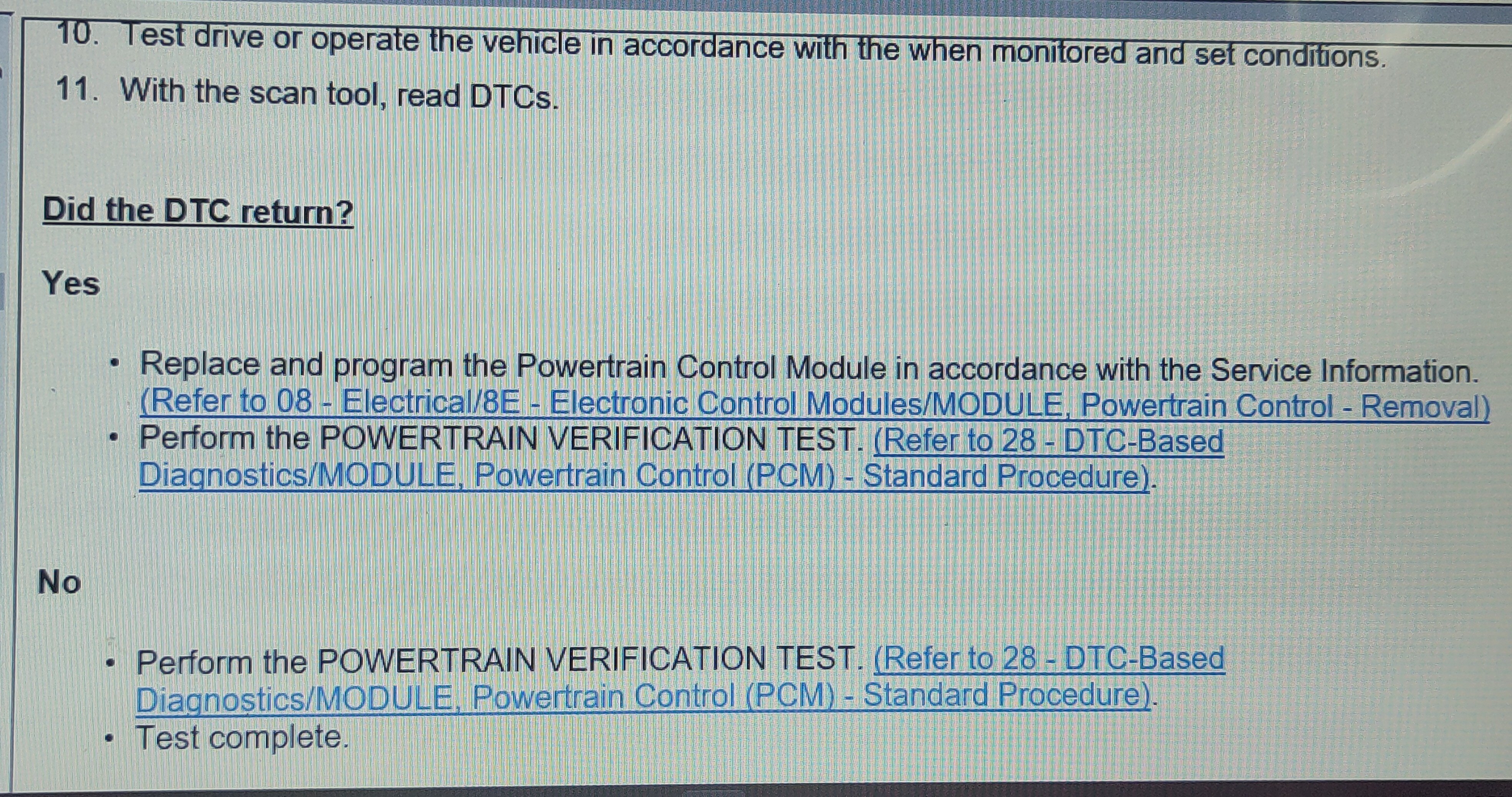

Dean H Posted May 29 Report Share Posted May 29 Found this in the 2016 DJ service CD. Quote Link to comment Share on other sites More sharing options...

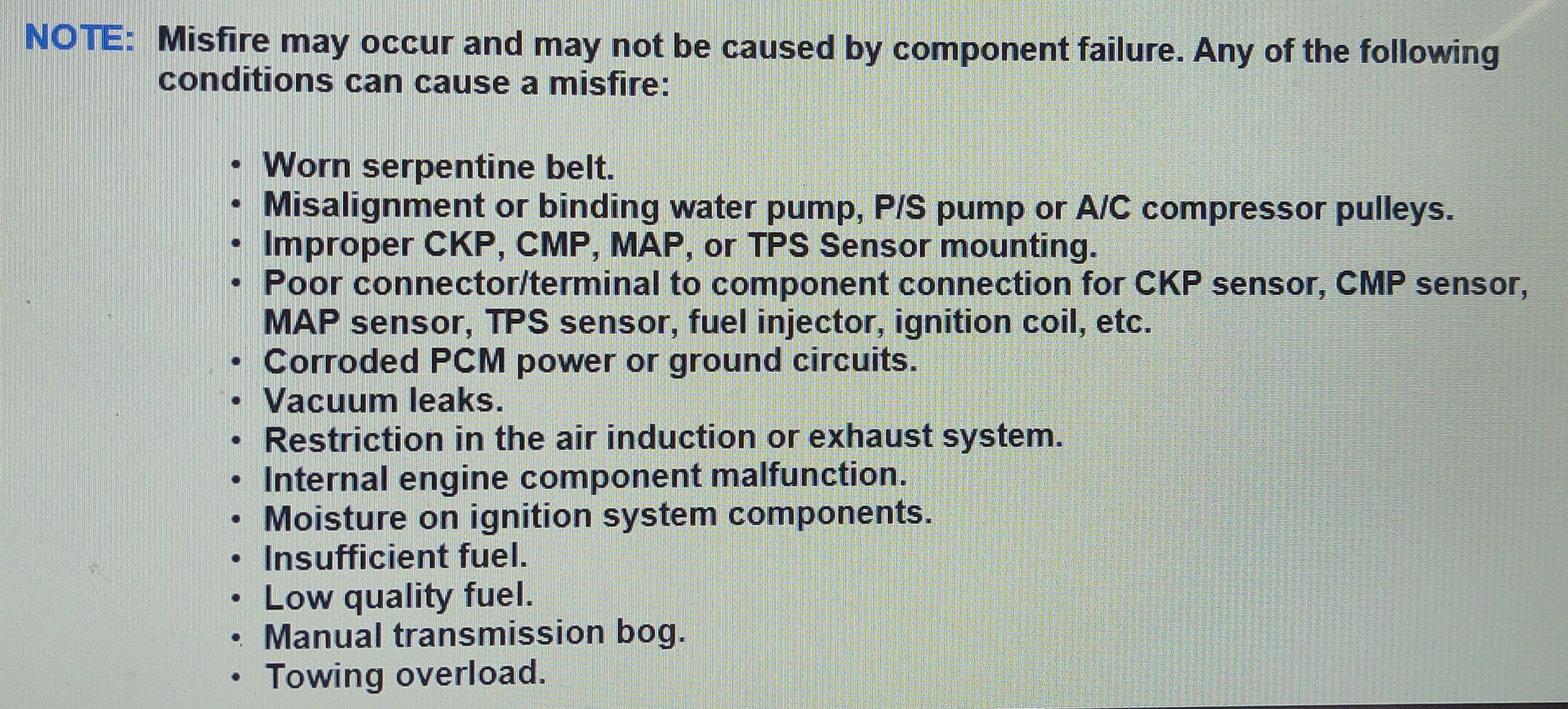

Dean H Posted May 29 Report Share Posted May 29 Quote Link to comment Share on other sites More sharing options...
