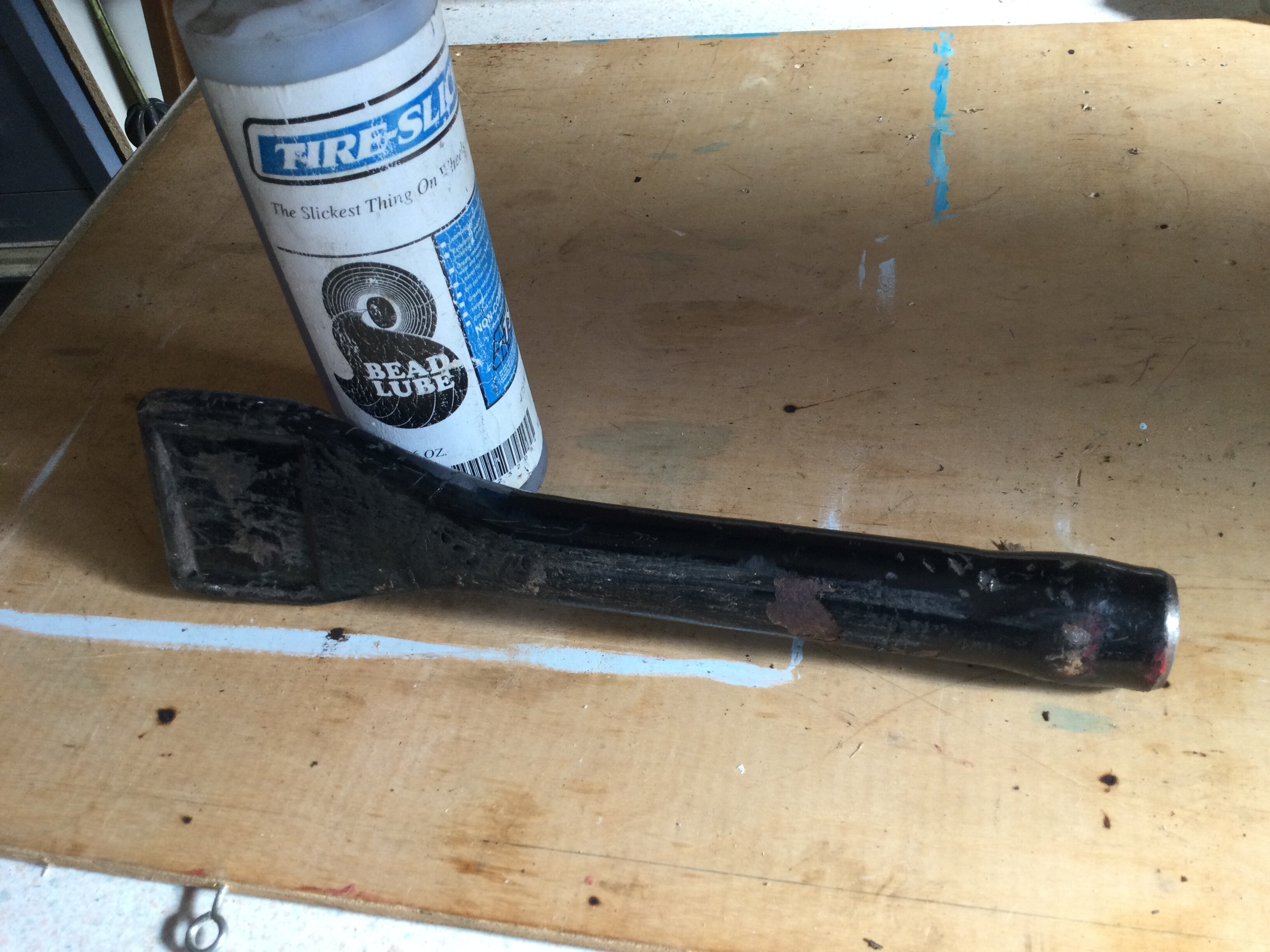

John/Horace Posted June 9 Report Share Posted June 9 The new TPMS sensors I have used are the preprogrammed Dorman and the cheapest one on RockA, Schrader I think $30 Cdn $. Both came up after 10 mins driving over 30 mph. Winter tire rims I don’t bother, too pricy and tires are old. With my bead breaker I can just change them out without removing tire. A metal special tire wedge and a 2x4 gives me enough gap. Wheel weights marked to keep spot, so no balancing. Heavy soap mix solution or bead glide to help seat side wall. Yup..I am cheap. Need to keep an eye on the rear caliper parking brake mechanism. On both our journeys they started to hang up and not retract completely. Was able to free them up once or twice for a few months. Eventually replaced both on the 2014. The 2012 has one that still drags, haven’t done it yet. Can tap it back to full retracted position easily with a small hammer without jacking up car. If you use them all the time I don’t think this issue comes up. It’s seizing from sporadic use. I put larger retracting springs on one caliper and have 2 extra years without hanging up. Maybe another salt belt issue, no else mentions this issue on the site mmm. Quote Link to comment Share on other sites More sharing options...
