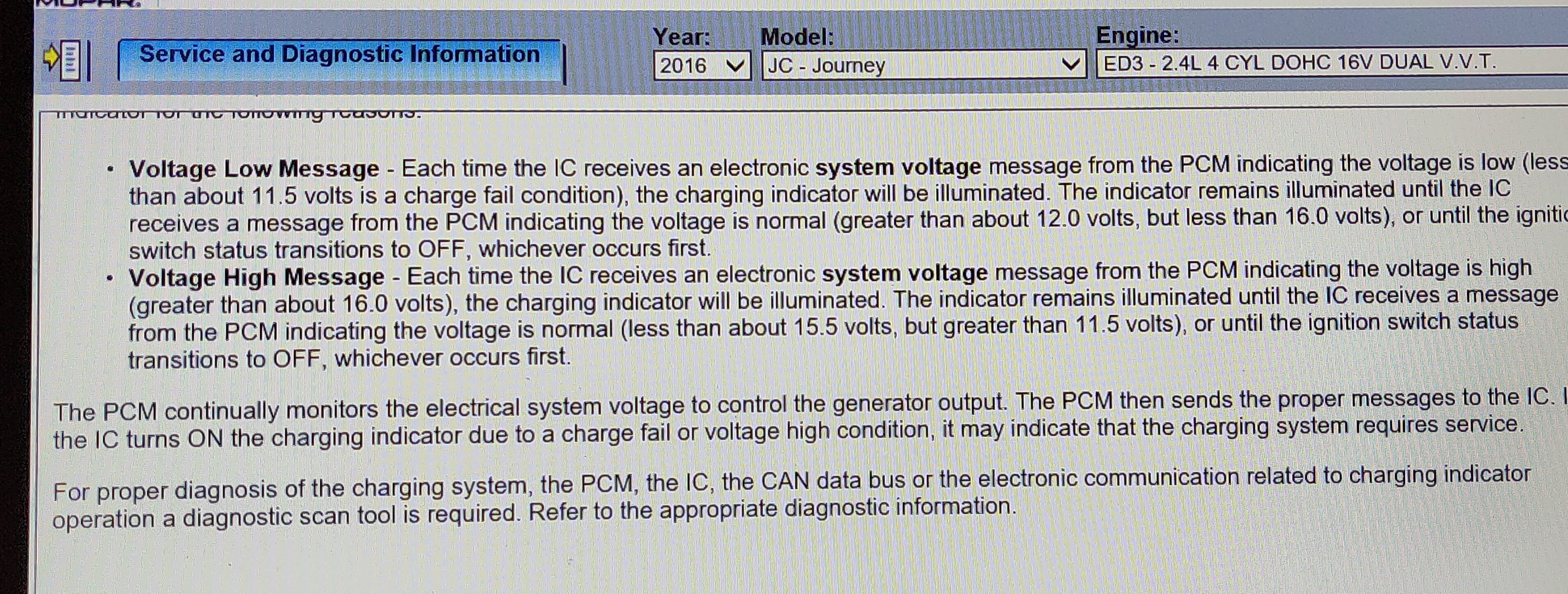

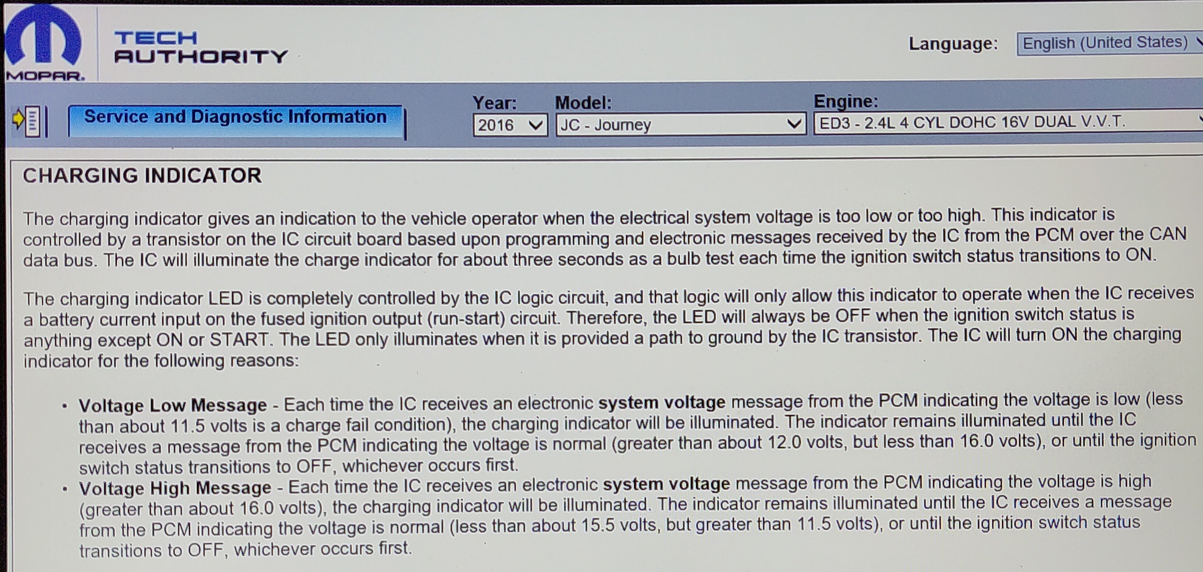

Dean H Posted June 5 Report Share Posted June 5 From 2016 DJ service CD. NicholasC 1 Quote Link to comment Share on other sites More sharing options...
