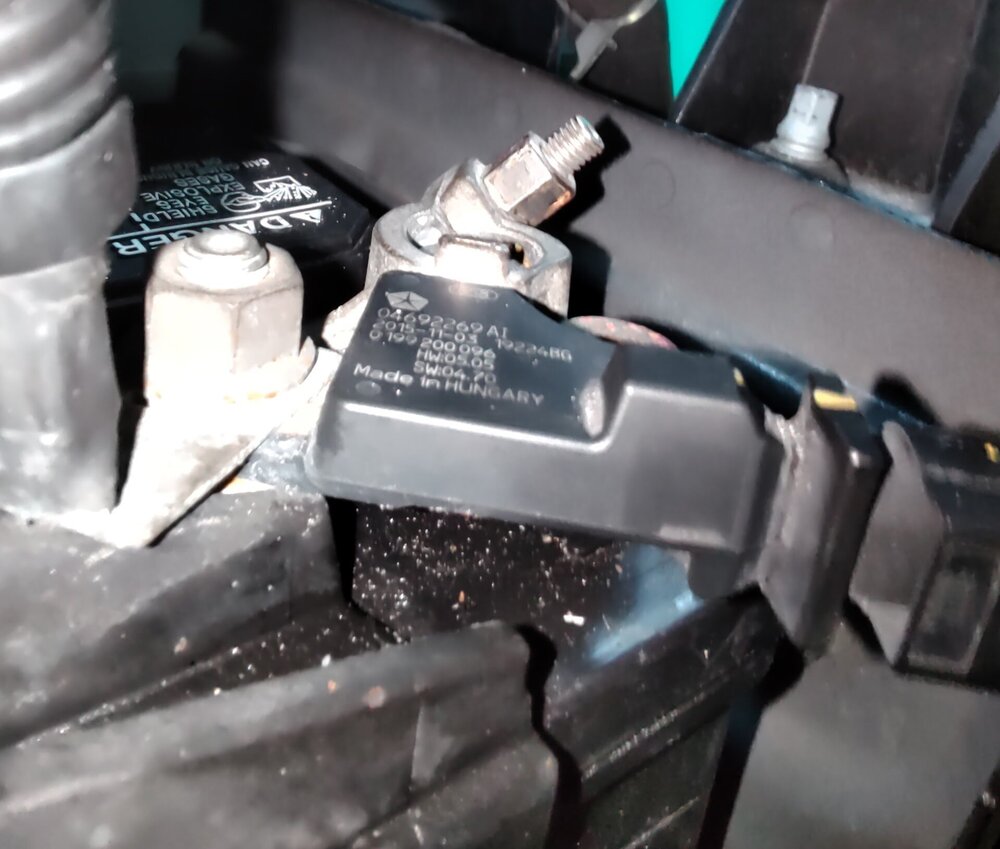

Dean H Posted June 15, 2024 Report Share Posted June 15, 2024 2016 DJ 3.6 L 62te transmission I worked on my battery with the car on the ground. With tire on. To access the negative terminal Battery sensor. Go through the engine bay. Remove the air intake system. Including the air filter box. Before you do this, disconnect the negative battery terminal at the stud on the strut tower. There is latch on the connector, you have to release by sliding it back. Then wiggling and tugging on the connector. Go easy. The wires are short. Check if the sensor is fully seated on the terminal. It should be. Check it out. Clean every contact part there is. Picture is from where the air filter box sits. On the 2 studs in foreground. In this picture, my battery sensor is only half seated on the battery terminal. The negative cable is hitting the battery hold down. You can reach the positive terminal. With the tire turned inward. It is tight. There is a plastic access panel you remove. Summer Solstice 1 Quote Link to comment Share on other sites More sharing options...

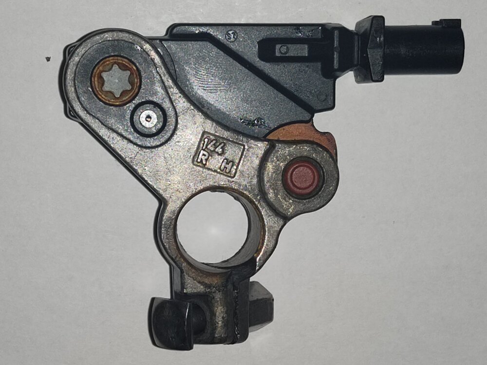

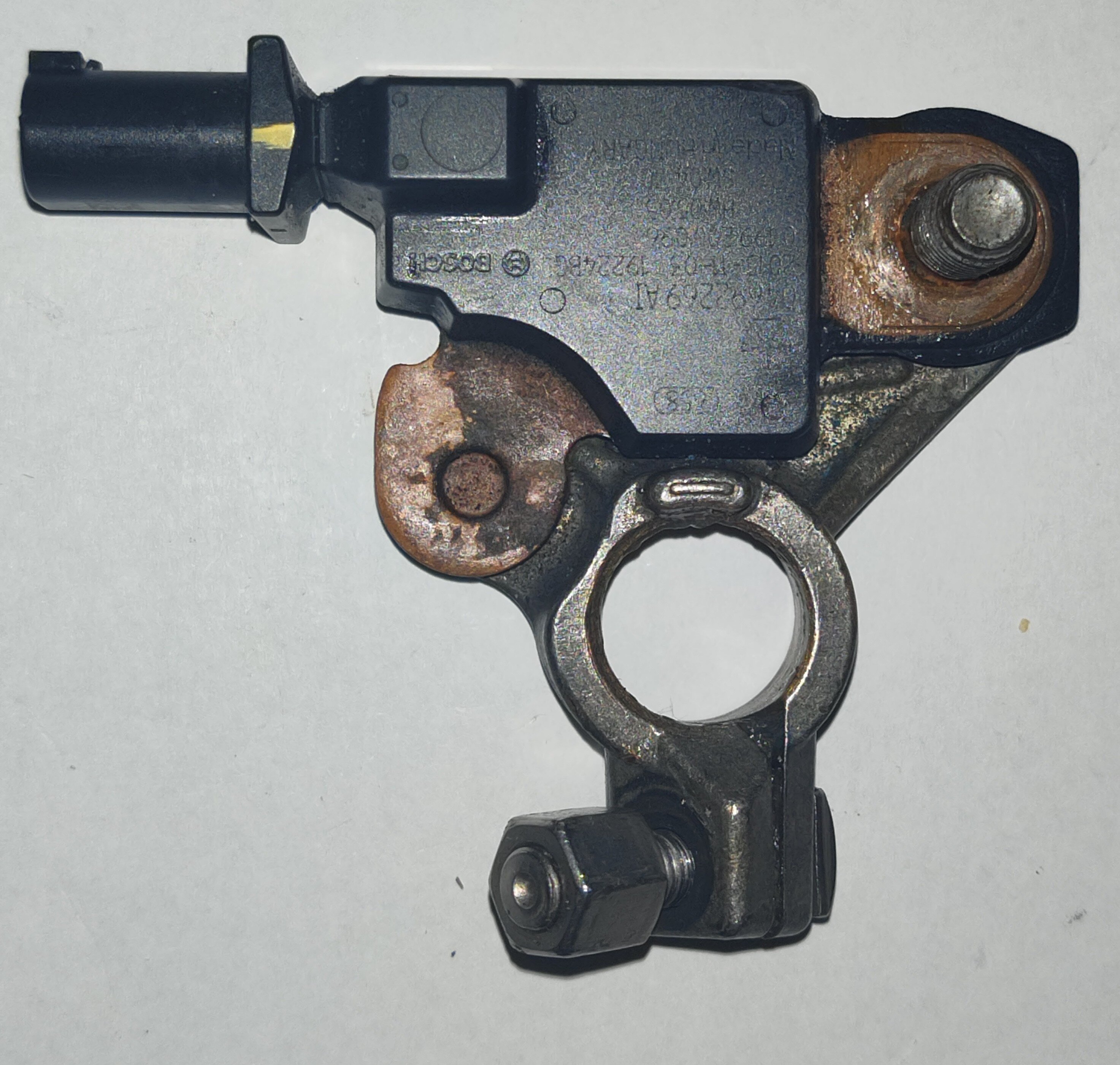

Dean H Posted June 16, 2024 Report Share Posted June 16, 2024 This is my old stock Battery sensor. Summer Solstice 1 Quote Link to comment Share on other sites More sharing options...
