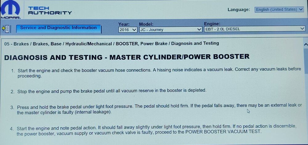

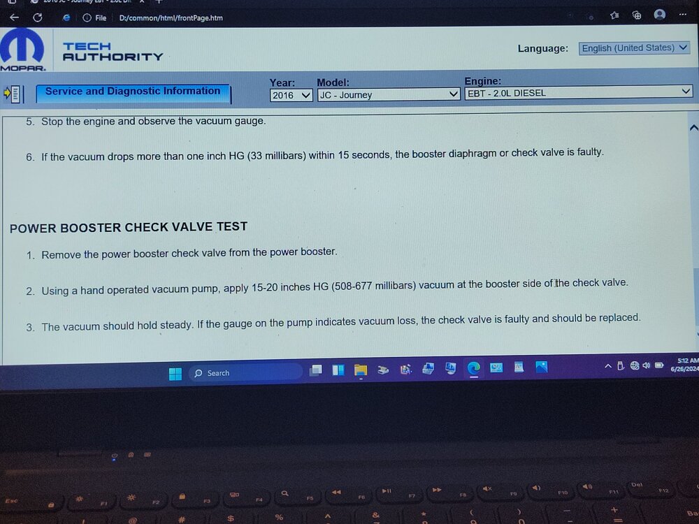

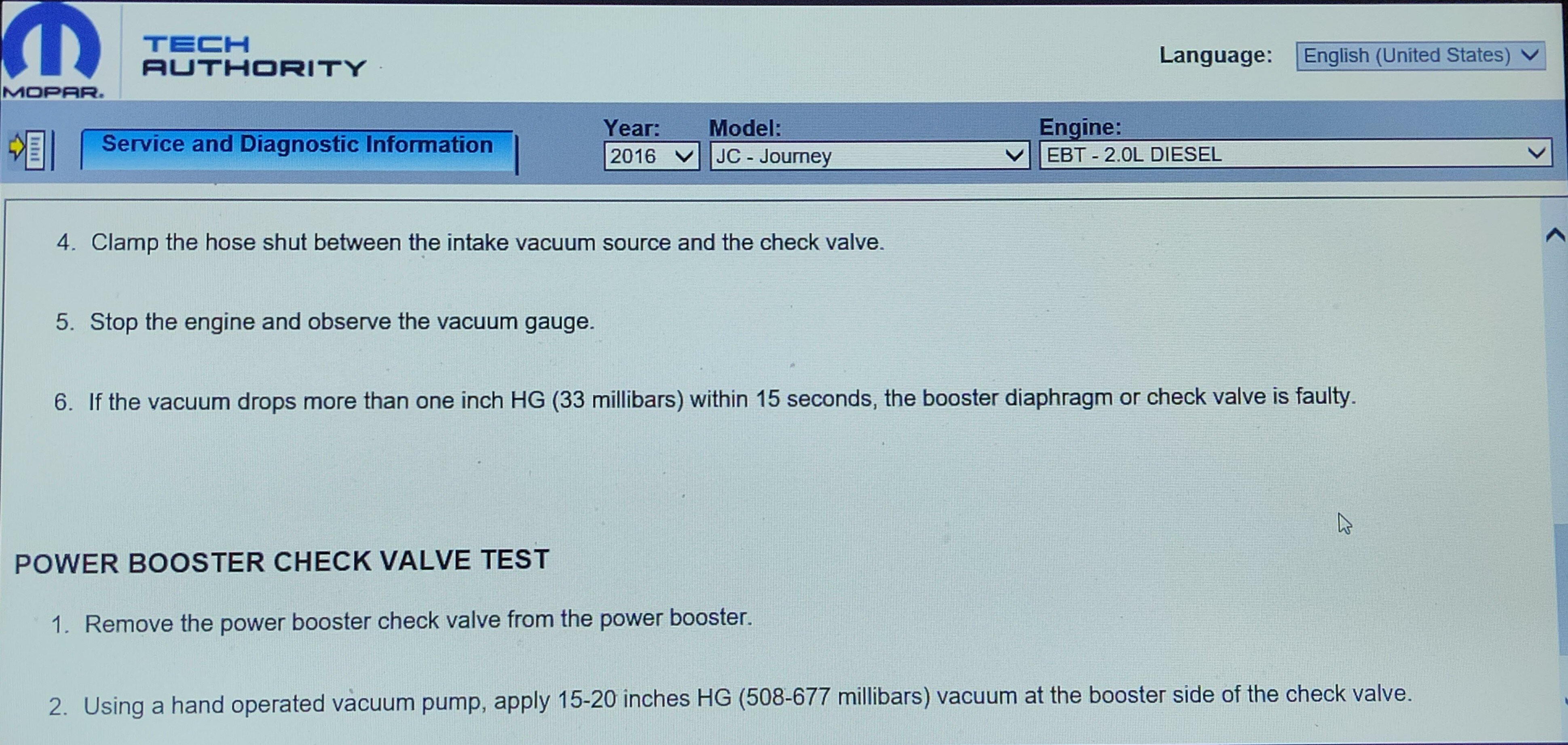

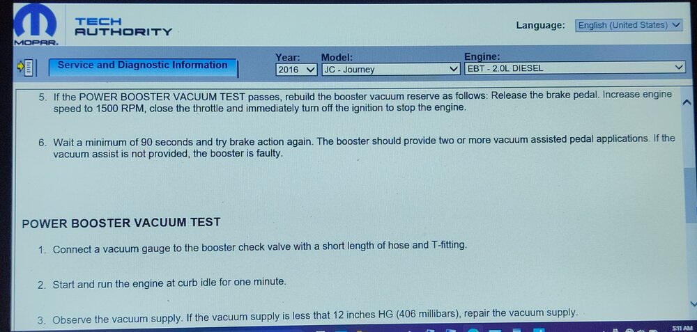

Dean H Posted June 27 Report Share Posted June 27 This is for 2016 2.0 diesel vacuum brake booster. Quote Link to comment Share on other sites More sharing options...
marek196c Posted July 8 Author Report Share Posted July 8 On 6/27/2024 at 7:51 PM, Dean H said: This is for 2016 2.0 diesel vacuum brake booster. All tests passed however 1st test 4th step I got the desidered action on starting engine and brake pedal falling down, problem is it's not stopping but going all the way to the floor basically. While it should stop after some (minor) brake pedal. Quote Link to comment Share on other sites More sharing options...
