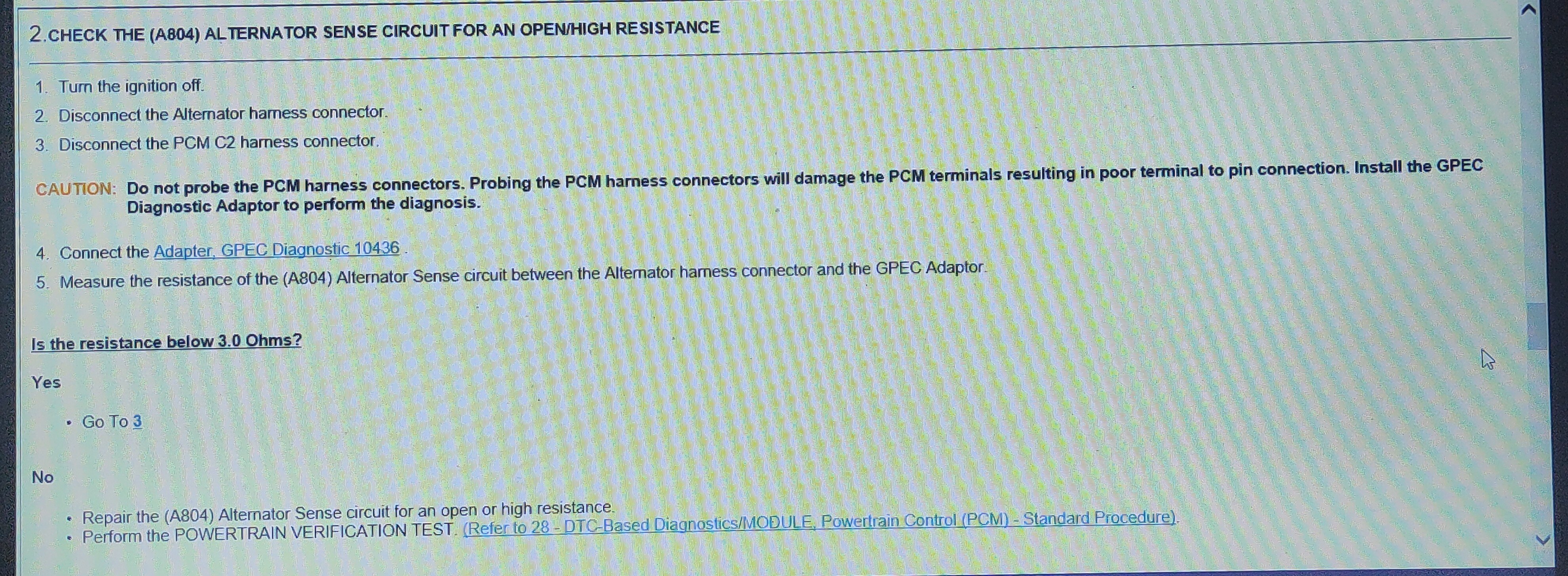

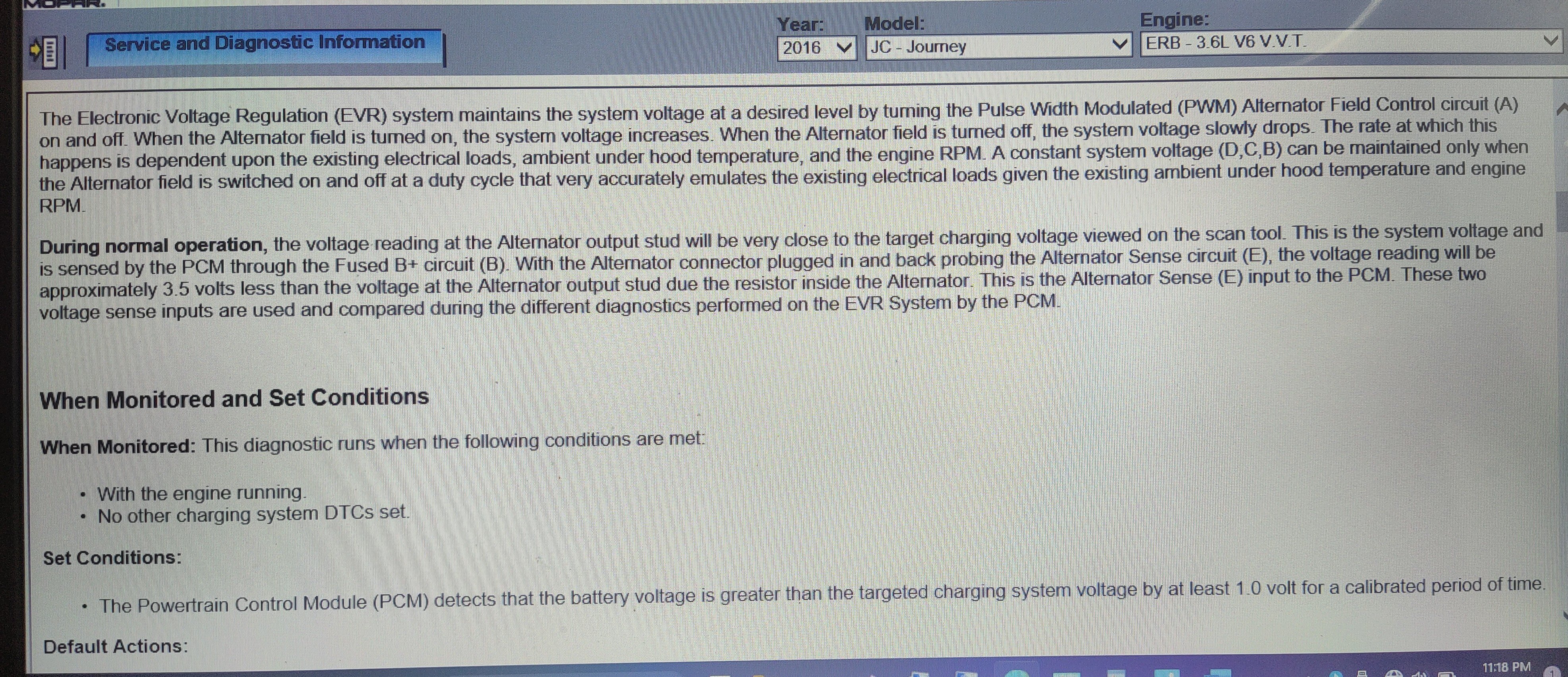

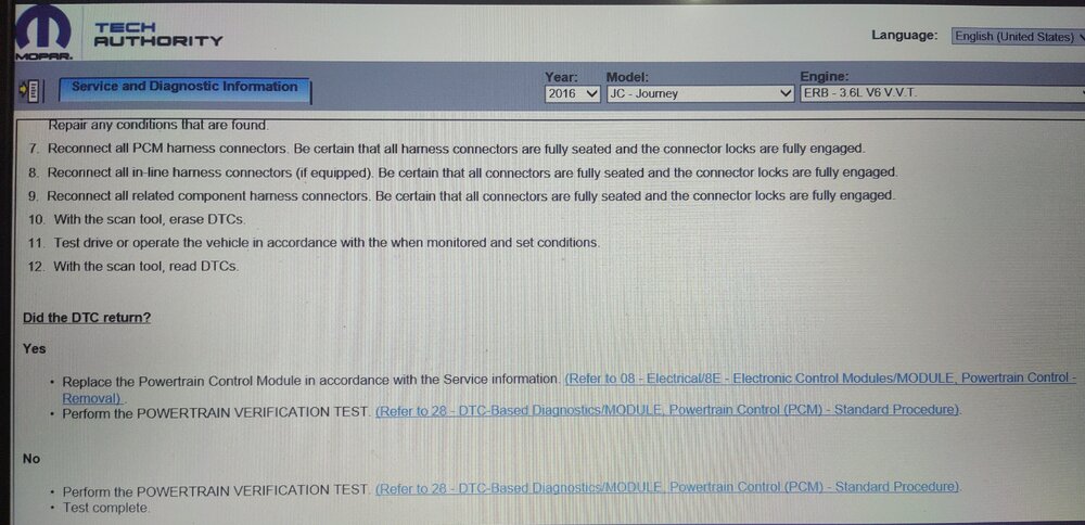

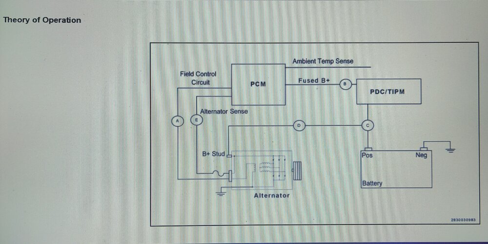

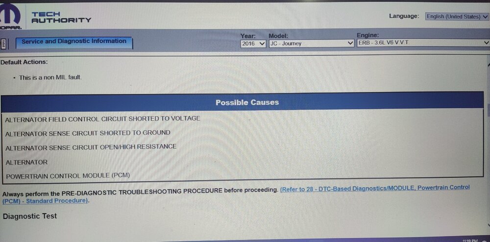

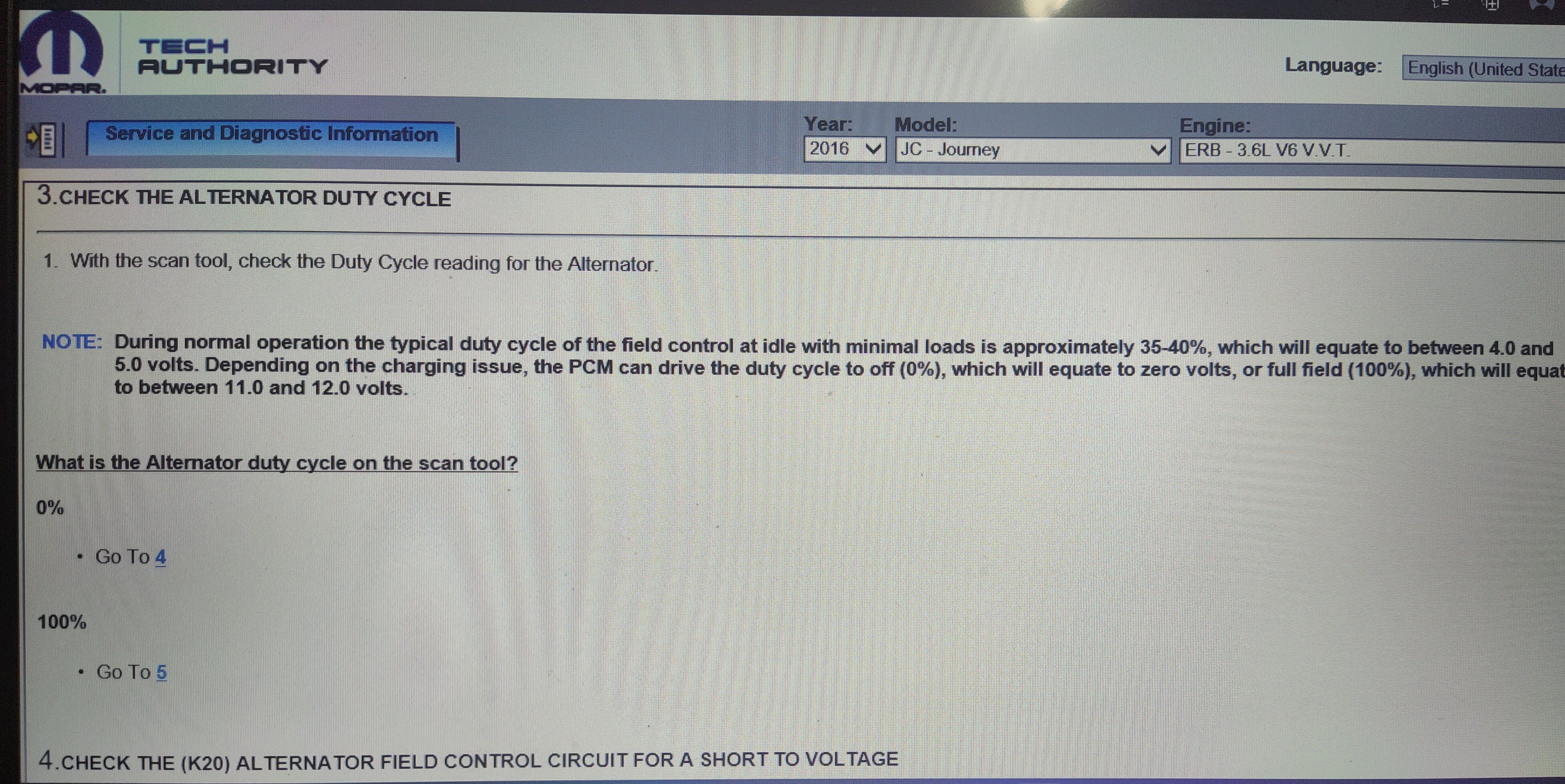

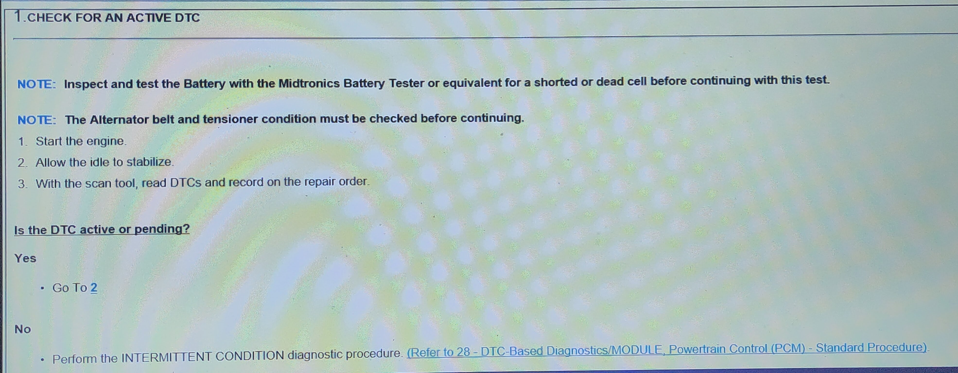

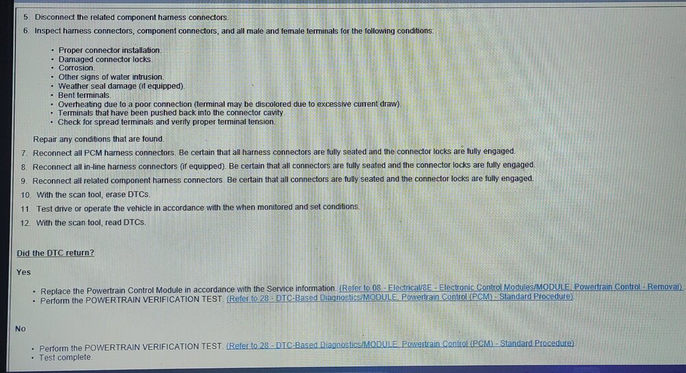

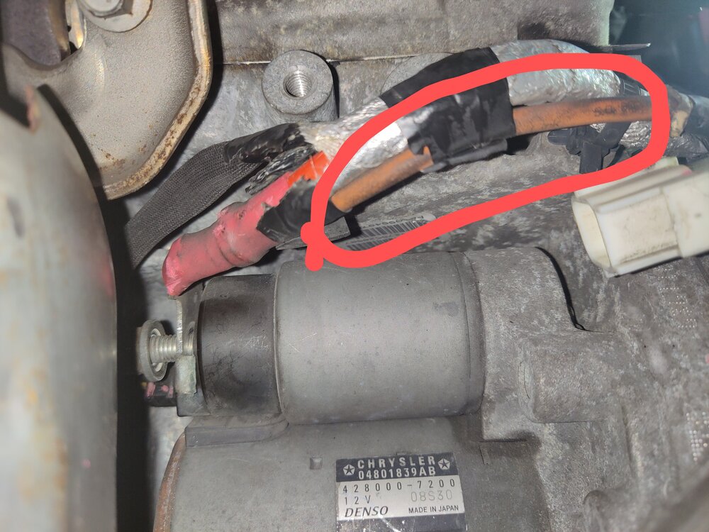

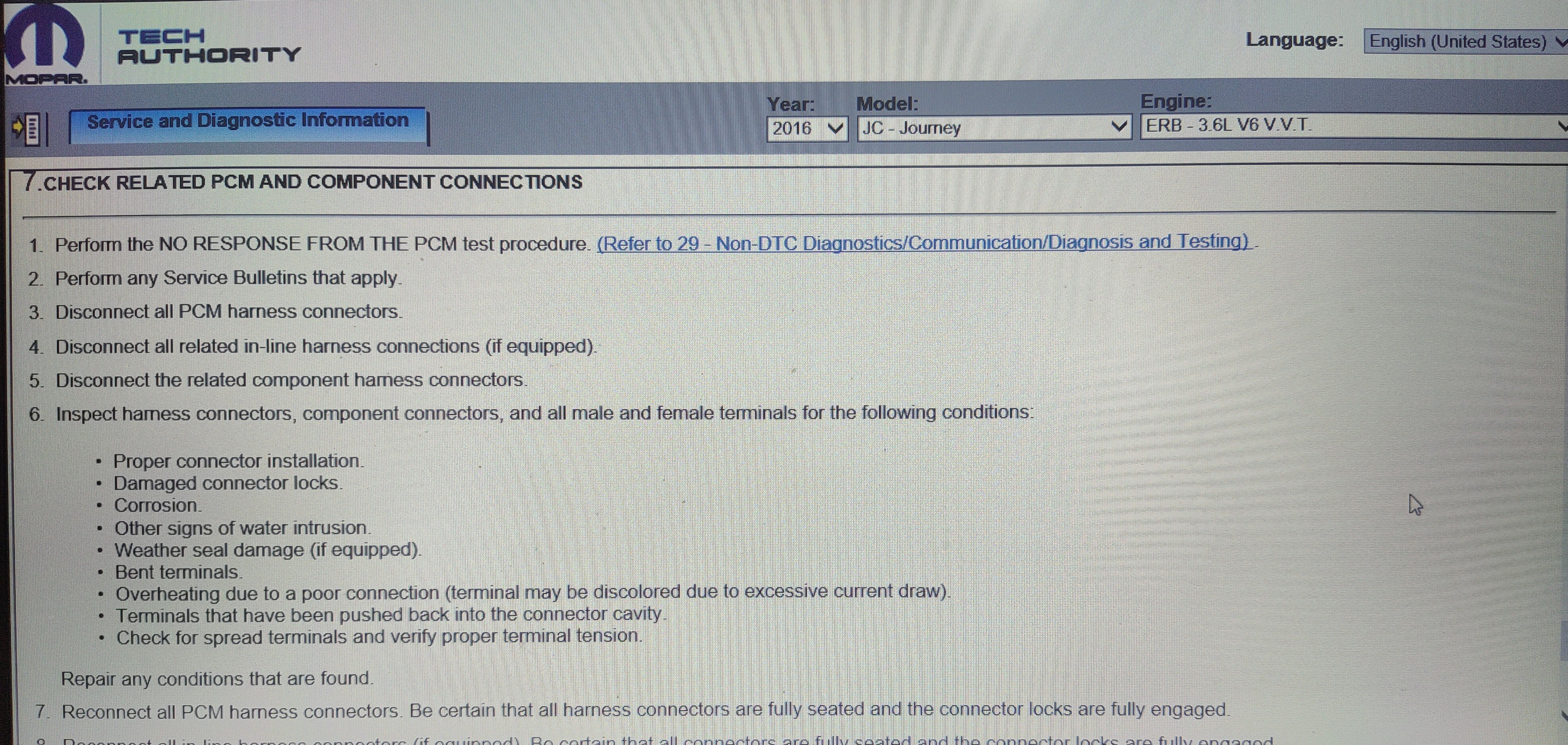

Dean H Posted July 6, 2024 Report Share Posted July 6, 2024 The Dodge troubleshooting chart, for your codes point to the alternator or it's wiring. Check this cable. The alternator battery feed connects at the starter stud. Fusible link (orange wire) to 4 gauge to alternator stud. If your wire connections to the alternator are good. It may be the alternator. Electrical troubleshooting and maintenance. Do this it will help. Read my post- https://www.dodgejourneyforum.com/topic/18210-electrical-system-fyi-battery/ Process of elimination - 1) Battery terminal connections Clean up and tighten every cable connection. Negative battery terminal battery sensor. Exam sensor. Clean every connection on it. Installing sensor, you need to get the sensor seated all the way down. Before connecting any wires. Once seated spin sensor until all wires can be connected. Test the battery we need to know if it meets specifications. Problems on the journey - Read my post- https://www.dodgejourneyforum.com/topic/18115-electrical-system-fyi-cables/ 1) battery cables are 4 gauge. Too small should have been 2 gauge. The stock positive cables do seem to work. Clean connections are critical. The ground cables seem to be the problem spot. 2) Weak and not enough engine to chassis grounds. People have problems with the battery ground stud to engine block. I recommend owners do these 2 ground upgrades. Their cheap to do and needed. I used a 2 gauge cable from the large ground stud to engine stud. On the passenger side, use 4 or 6 gauge from engine mount to strut tower grounds. Connecting the pass side grounds to the battery ground. Through the engine block. Dean Quote Link to comment Share on other sites More sharing options...

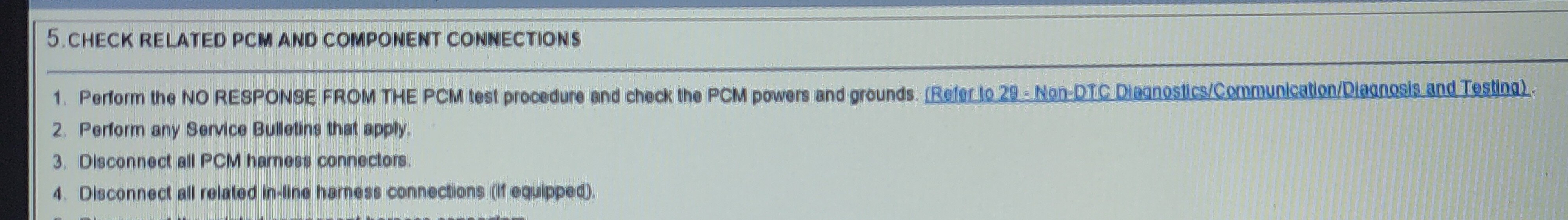

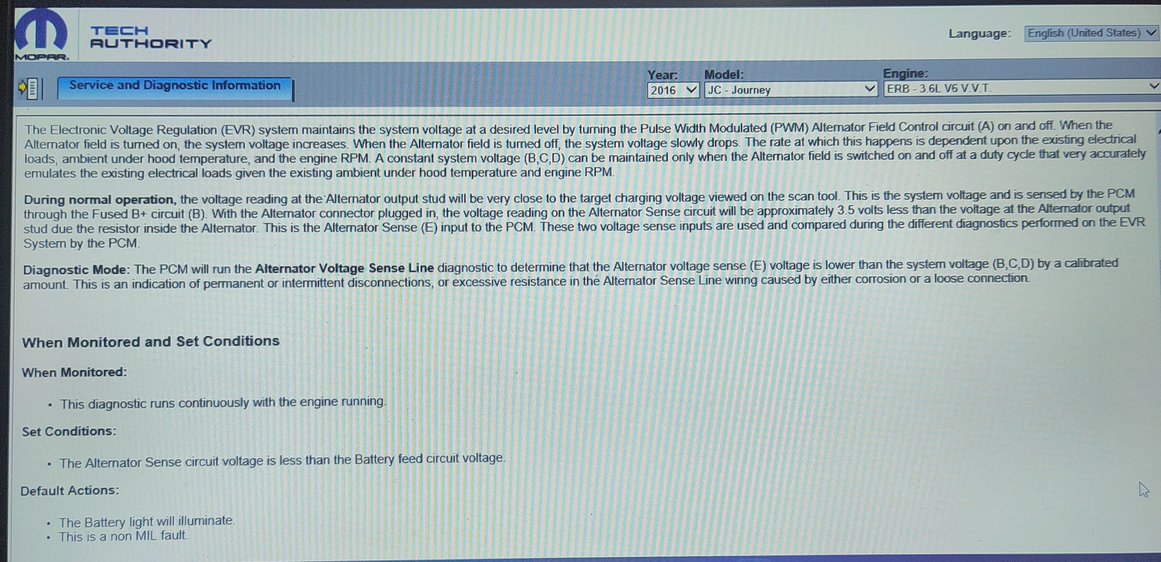

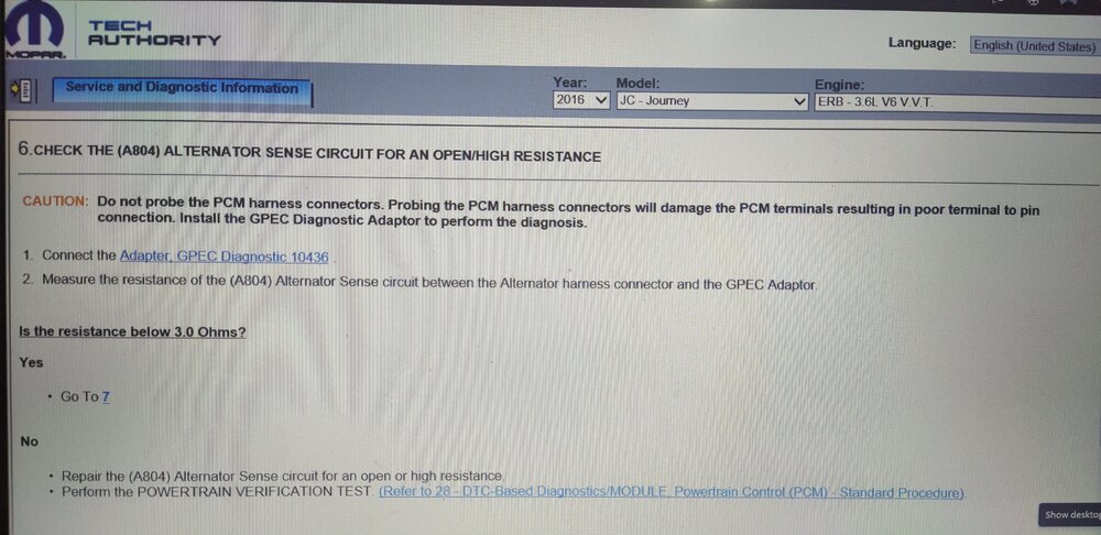

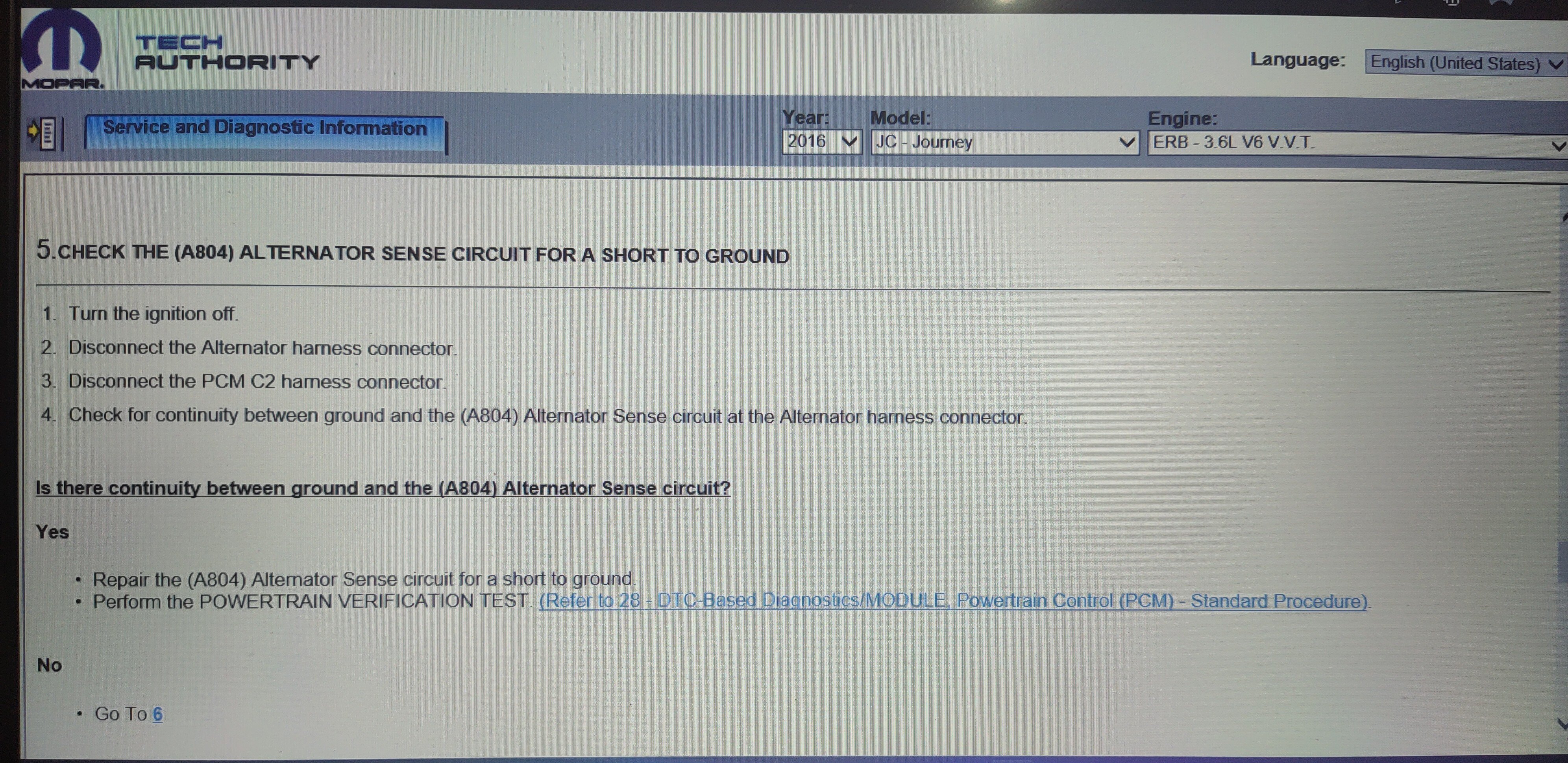

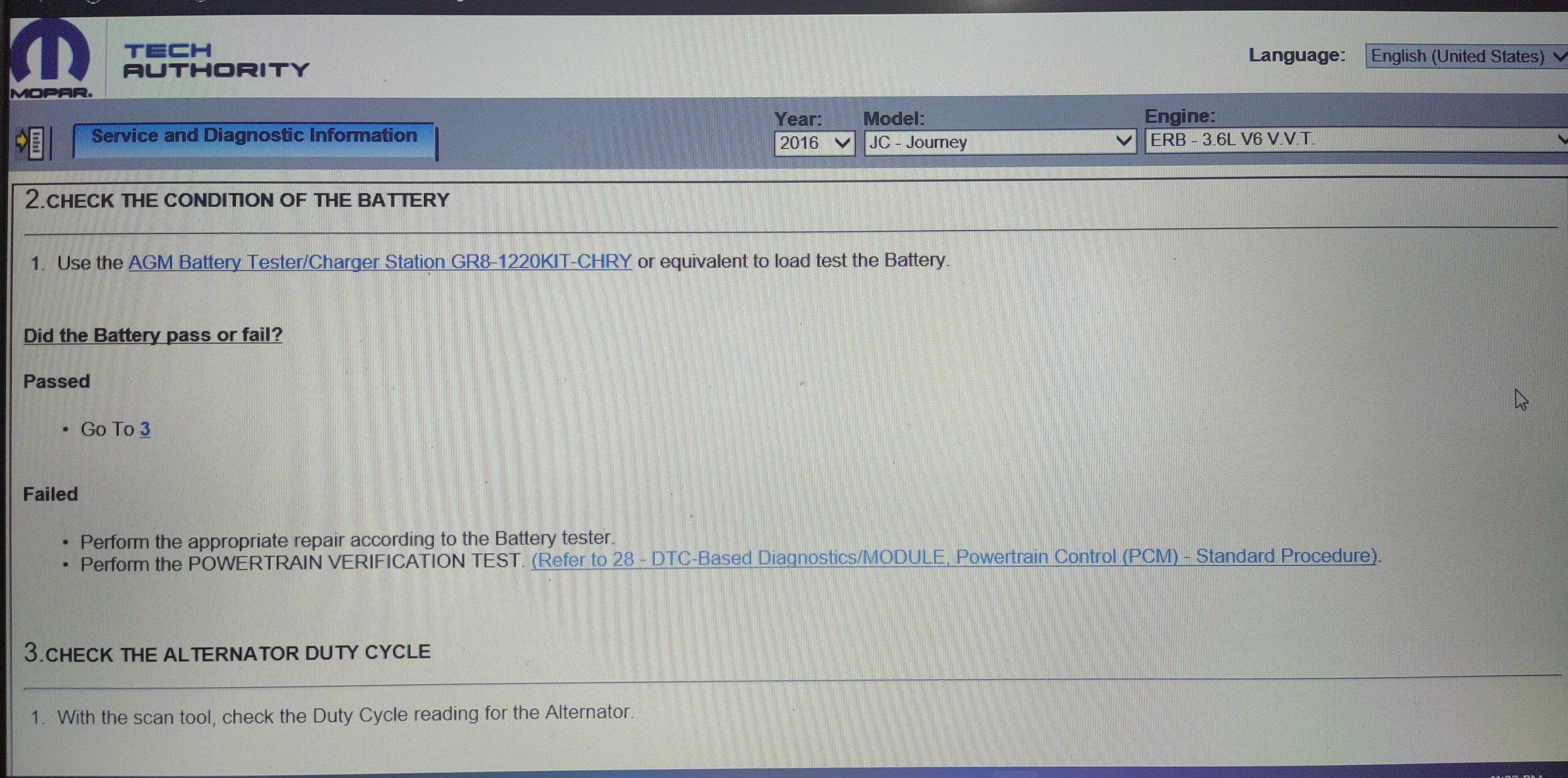

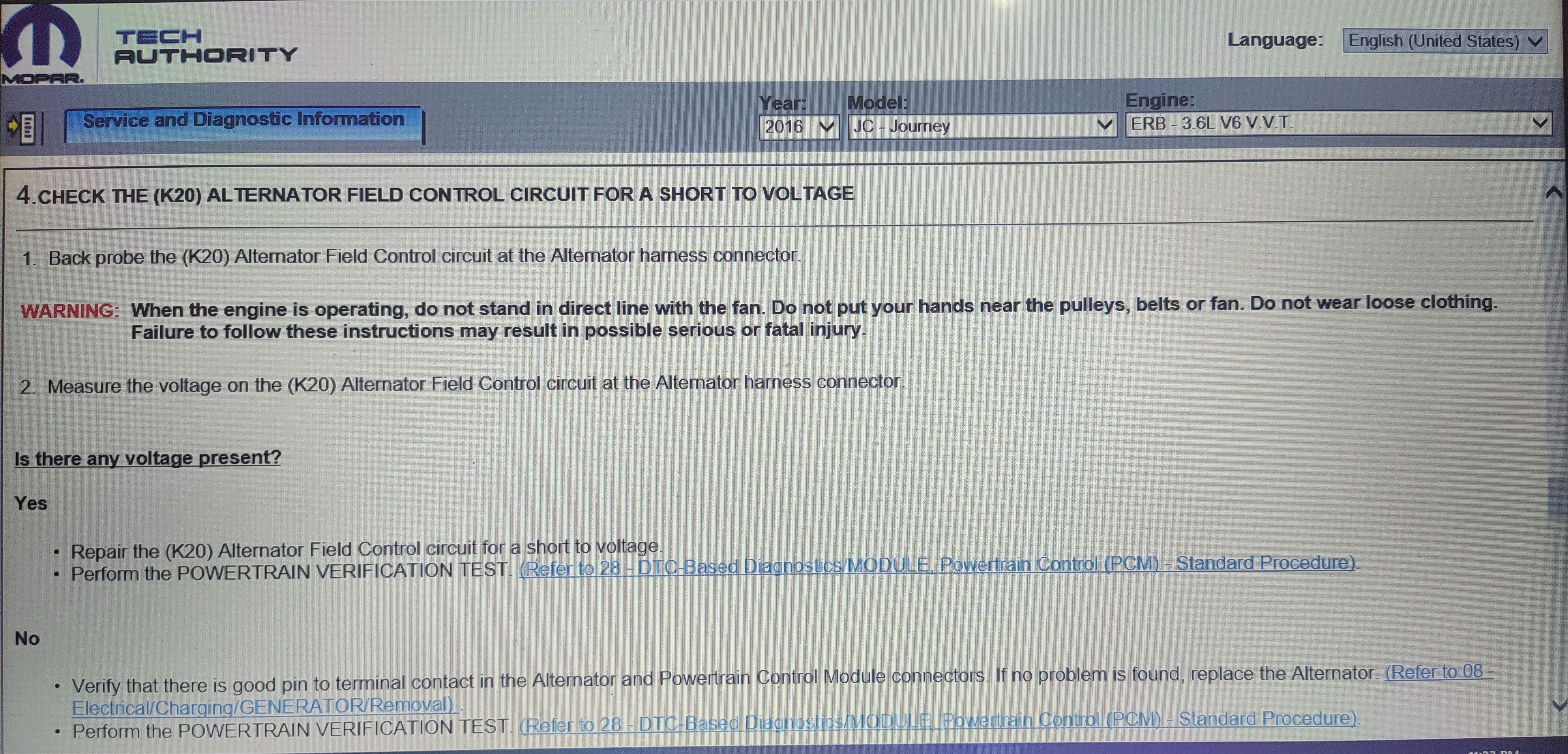

Dean H Posted July 16, 2024 Report Share Posted July 16, 2024 Quote Link to comment Share on other sites More sharing options...
Dean H Posted July 16, 2024 Report Share Posted July 16, 2024 (edited) Edited July 16, 2024 by Dean H Quote Link to comment Share on other sites More sharing options...
