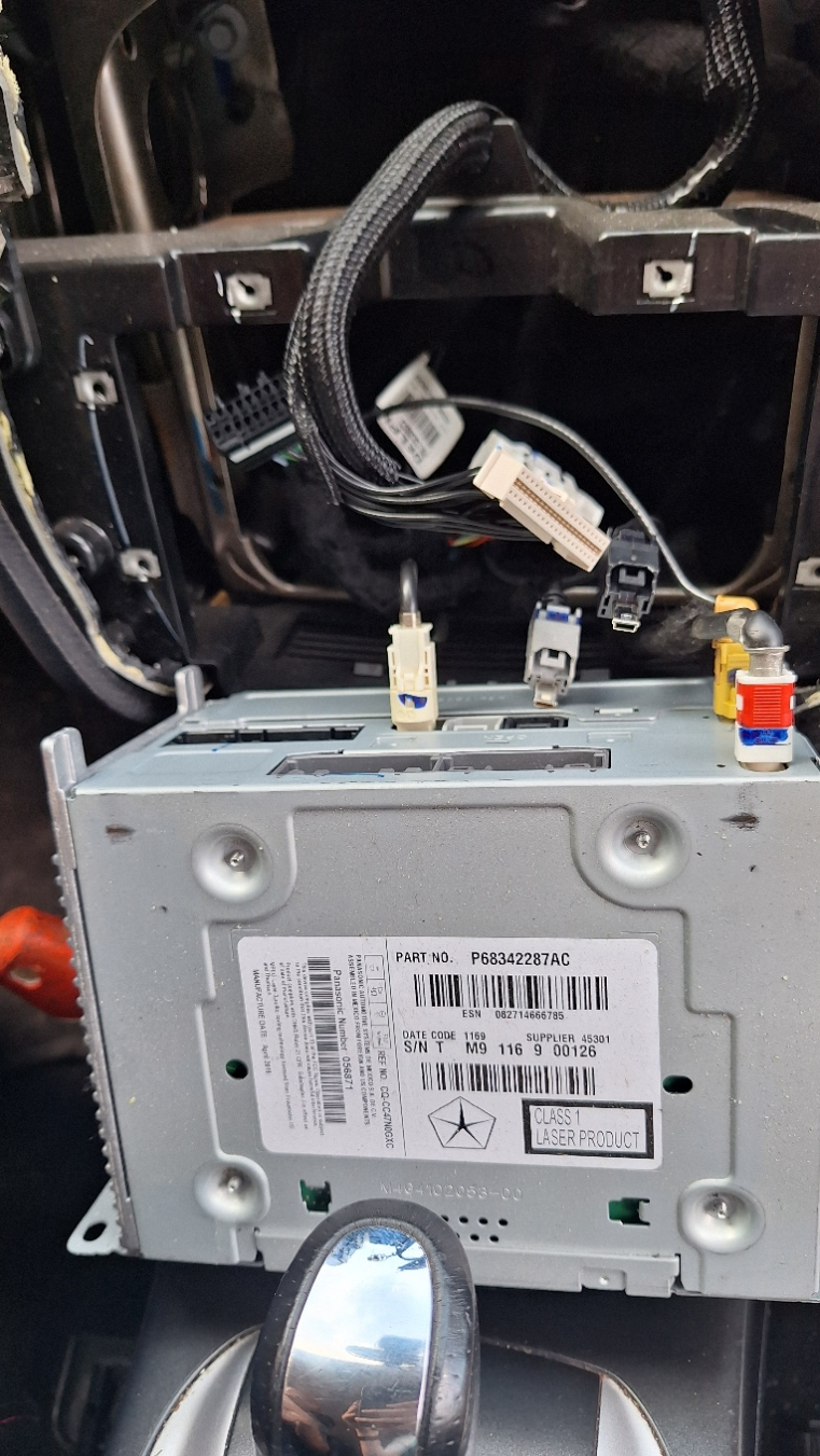

The installation was straightforward, you just remove a little trim and unscrew the climate panel:
Then you unscrew and pull out the UConnect:
Then you pull out the CD/DVD player (yes, it won't be installed back because it's a part of the old radio) and unplug the wires:
Now just plug everything into the new radio, if there's a cable that doesn't have a connection, it means it's not important.
There will be a Micro USB cable in the set, plug it into the GRAY USB from the CD player, this will enable the original USB port to work with the new radio.

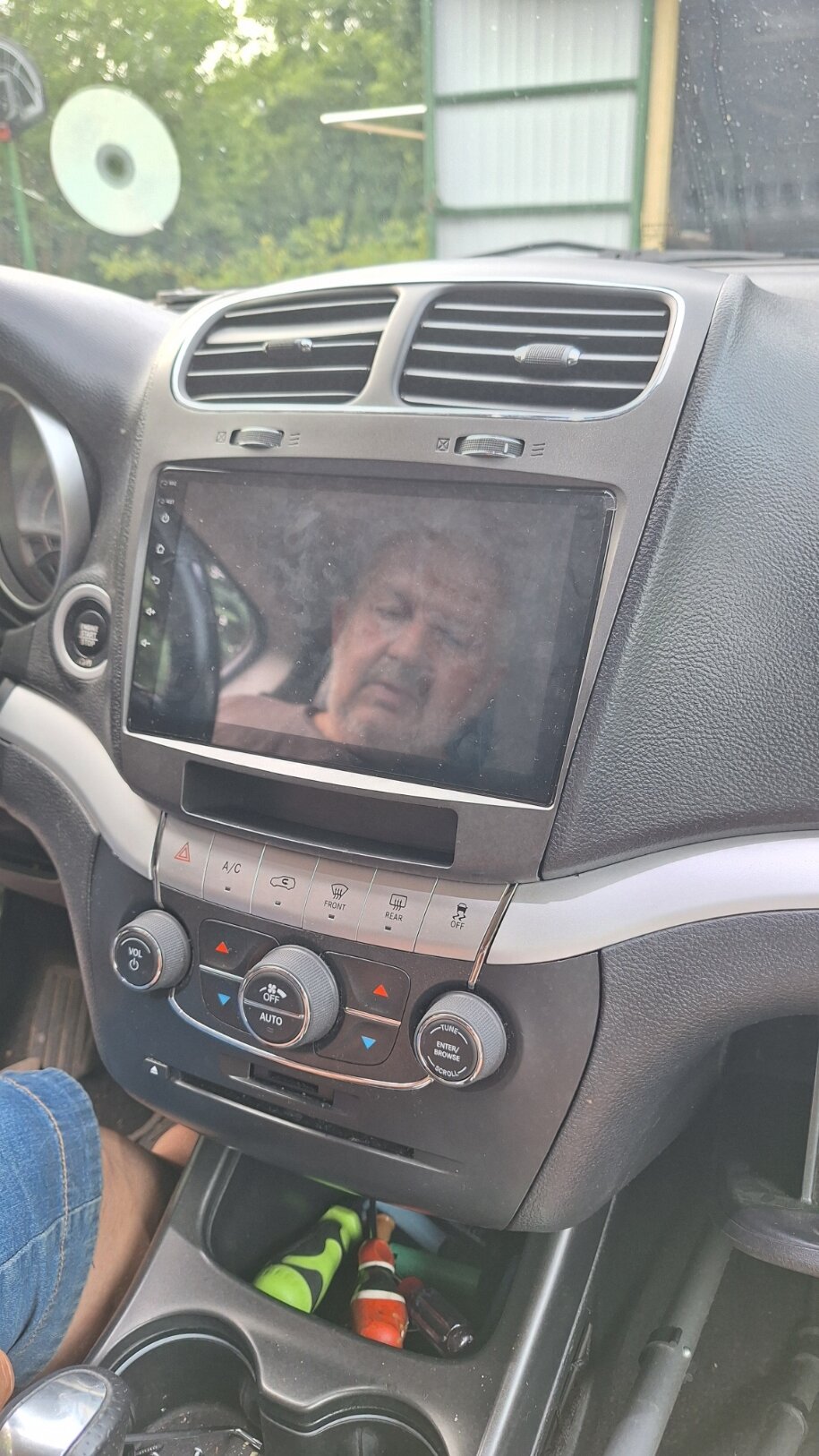

After you put it back together it should look like this:
