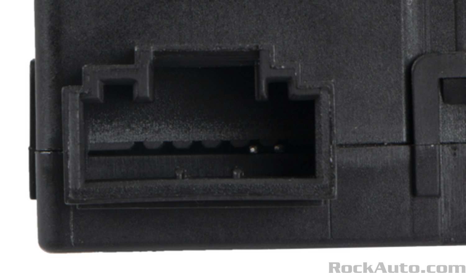

HVAC flow controlled by actuators (electrical switches) in the dash. Plastic internal gears start to stick and wear out. At least one of the 5-6 units is probably flaky. Some hard to get at behind plastic panels.  Parts not that pricy,  but because awkward access labor would be more than you think. One plug and a few Philips screws. Need to unhook battery or have someone with programmer hook up the sensors.  Make sure elect plug pins match in replacement part. OEM china switches are better than cheapo aftermarket ones. Free advice worth everything you pay for it.
https://www.rockauto.com/en/catalog/dodge,2012,journey,3.6l+v6,3015568,heat+&+air+conditioning,heater+air+door+actuator,10721
