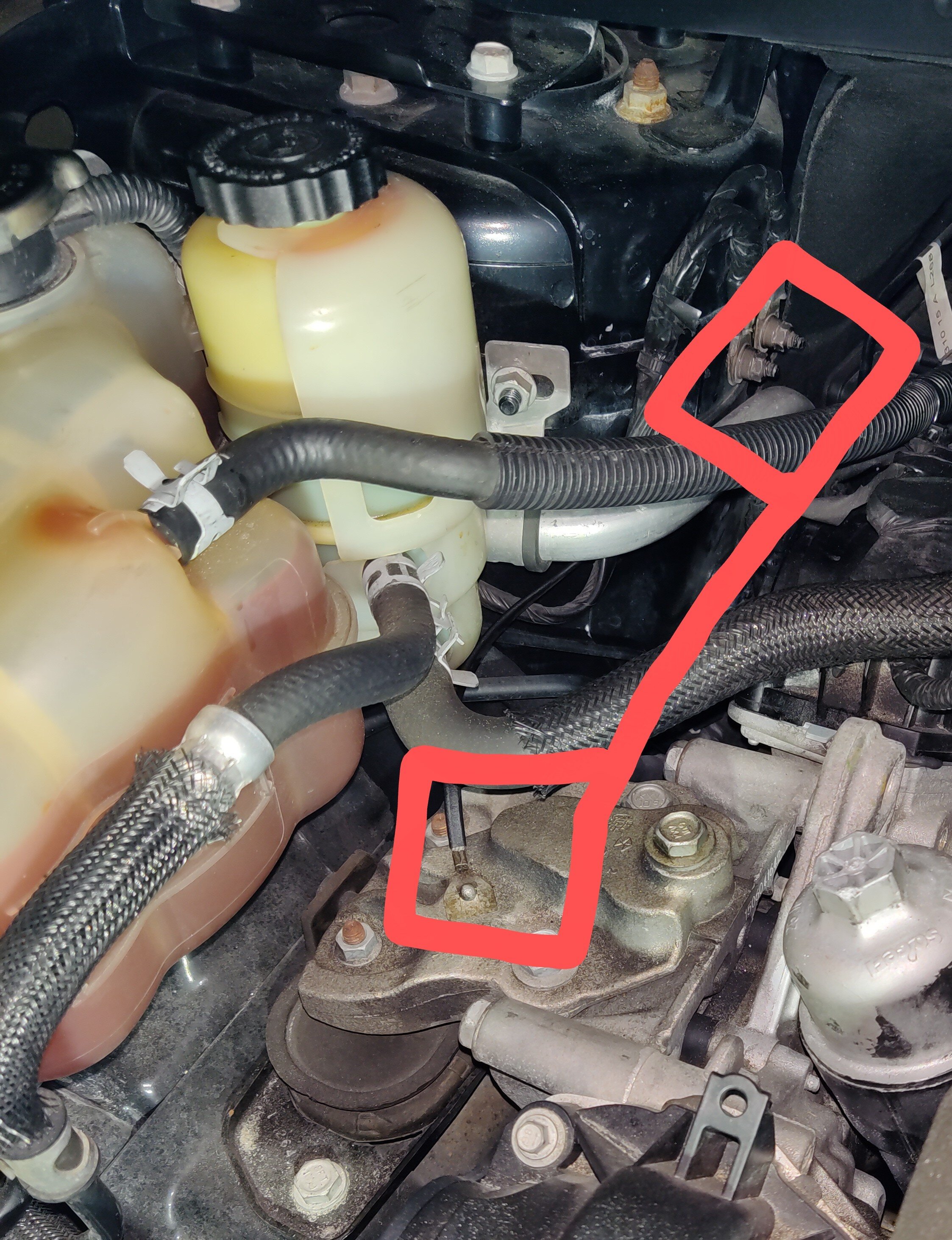

ETC Posted July 13, 2024 Report Share Posted July 13, 2024 I have a 2018 journey the pass side headlight is out no horn or coolant fan working as well,checked ground at headlight,when grounded lights work but when you hit the horn the lights flicker any ideas Quote Link to comment Share on other sites More sharing options...
Dean H Posted July 13, 2024 Report Share Posted July 13, 2024 (edited) All 3 of those use the same ground. Passenger strut tower 2 ground studs. Top square in picture. Clean them up. You should add a extra ground cable. Exactly, how I have the picture marked in orange. Use one of the studs on the engine mount. Read this post on grounds. https://www.dodgejourneyforum.com/topic/18115-electrical-system-fyi-cables/ Edited July 13, 2024 by Dean H larryl 1 Quote Link to comment Share on other sites More sharing options...
