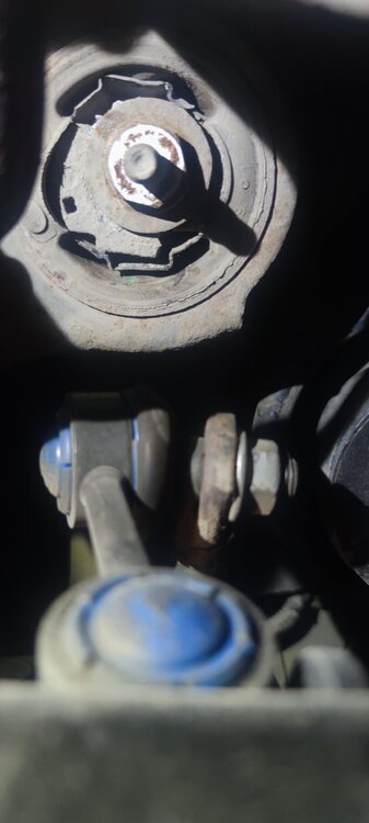

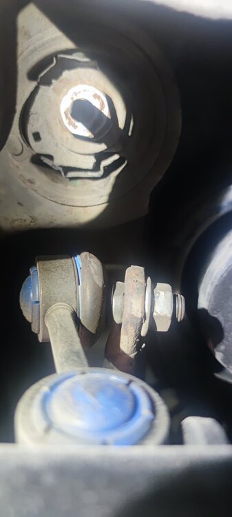

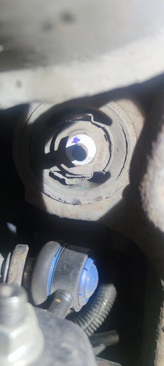

Kiril Posted July 20 Author Report Share Posted July 20 Quick update. Aft subframe, aft bushings found in very bad condition and for my it's unusual for car on this miles. Torn and corroded and the RH is cracked. I will gonna change them and will post the result. 2late4u and larryl 2 Quote Link to comment Share on other sites More sharing options...
2late4u Posted July 20 Report Share Posted July 20 well I am sure this would cause you the problems you have been talking about, just wondering did you buy the journey new?or did you buy it after the accident it was in? Quote Link to comment Share on other sites More sharing options...
