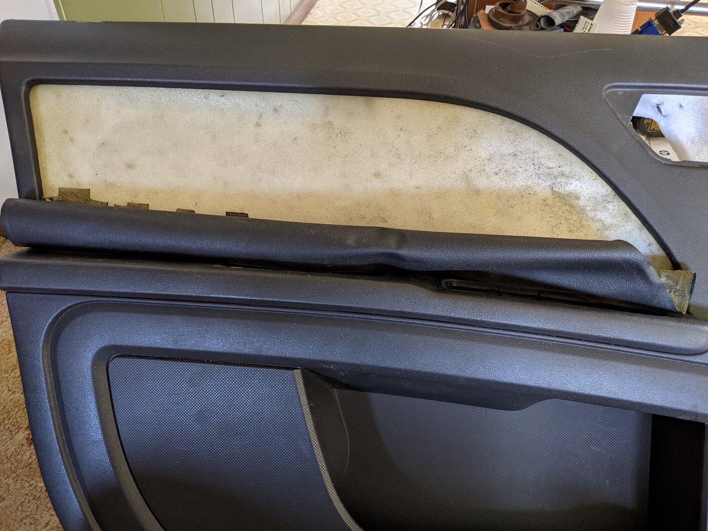

Anyone have this happen?  Up until two years ago, when the Journey was replaced as the family car, it was always stored in the garage. After that, sitting out in the sun, the upholstered section of the door panel (AKA door card) of the right side door began to come away from its backing.  If I had known what would eventually happen, I would have used a hypodermic needle to inject adhesive through the vinyl, to keep it in place. Later the left side got baggy as well, then recently it came out at the top, and laid over the window and door lock controls.
I pulled to door panel off today, thinking that I could relatively easily remove the insert panel to which the upholstery was glued, and re-do it.  Not so easy.

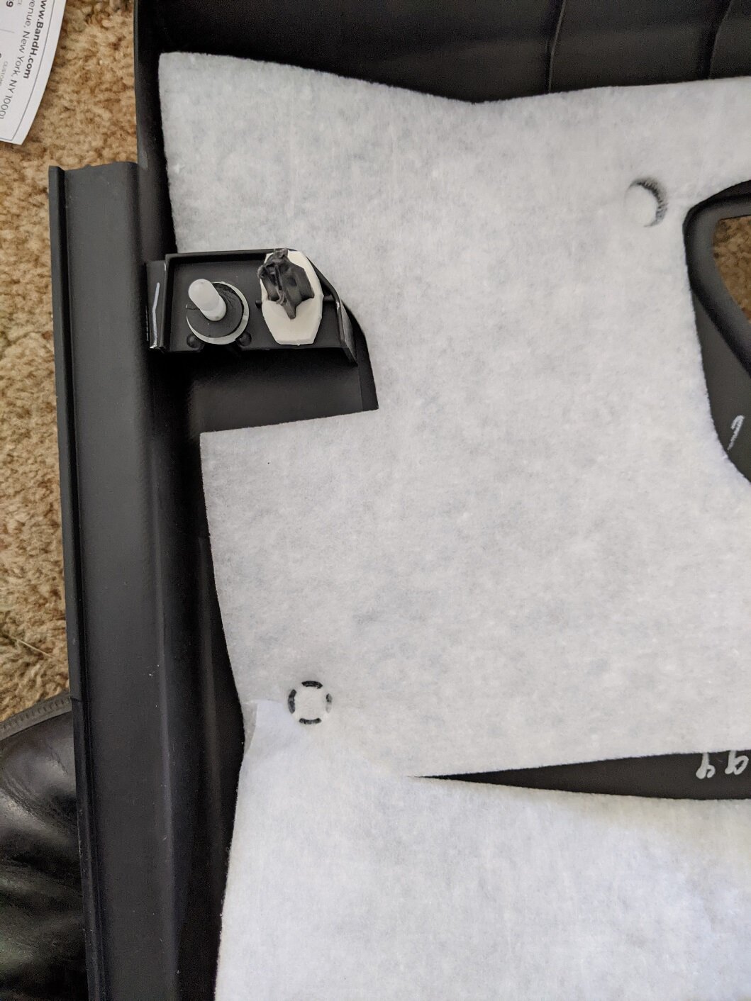

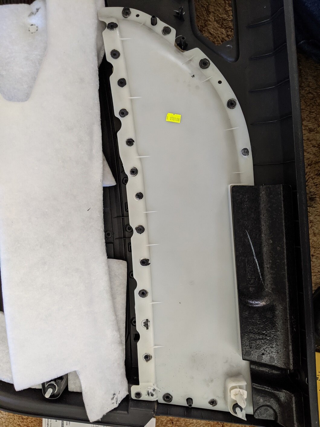

There is insulation material heat-welded to the inside of the panel - pulled that loose, figuring to use a hot glue gut. Easy enough. But this inside panel (the white part) is welded down with multiple protrusions of the main panel, pushed down under melting heat to hold the smaller panel in place.
Any suggestions on how to refasten it?

I didn't work today, because I had some sort of "episode" yesterday, and still don't feel right.  So this late afternoon I used a large drill bit to get those melted down plastic "rivets" down far enough that I could get that panel off from behind.  (I think they are long enough that I can drill them for small screws.)  If I hadn't tried to pull the upholstery completely out after it fell down over the door controls, I could have just cleaned it up a bit behind there, and glued it back up into place.  I think I could push the top edge back up into the crack, but the bottom is a lot tighter, and the material goes around some of the rivet studs.

This is rather like admitting defeat. I got some adhesive and glued the vinyl back on.  But I didn't replace the thin foam, which had totally turned into dust.  Turns out that is crucial, because the way it's all made, it needs that foam to close the gap.

Alright, I confess.  I did it anyway.  Decided to try to get it back together.  Spending money that turns out to be a waste rubs me real wrong (the spray adhesive I bought).  So I whittled on the pegs and the stop flanges that gave the foam space (kept the panel from coming down tight), and used a bunch of small short screws to fasten it down. (Drilling small holes in the center of each peg - well not all of them, but enough to keep it all in place. Used high heat hot glue to secure the insulation / sound deadening material back in place.)
