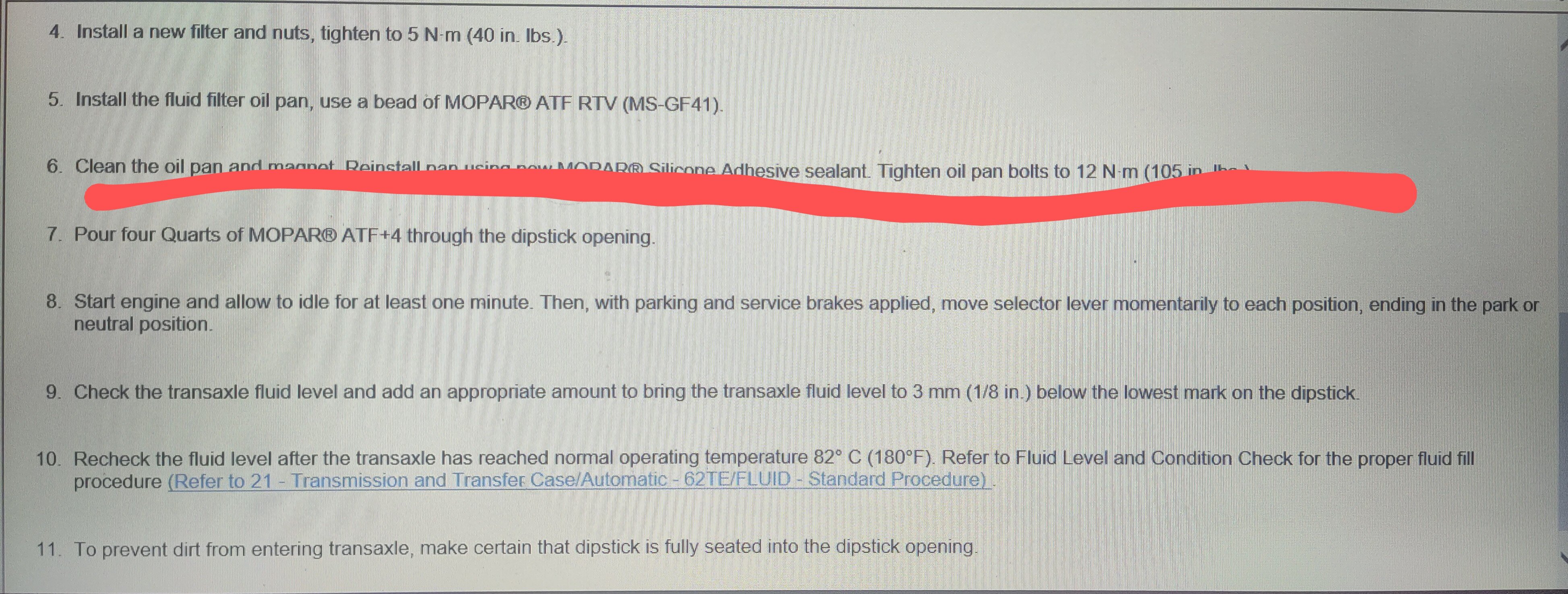

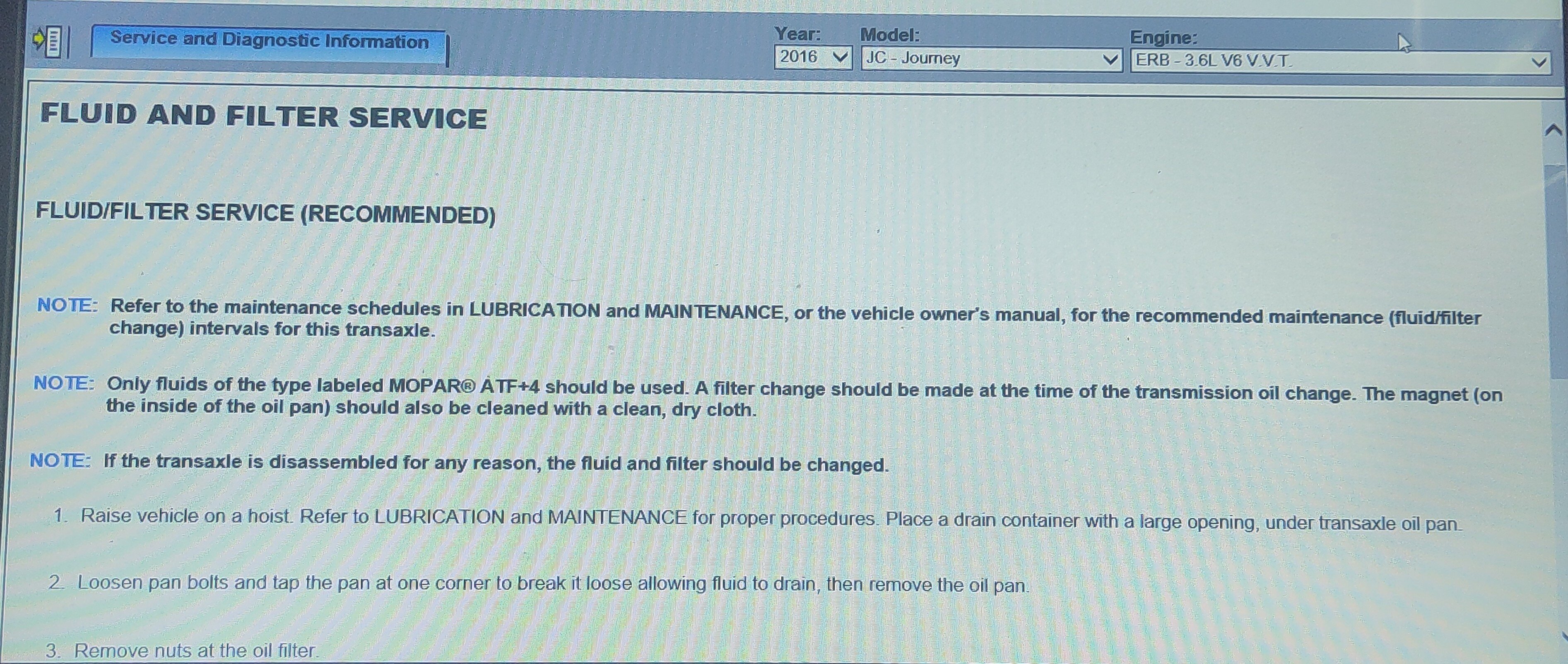

Dean H Posted July 28, 2024 Report Share Posted July 28, 2024 (edited) Recheck the fluid level- You need this transmission dipstick- https://a.co/d/iqlpIzm 2016 Dodge service chart Edited July 28, 2024 by Dean H Quote Link to comment Share on other sites More sharing options...
