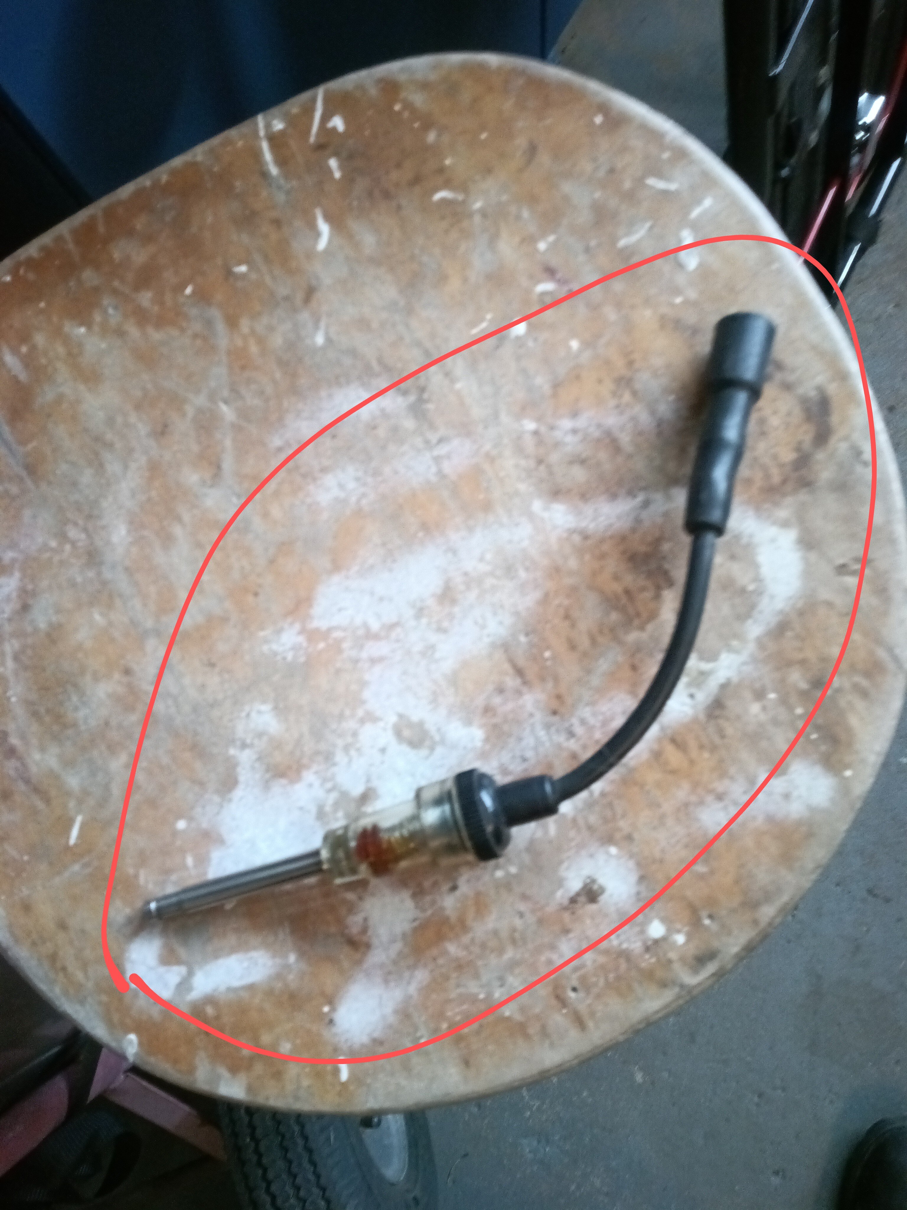

John/Horace Posted January 28 Report Share Posted January 28 Get a spark tester on a plug, even a second one in case coil issue. Make sure there is spark. If cam sensor plug only has one wire by design, I wouldn't worry about. But most sensors running on 5 volts like you have measured. What year is the 2.4 donor engine. Journey is 2009-2018 yrs. 5rebel9 on this site mentioned older 2.4 version of this engine having a different crank sensor set up, something about the reluctor ring location. Search it out or ask him. Donor needs to be very close in age to the 2014 orig engine to be compatible. If there is spark there and manual fuel added not firing. Move on to compression then timing. Pic of cheapo spark tester. Quote Link to comment Share on other sites More sharing options...
