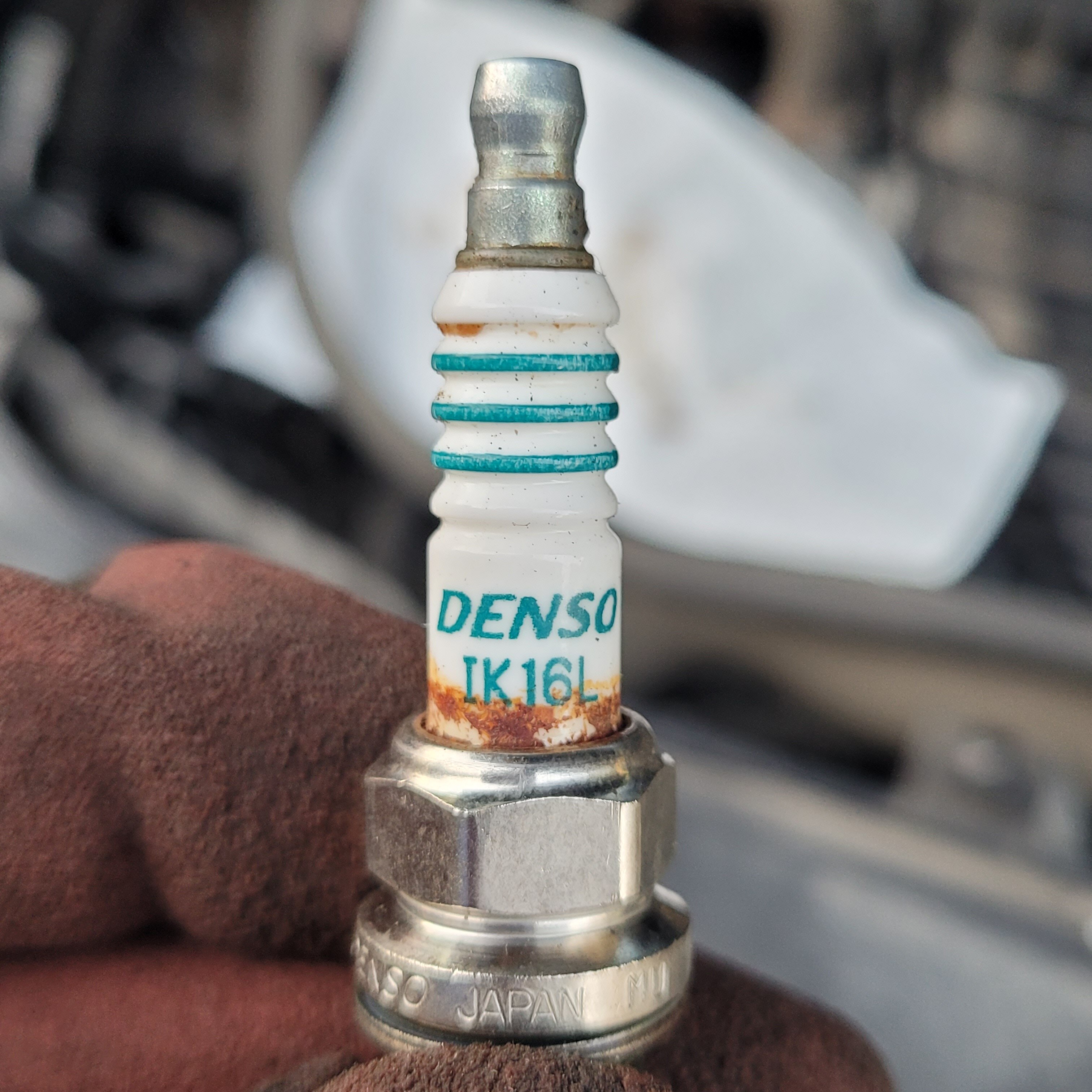

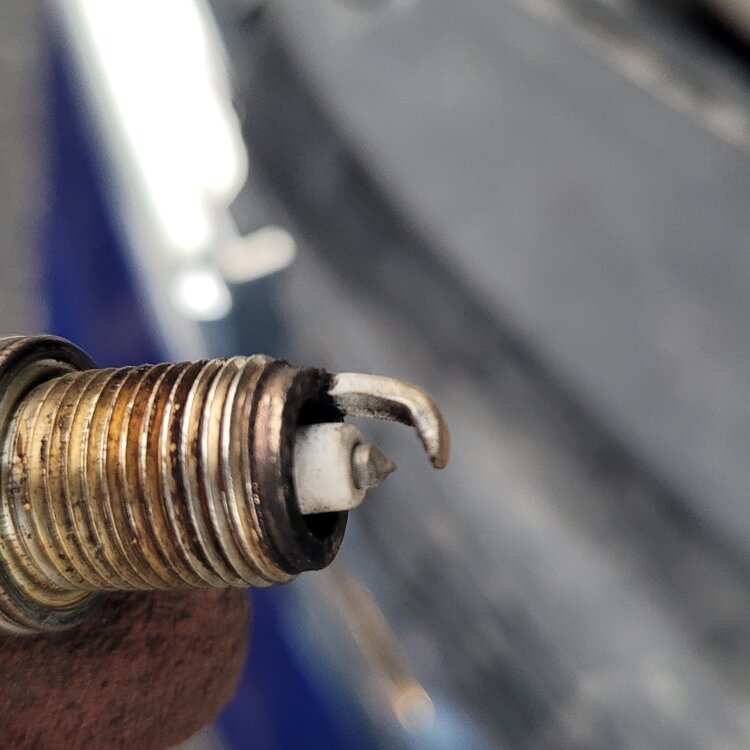

Just removed irredium Denso plugs @ 100k kms-70k miles from 2.4 engine

No hesitation or fuel economy issue. Could have regapped  used plugs but decided for new NGK single plat cheaper plug. Lots more info on BITOG site.  My pics of used plugs below. Still running orig coils at 165k kms(100k miles),  dash gauge fuel rating was showing  9.6/100 kms, normal.

521BCEFC-2D96-4940-8DE3-F3D2044E303C.thumb.jpeg.d7e11aed3a174176aa8752f733fe0478.jpegA9761C61-9538-480F-A7D4-08F6A85C5A69.thumb.jpeg.e09a5185325249a9b91bb6146d47df0a.jpeg
