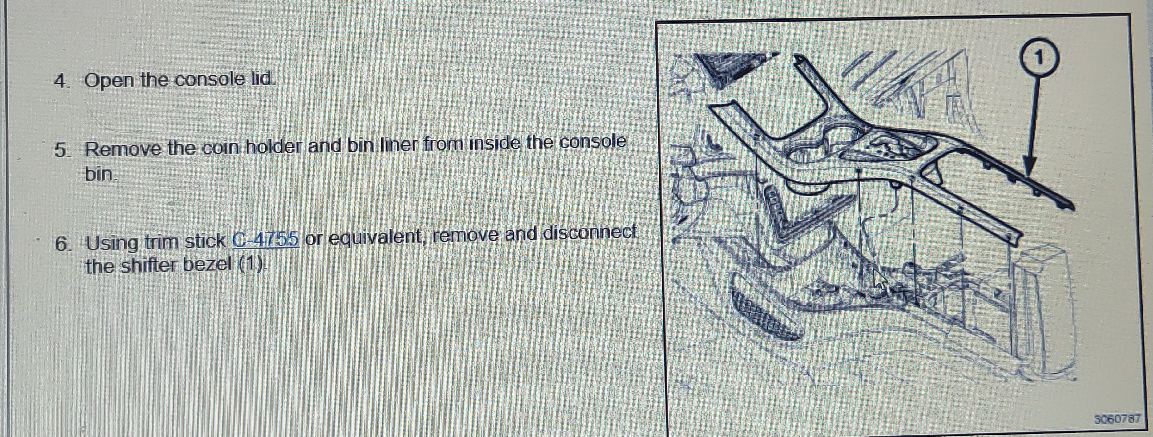

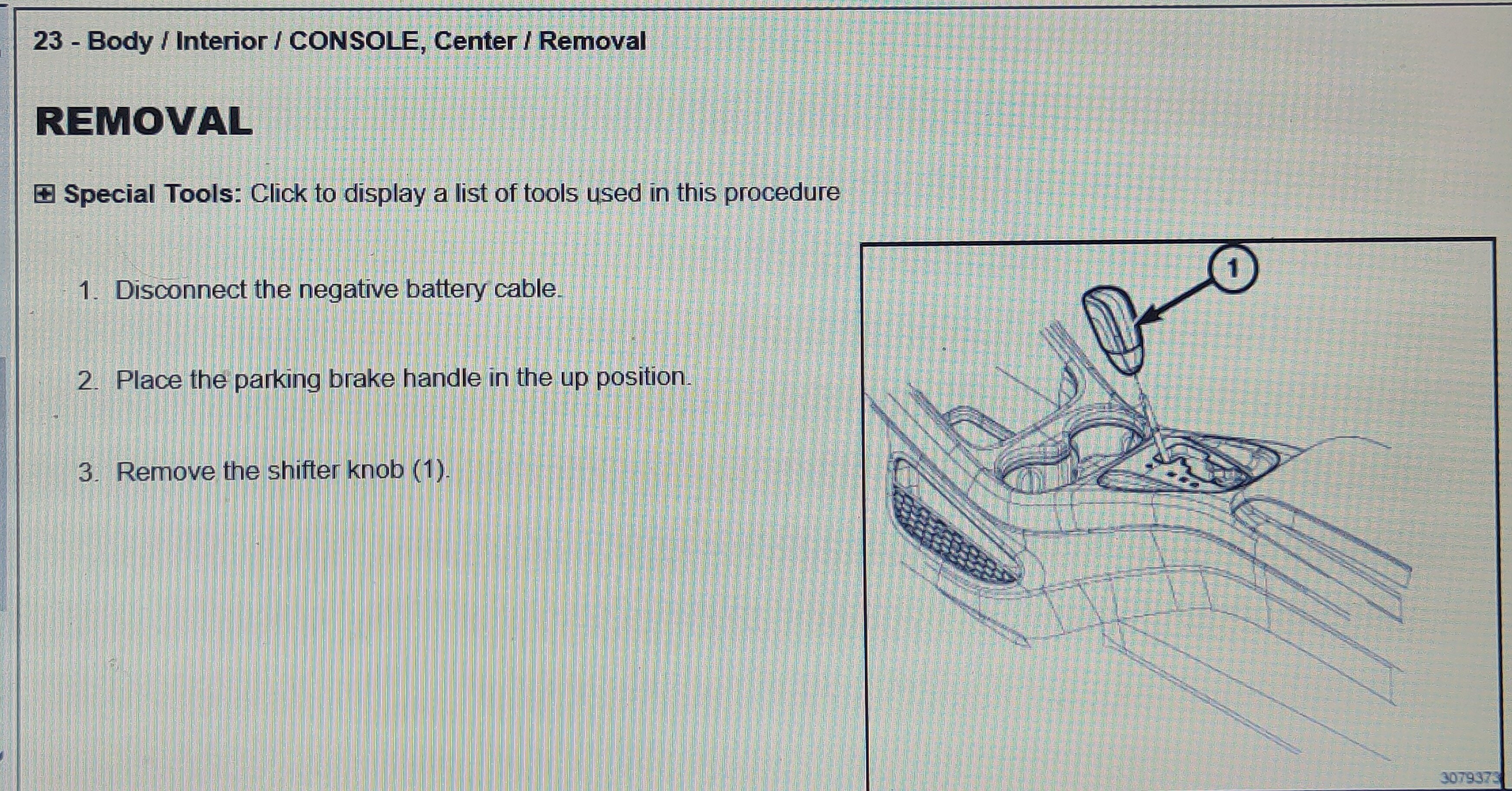

How to remove the console top piece.
Trim tools needed are-
https://a.co/d/bpgHBUq

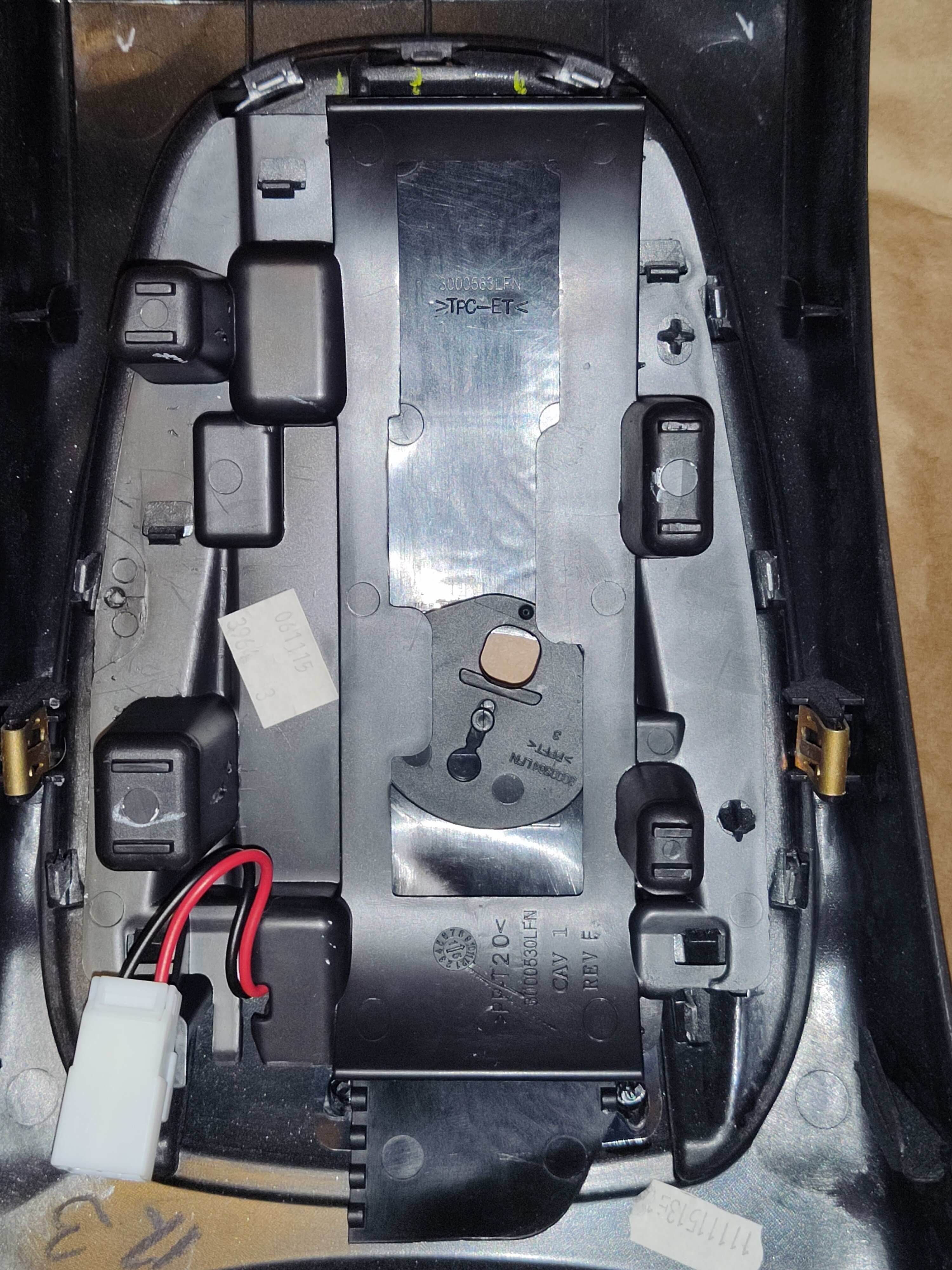

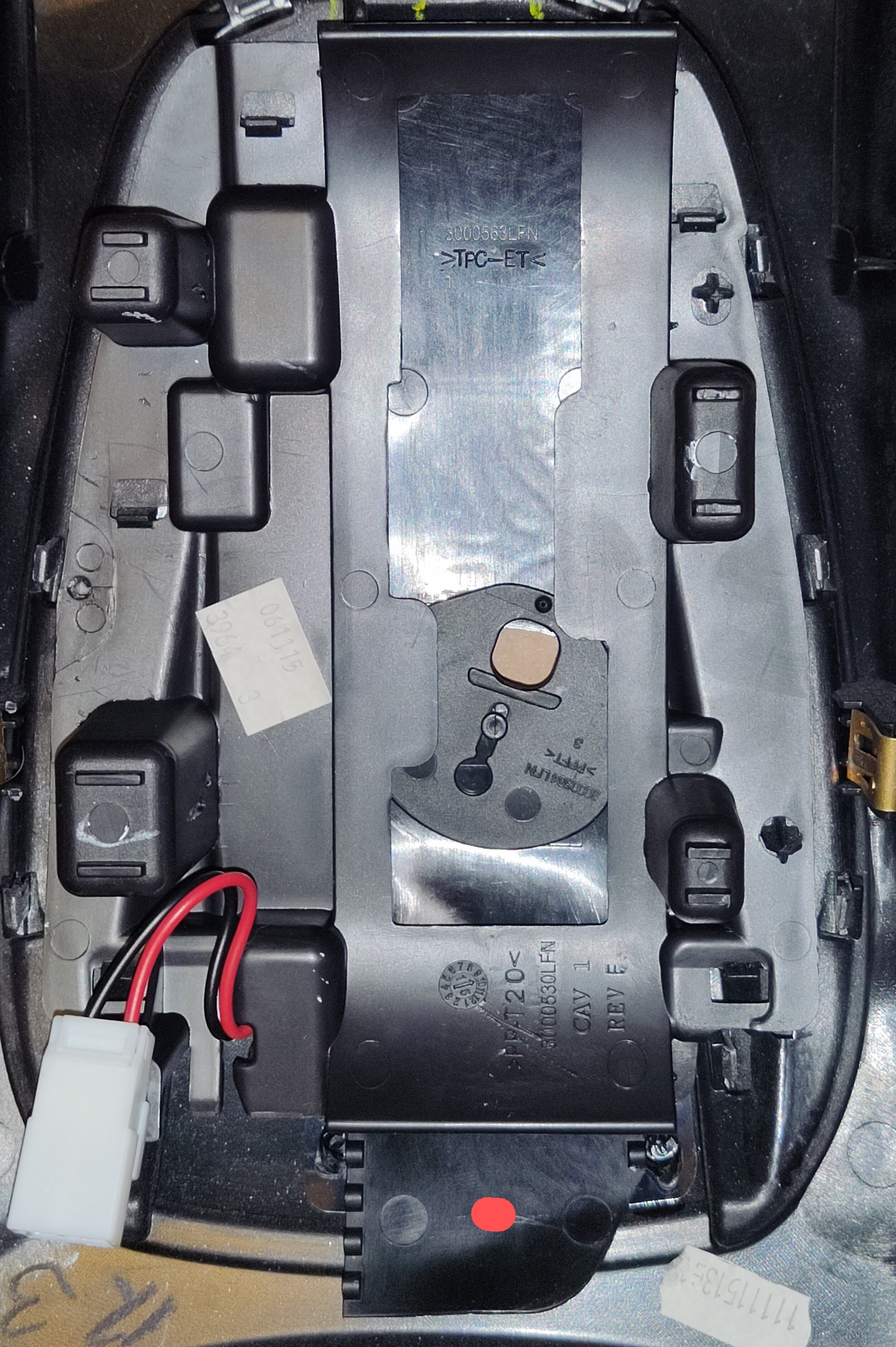

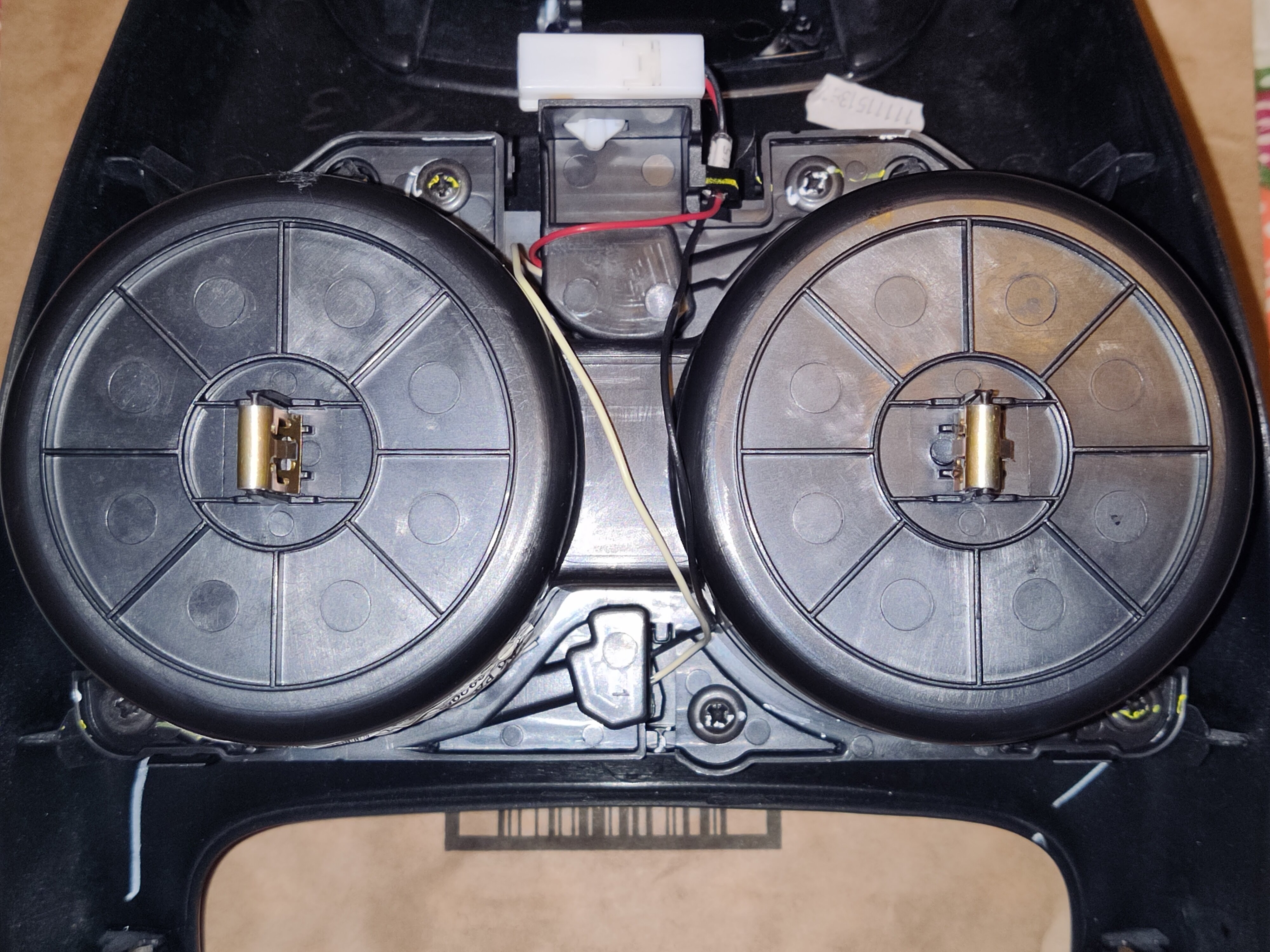

        There is 2 electrical connectors to disconnect, before removing the console
piece.
Comes off pretty easy. Go slow so you don't snap off clips.
The cup holder assembly screws into the console.
It unsnaps very easily. Handle carefully! Cleans up real nice.

The shifter part unsnaps as well. The gear indicator lights
is a one piece assembly.
The silver trim around the shifter. That was pretty difficult to release.

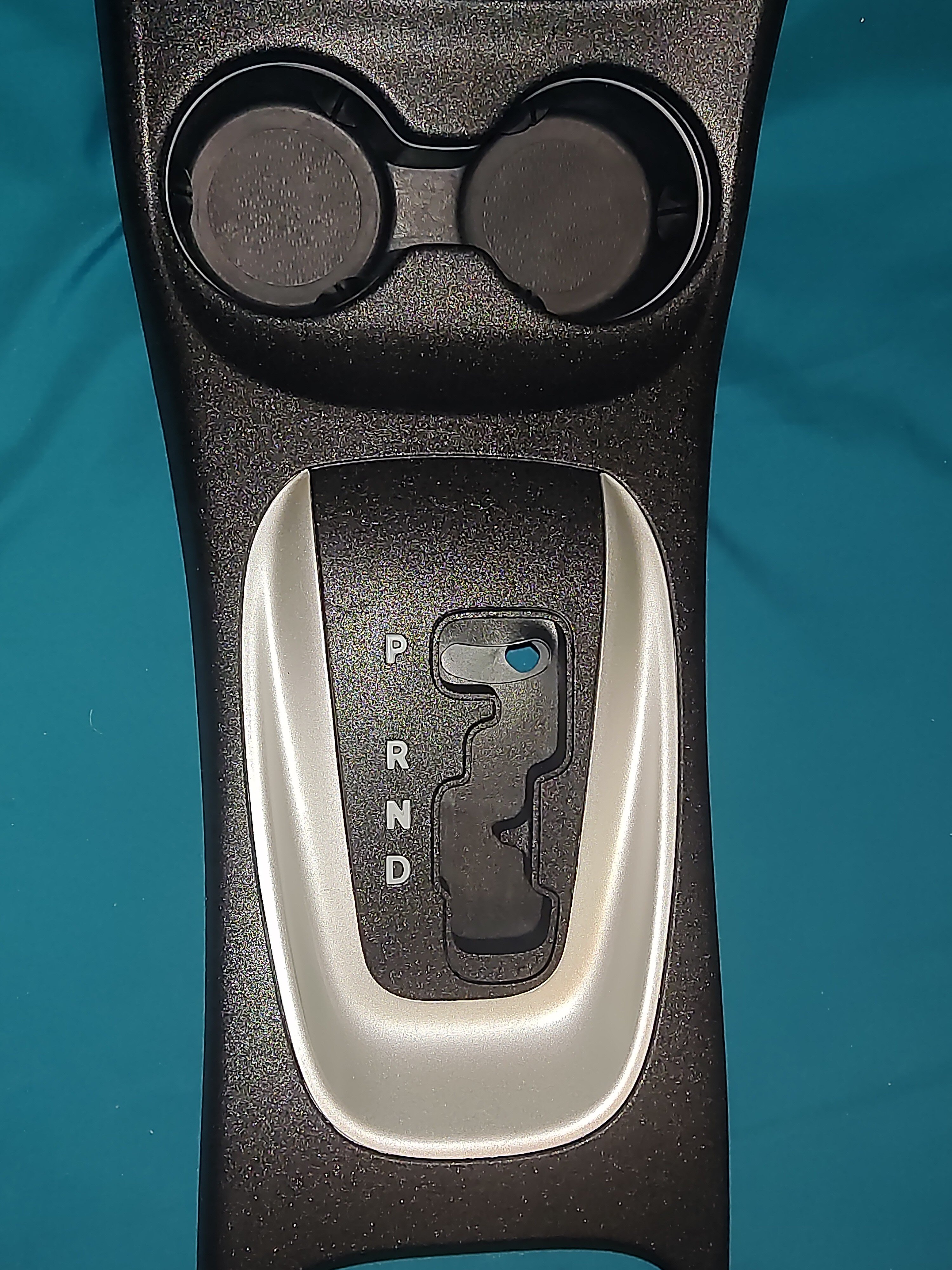

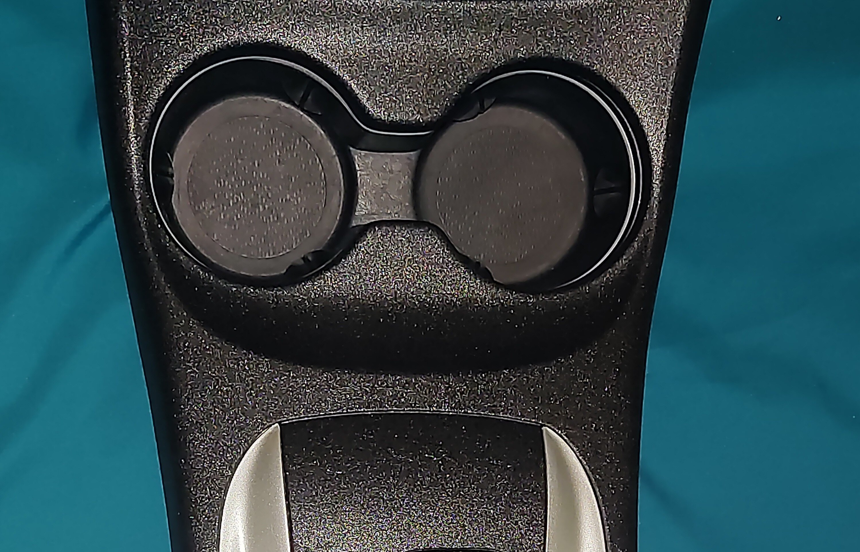

I cleaned the whole piece
with alcohol. No other prep.
Then sprayed about 3 coats of Rust-Oleum basic bed liner.  It is really sticky with a light texture. Gloss black.
Side note you can spray another color on top of it.
https://a.co/d/7hmFztc
Perfect for interior.
I used it on my wiper arms and all cowl pieces.

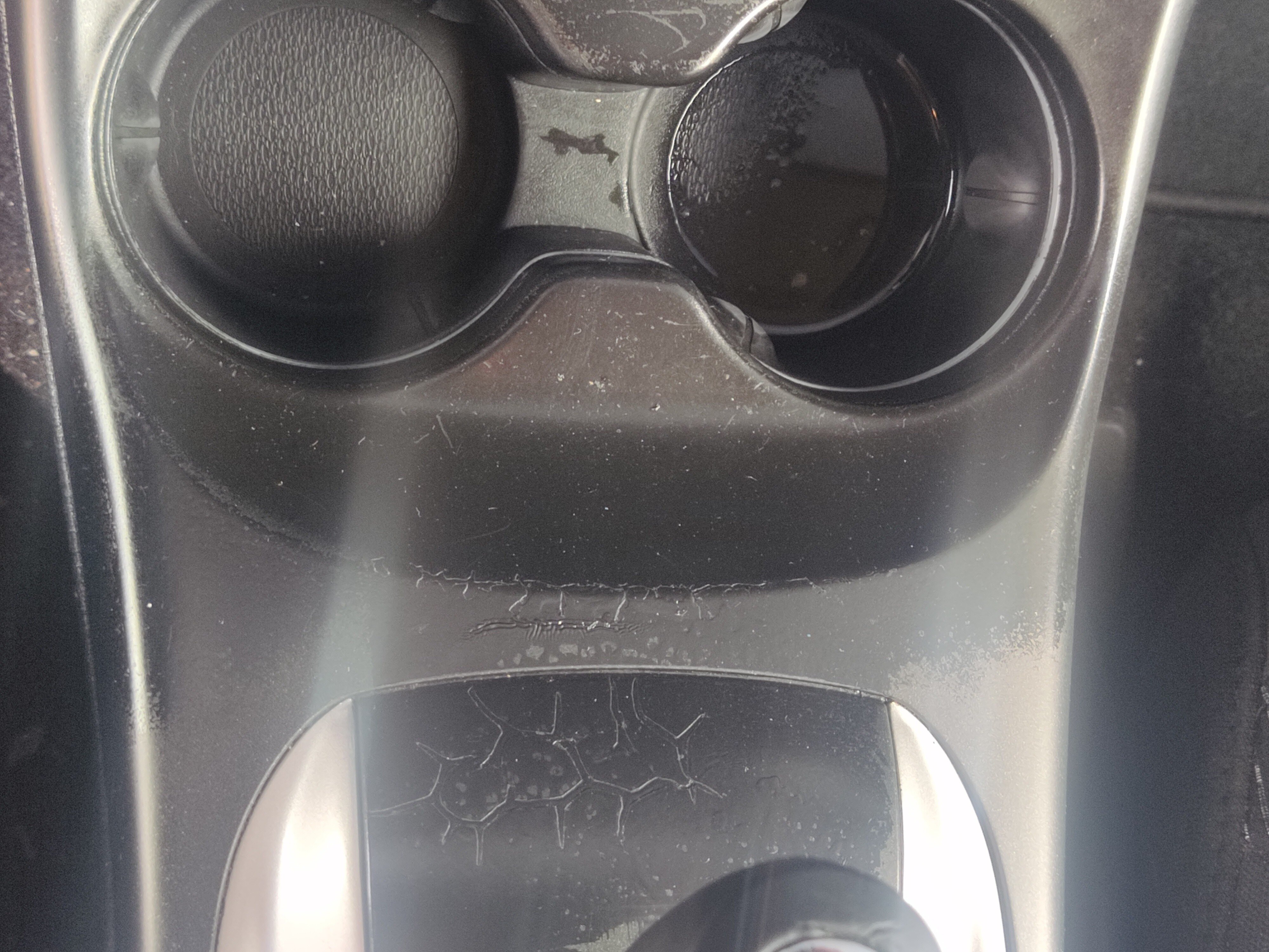

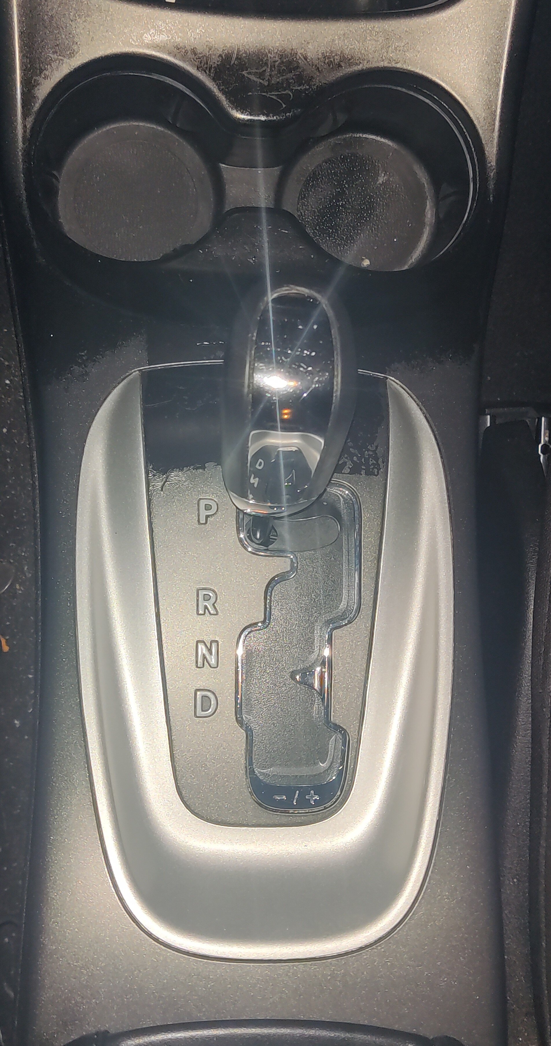

Before -
Before -
Dean

Curious about the shifter slide gate. Needs to move every time you use car. But not that visible really. Texture might impede slide. Are you planning on just using  shiny clear coat spray, or is to minor to worry about really. Eye mainly focuses on very new looking console cover.
I agree with you on learning trim stuff.
Good point regarding the shifter slide gate.  It just slides out of the console.
Pull on the orange dot.
I only used armor all on it, to clean it up.
For cleaning the console you have to use a interior brush on it.
Because of the texture, you can't use a cloth.
Basically my goal is to use
what is there. Patch it up
as needed.
Make it look the best that it can.
I'm happy with how it turned out.
