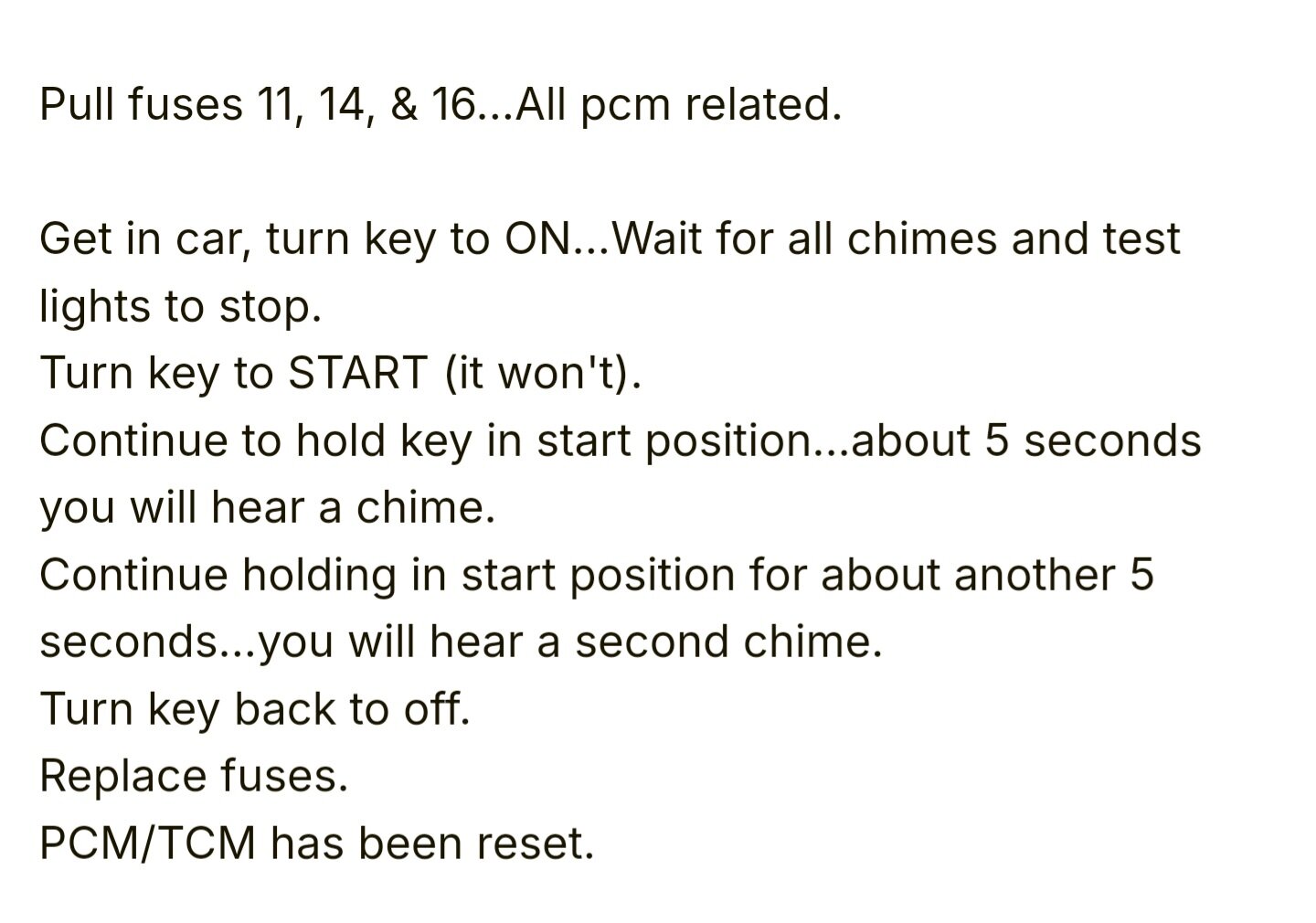

CaveManJedi Posted September 4 Report Share Posted September 4 On 8/15/2024 at 2:13 PM, Jmoseley336 said: As the title States I have a intermittent po394 code that randomly shows up, sometimes I can drive for a day or two without it coming on. Timing is perfect, already tightened the bolts behind the VVT solenoids etc. Where should I look now? Reset pcm and tcm. Just make sure you pull every fuse that's labeled pcm or tcm. Quote Link to comment Share on other sites More sharing options...
