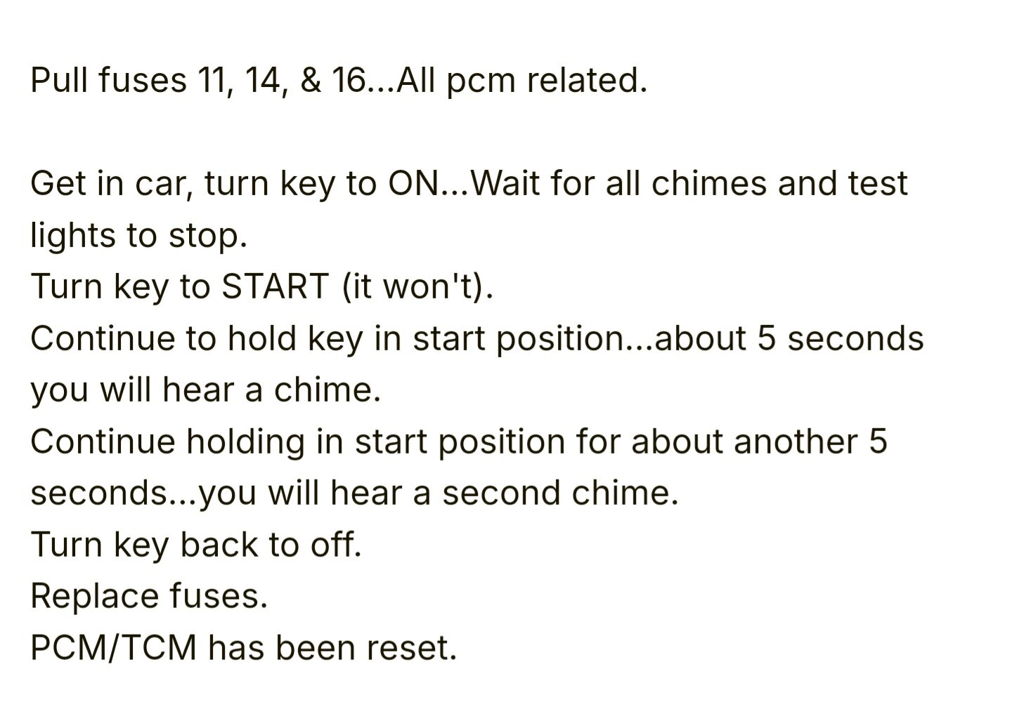

Did you do a hard reset to your pcm and tcm? I would try that, especially since you changed those sensors. I'm sure the fuses have different numbers just pull every fuse that is labeled pcm and tcm even the big square one. I had four fuses that were connected to my pcm and tcm.
I had to buckle up also.
