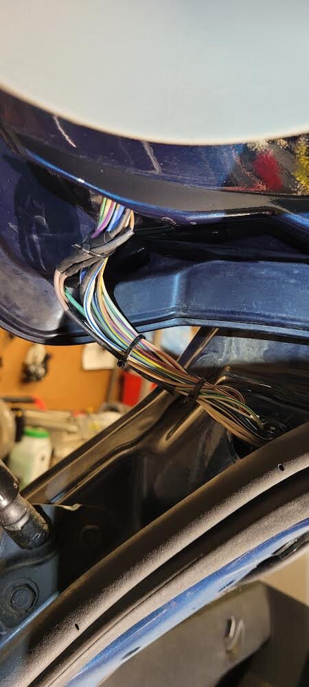

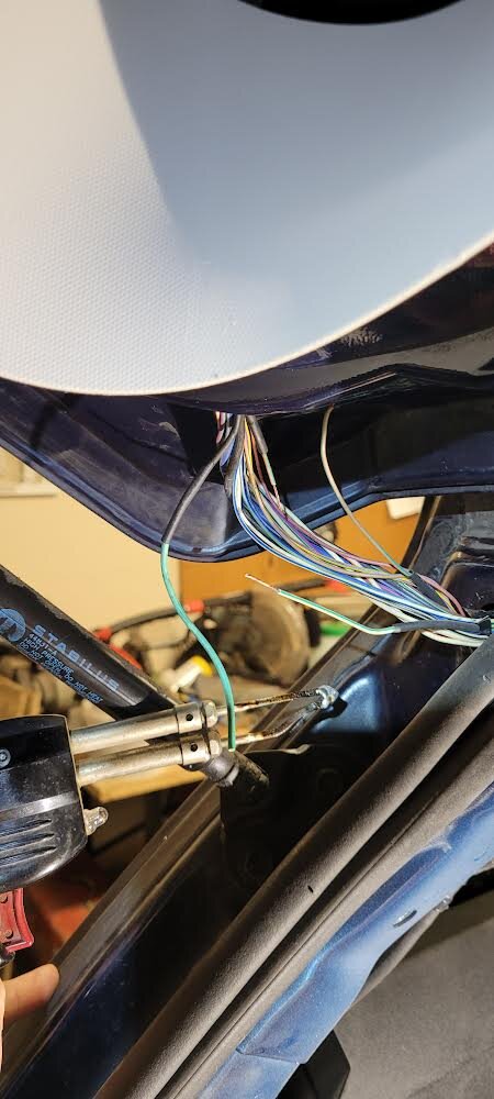

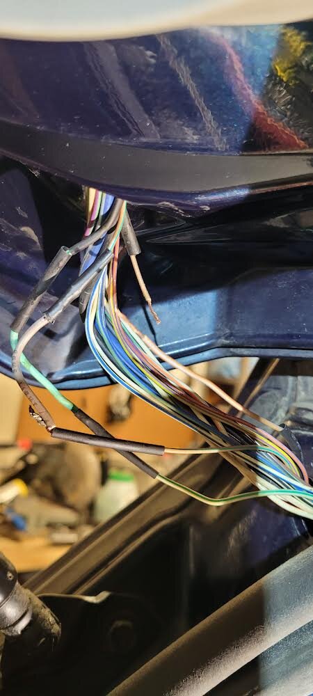

Once it’s open you may have to deal with the wires in the rubber sleeve feeding into the top of the hatch.  It’s a common issue for the wires to get bad enough to stop sending enough voltage for lock solenoid etc. The rear led hatch brake light also loses power eventually and the outside hatch lock/unlock activation button. Lots of posts on site about fixing it. Electronic solder, gun, some 14 gauge multi strand wire and heat shrink are needed.
