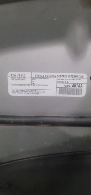

CaveManJedi Posted August 30, 2024 Author Report Share Posted August 30, 2024 On 8/29/2024 at 12:59 PM, 5rebel9 said: How many miles on the car? What driving conditions, city or open road? Poor fuel mileage trans fluid/filer changed? Could also be suspect of plugging up cat converter. As I originally said...it sounds like you have other problems, not IMRC Edit : for us with older DJ's.... which trans is in your '19 the 4 or 6 sp? Expand So I changed the pcv valve, and installed the crank filter. Don't know how much it's accomplished gas mileage yet, I'll give it a day to get a good read. Sluggishness wise, it still slugs. Lol. I haven't replaced the short ram pipe yet. But when I do I'm gonna redirect downward more and install a heat shield completely around the filter except at the bottom so the air will be coming from under the car. I'm reading pretty high temp on my intake air temp. It got up to 100° today. And I was reading mid to upper 90's iat. Even on the interstate. Hopefully I'll get better temps after I change it up. But what I have further found out is that it's a CARB emissions vehicle, not a federal. I'm 40, and everything I've ever heard about California emission regulations on vehicles make them run like shit. I've done a little research and it's half and half. Half say this, half say that. I'm sure emission stuff like sequential fuel Injection and a heated o2 sensor aren't the problem, but could the three way catalytic converter and exhaust be the issue. And are there other emission stuff that could effect performance. Ive lived in memphis my whole life and have never had a CARB emission vehicle before. Quote Link to comment Share on other sites More sharing options...
