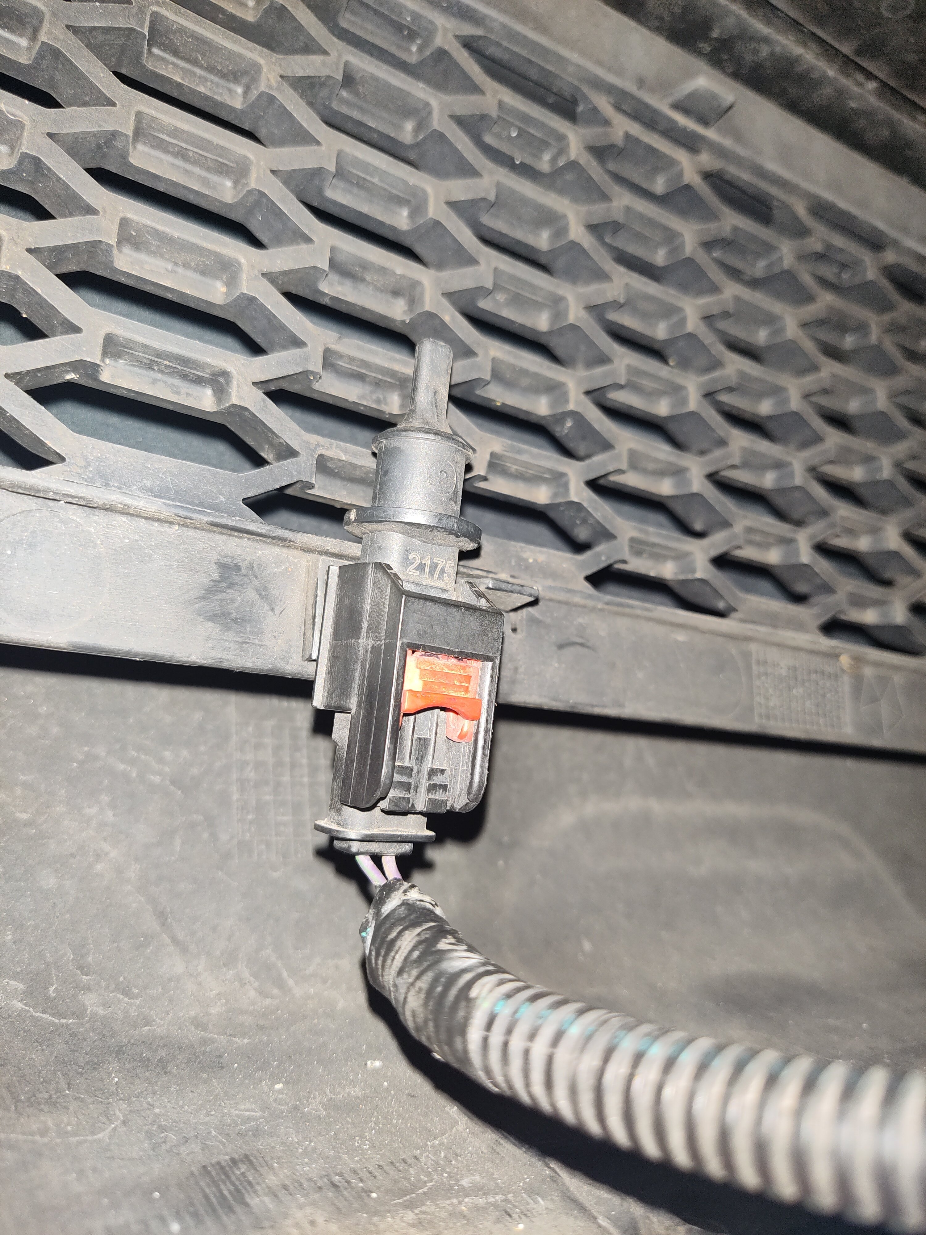

Dean H Posted September 2 Report Share Posted September 2 P0073 Ambient air temp sensor circuit voltage high. Check this- Ambient air temp Sensor bad. Sensor wire issues. This is the ambient air temp sensor on my 2016 DJ. Located behind the lower air intake on the front clip. Quote Link to comment Share on other sites More sharing options...
Dean H Posted September 2 Report Share Posted September 2 To reach the ambient air temp you have to remove the inner lower plastic panel. Beneath the radiator. Pull the whole temp sensor assembly out of the front clip. It snaps into place. Then disconnect it from the wire harness. This is the fun part 😄. Do not pull on the wires. Quote Link to comment Share on other sites More sharing options...

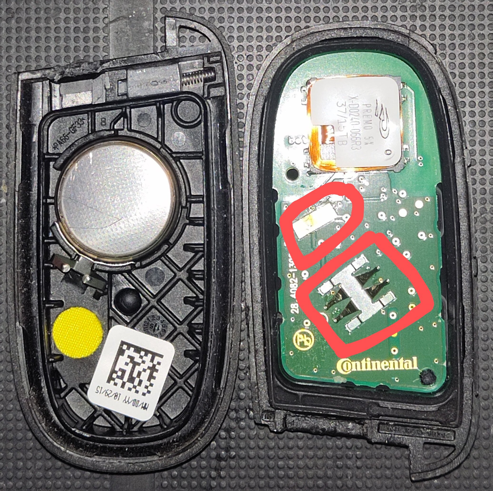

Dean H Posted September 2 Report Share Posted September 2 FOB- I am currently reading up on the FOB system. Start simple - Battery check voltage. Battery correctly installed. Check and clean battery connections. Q tip works. See picture below on what to check and clean. You might want to try a new FOB. Go here for a programmer and key fob. I did this and was very easy to do. You need one working FOB. https://tomskey.com/products/chrysler-dodge-jeep-and-ram-simple-key-programmer-for-smart-key-fob-cdsk-e5trz0sk-kit Quote Link to comment Share on other sites More sharing options...
