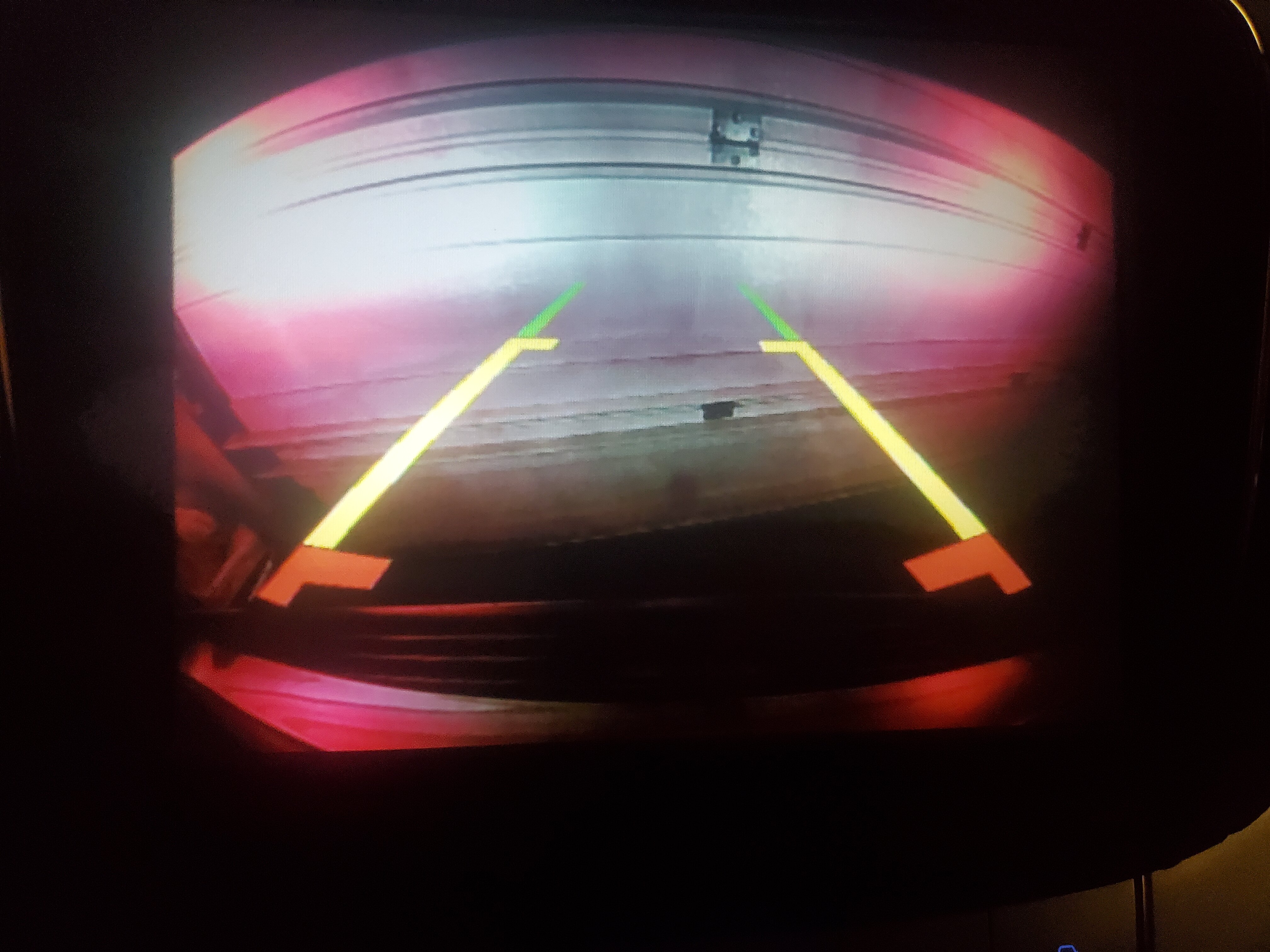

diymirage Posted September 11 Author Report Share Posted September 11 Here's a before and after, judge foe yourself (I can't wait for the tonite to see how it really does) Quote Link to comment Share on other sites More sharing options...

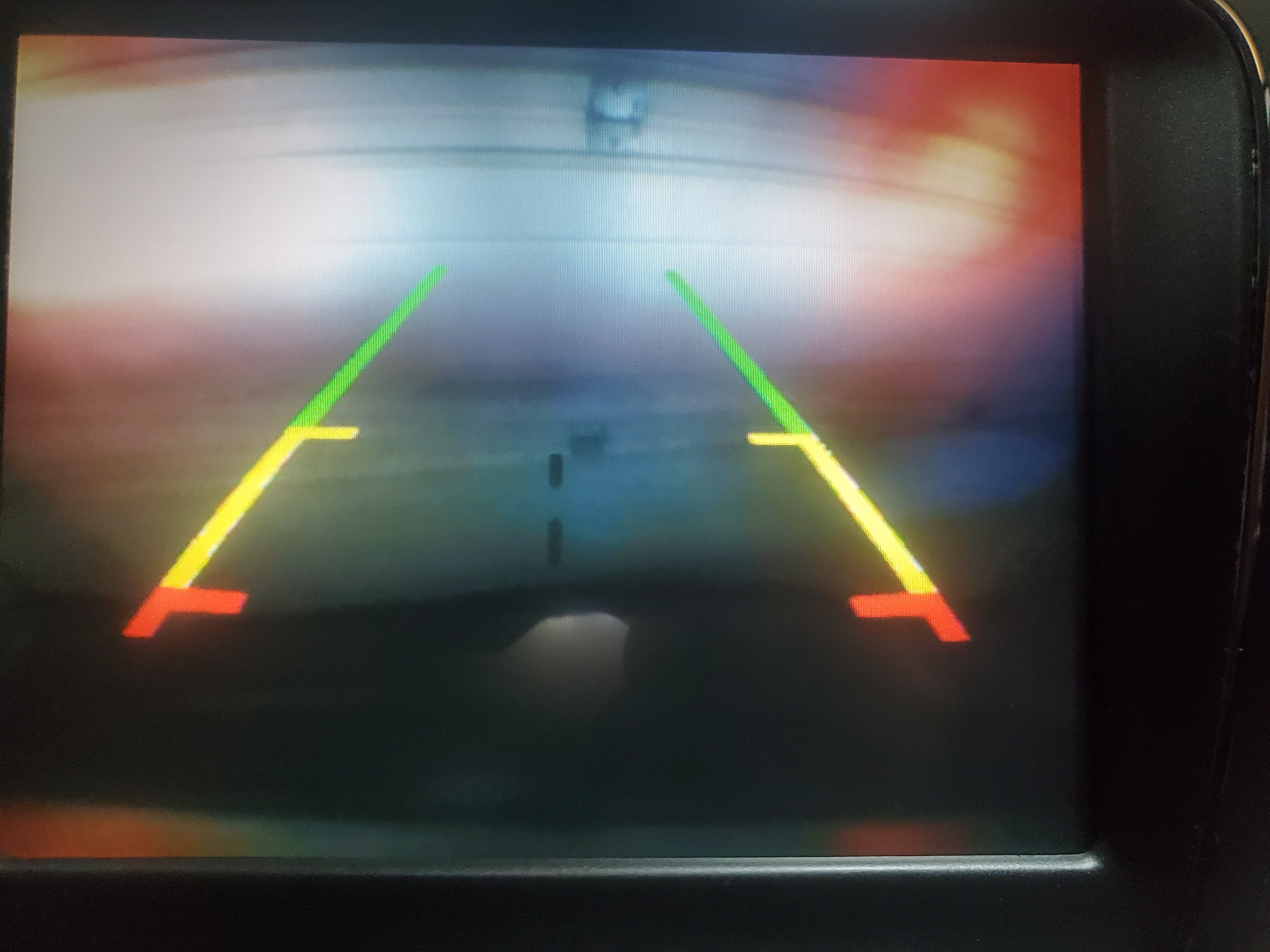

diymirage Posted September 11 Author Report Share Posted September 11 And after Quote Link to comment Share on other sites More sharing options...
2late4u Posted September 11 Report Share Posted September 11 hard to tell from those pit but should be a lot more clear, wait till you get outside where there will be no reflection off your closed door Quote Link to comment Share on other sites More sharing options...
diymirage Posted September 11 Author Report Share Posted September 11 Take a look at that hinge (just off center on the top) , it is way les fuzzy now Quote Link to comment Share on other sites More sharing options...
diymirage Posted September 11 Author Report Share Posted September 11 Oh, while we're talking about cameras, are those grid lines supposed to move when I turn the wheel ? Quote Link to comment Share on other sites More sharing options...
2late4u Posted September 11 Report Share Posted September 11 (edited) 1 hour ago, diymirage said: Oh, while we're talking about cameras, are those grid lines supposed to move when I turn the wheel ? no they don't move,,,just wondering did you buy OEM from the dealership or aftermarket camera lens and from where? Edited September 11 by 2late4u Quote Link to comment Share on other sites More sharing options...
