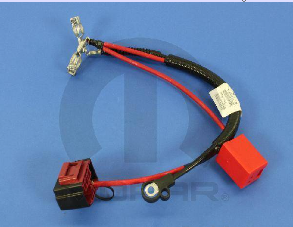

I looked up the battery cables for the 2010 DJ. 2.4 and 3.5 engines.
The ground cable is separate.
Simple to replace go standard 2 AWG cable.
Critical factor -
The positive cables you need to see how they connect inside the plastic connectors.
If you do have this cable arrangement. Get the best pictures of the red cable inside the plastic connectors.
See if it is lug ends connected to a bolt.
You could put a set together.
Complete stock cable harness starts at $155.00.
