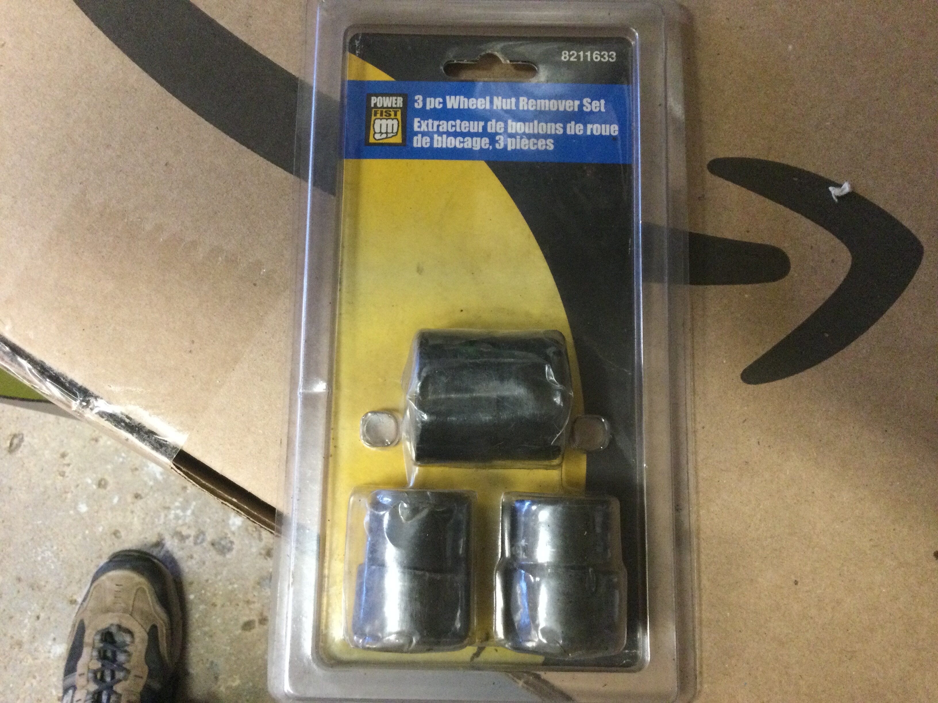

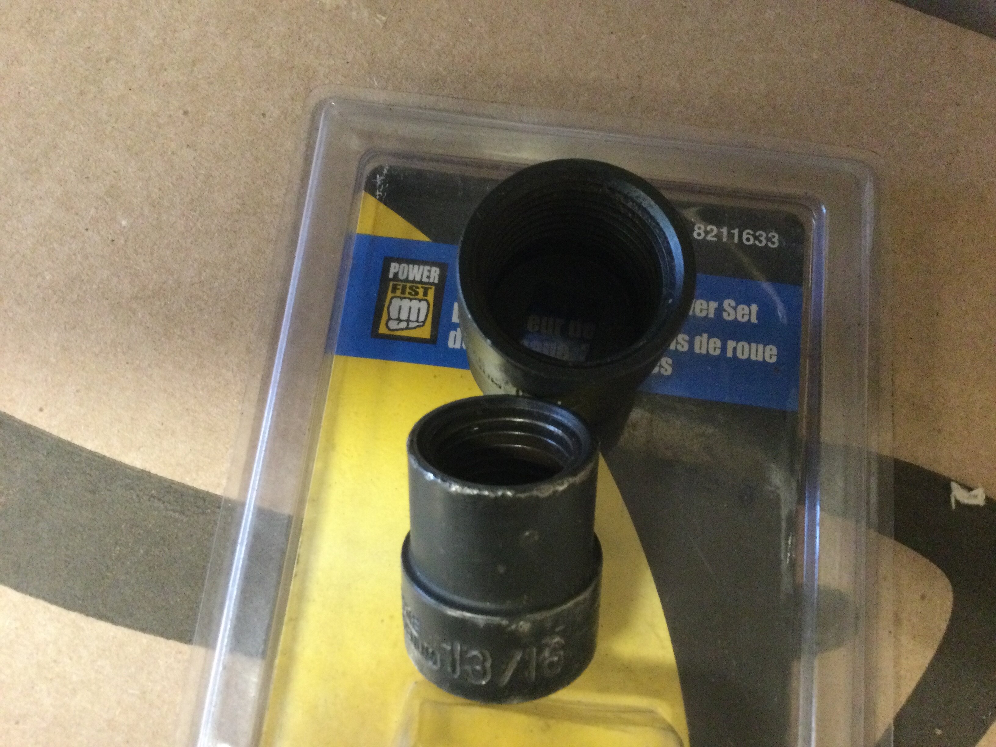

Seized nuts can be removed with a special knurled socket designed for that. Harbour Freight/ Princess Auto sell this this type of thing. Better than wrecking a good socket with a hammer. If search on site worked properly you could look this up, I’ve posted it before.image.thumb.jpg.b2114d73e0c0e150b7c4b8031a6e440e.jpgimage.thumb.jpg.910c21865b8daf6631624e495d3231d3.jpg
