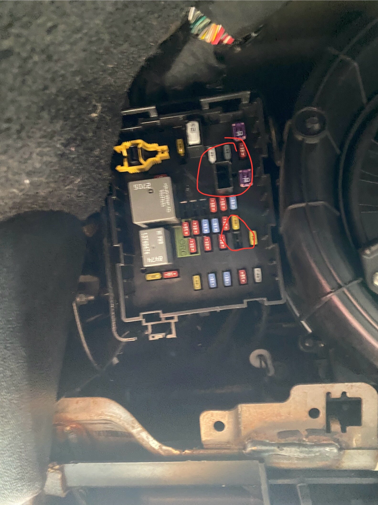

Brantbandit Posted Sunday at 04:17 PM Report Share Posted Sunday at 04:17 PM A few years ago we were having some electrical problems with the seats in our journey and ended up pulling g a fuse and a relay I think. Now I want to try and troubleshoot the issue but can’t find the stuff we pulled. Can anyone tell me what to buy for the missing relay? I think it’s a really big might have the name wrong. Here’s a pic. The fuse is easy but I can’t figure out what the relay is called to order one. Quote Link to comment Share on other sites More sharing options...
John/Horace Posted Monday at 02:27 PM Report Share Posted Monday at 02:27 PM Auto wrecker would a good place to grab something like that. Number of pins at bottom is critical. Inside panel, power seat 4 pin, or 6 pin relay might be close enough description. Quote Link to comment Share on other sites More sharing options...

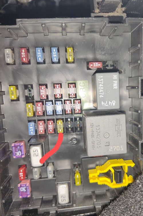

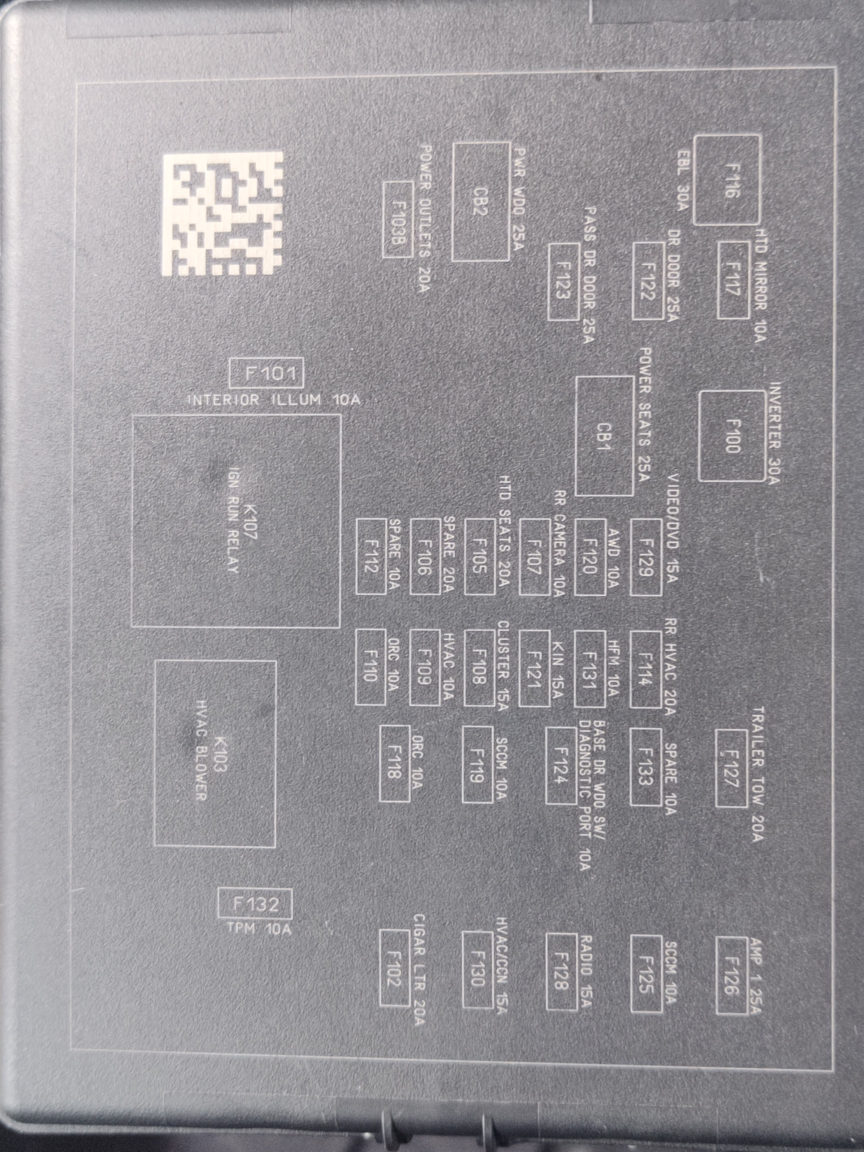

Dean H Posted Monday at 10:20 PM Report Share Posted Monday at 10:20 PM 2016 DJ I marked the power seat 25 A CB and the heated seat fuse. larryl 1 Quote Link to comment Share on other sites More sharing options...
