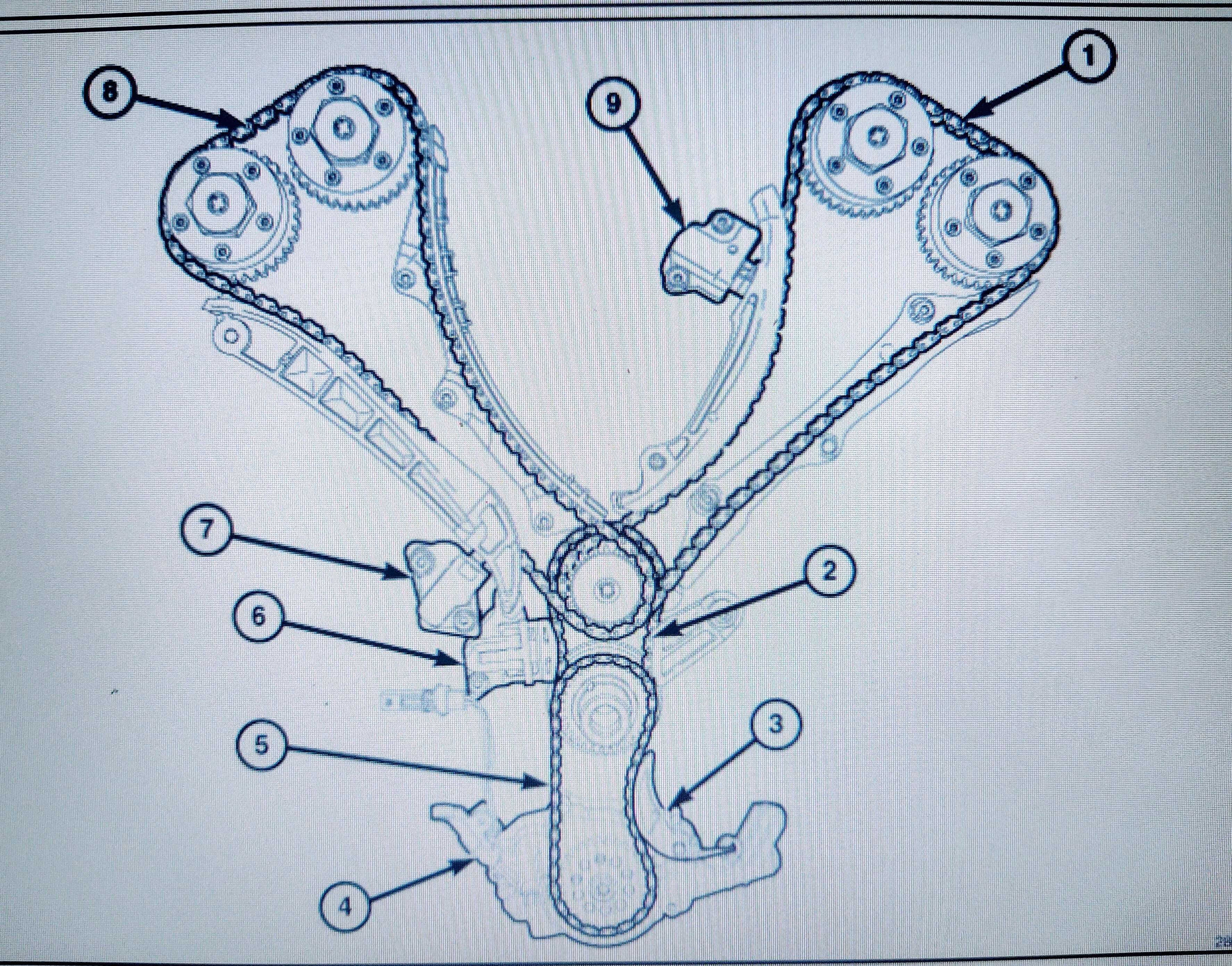

This a view of the complex timing chain on the 3.6.

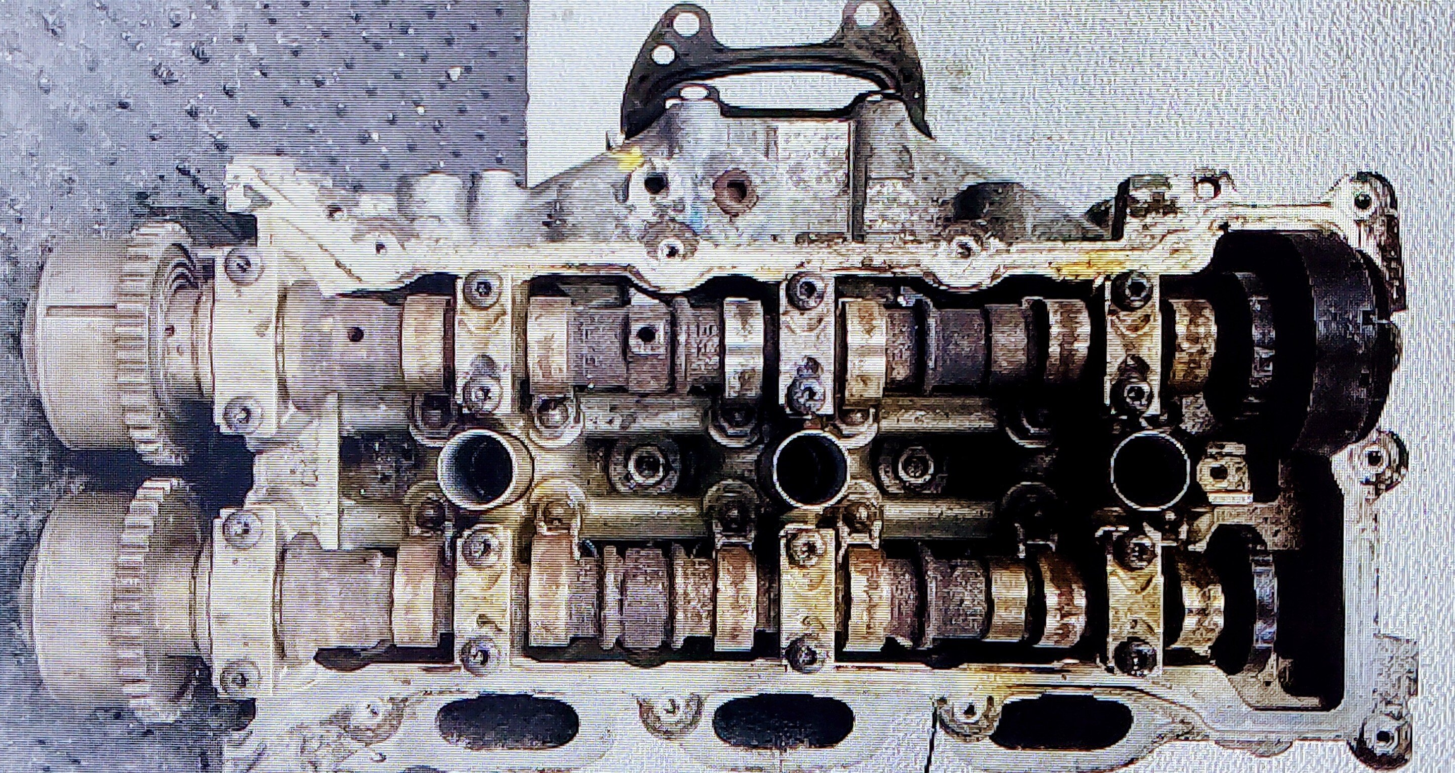

This a cylinder head with the valve cover removed. The 3.6 has 2 cylinder heads.
