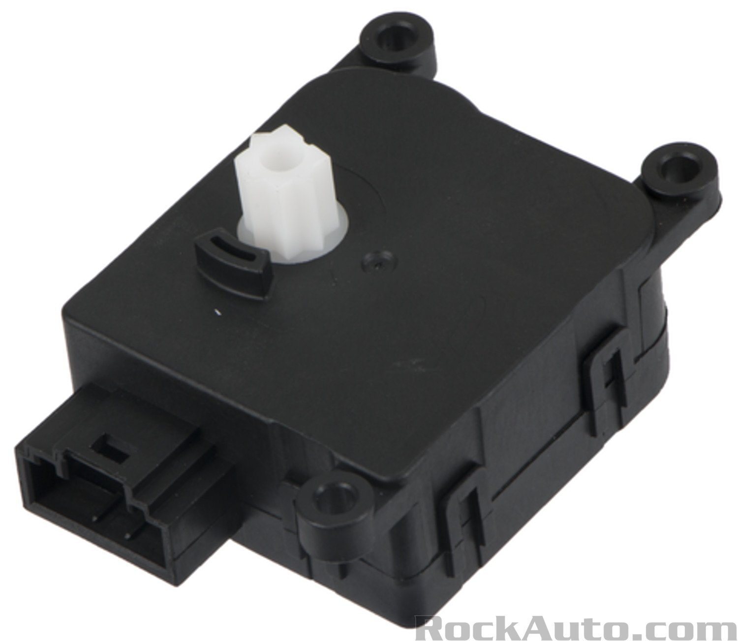

Right side you mean drivers side, correct. If so it sounds like a stepper motor for rear hvac is acting up.
Small little motors used for moving flaps controls inside heating/cooling hvac systems. The plastic gears strip and they can lose track of their position. Need to be changed out to stop noise and keep hvac functioning. Probably two or three in the back, I don’t have rear hvac.  Hopefully Someone with more knowledge answers. Parl looks something like this, undoing plug will stop noise, but actuator door will stay in one position afterwards. Losing some functionality.
